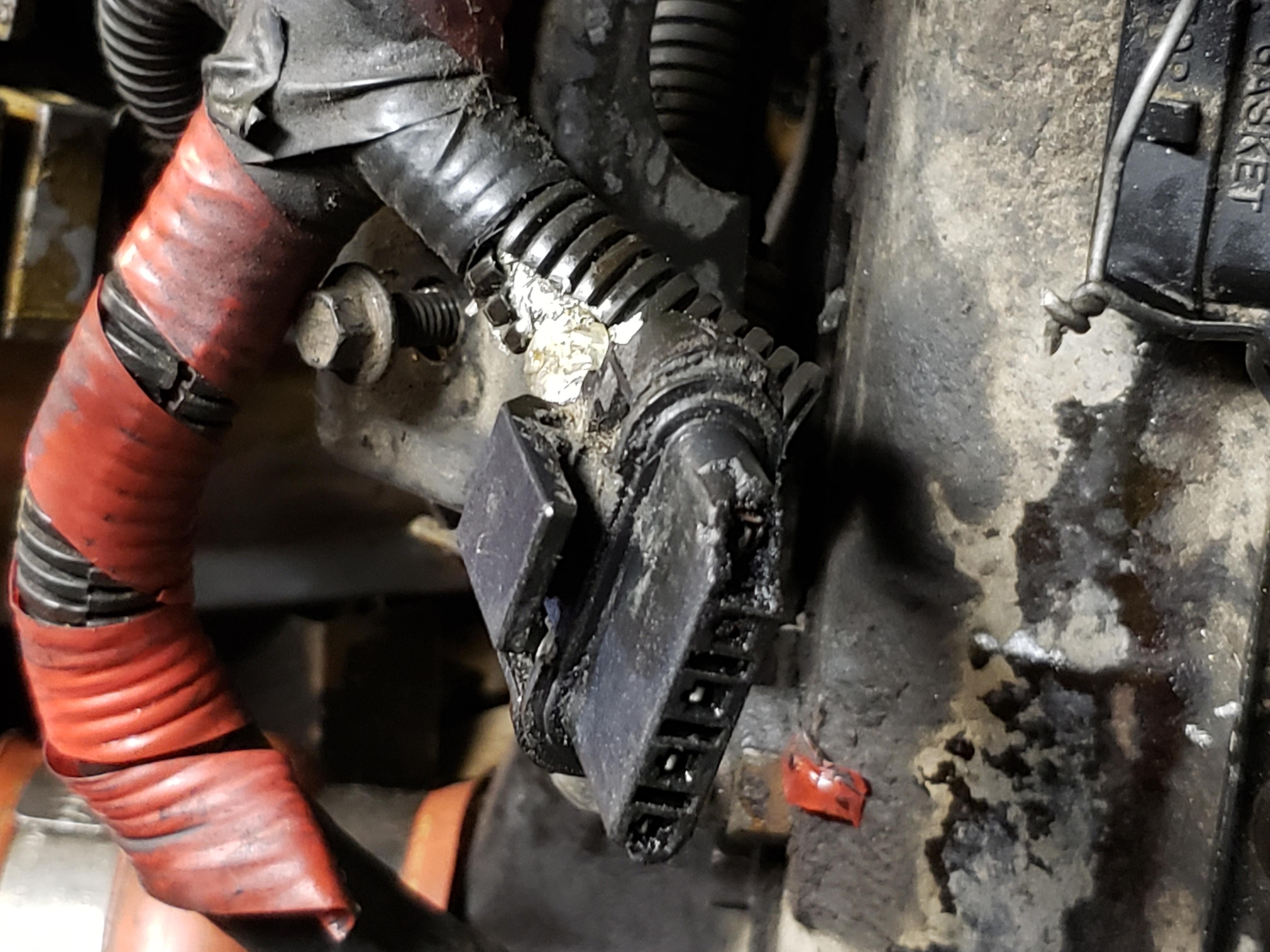

Yeah I figured that LOL. Got my truck back today and so far no more missing (the guy just diagnosed it) and found it was indeed my uvch and put it back together. I think I had a loose connection and when the shop owner put it back together he probably put the harness back together good.

Found the culprit to my problems lol too bad the rest is stuck in the uvch otherwise I could just splice another pigtail on and plug it in LOL.
