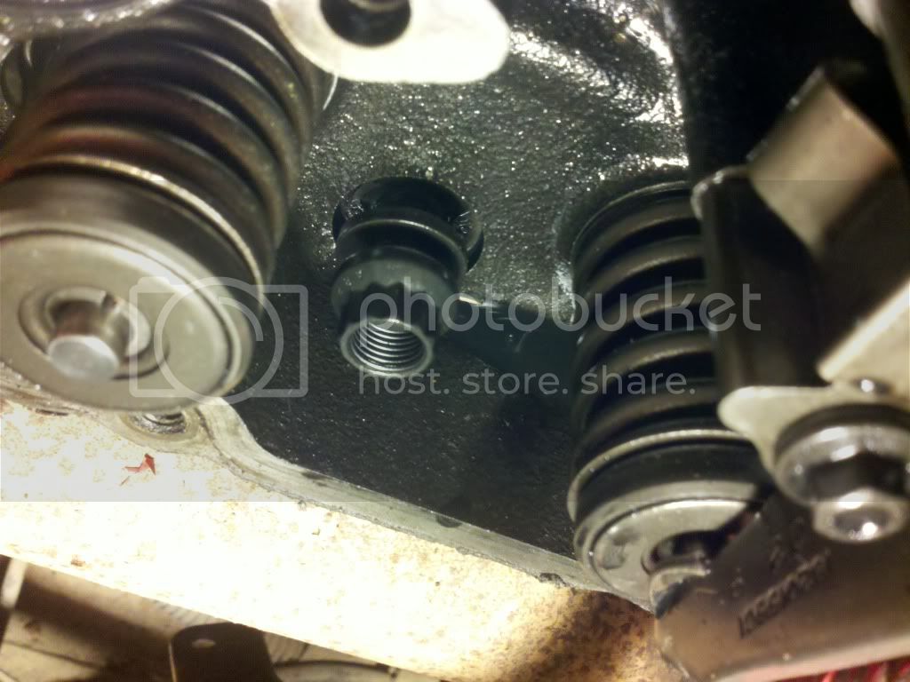

The very first thing I want to point out is this. THERE ARE 2 LENGTHS!! Nowhere will you be told about this. The shorter studs are to be put directly above the injectors. This is so the injector hold downs do not contact the stud. Remember this!!

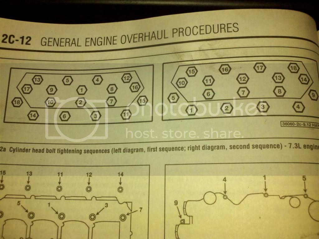

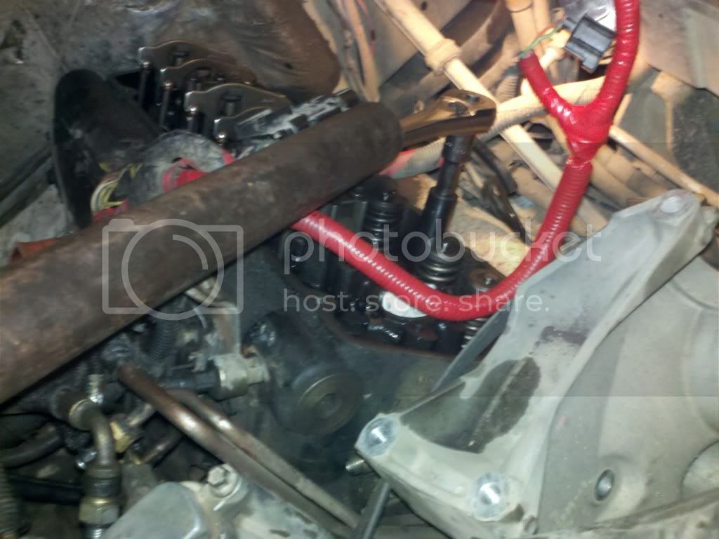

You will want to do this in sequence. One bolt out, one stud in, bolt comes out, stud goes in, etc. Also do it in a couple stages. Go to 90# the first torque until you get all the studs in. Then go back and retorque to 110#. On the third torque go to 125#. Use the torque pattern on the left for the first two torques. Use the pattern on the right for the last torque. Torque the stud to 90# before moving on.

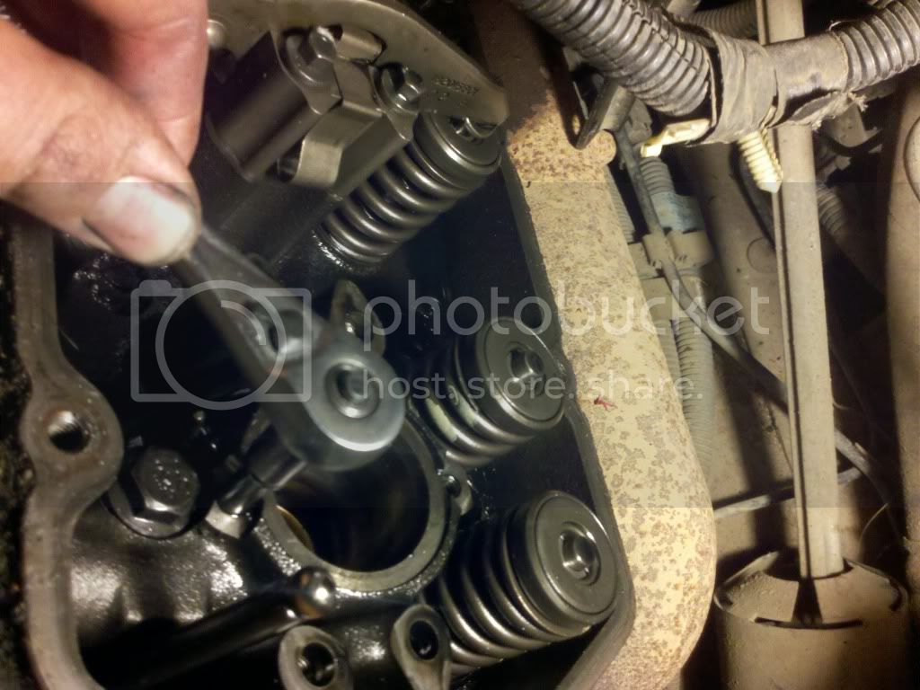

Ok. Now to the bolts. I can't remember the socket size but I think it was a 5/8. You will definitely want to use a craftsman 1/2" drive for this. You may also want to use a cheater. If not, you're more of a man than I!

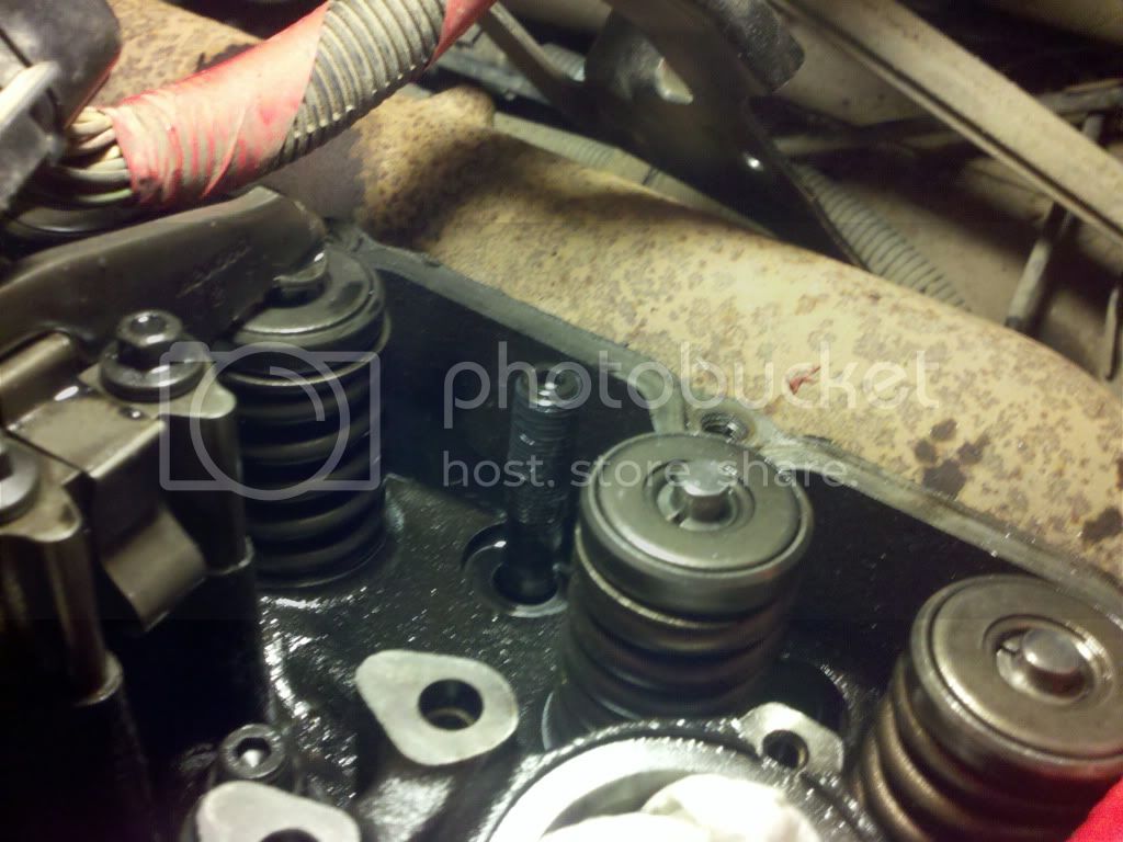

Once broke loose, they will come right out very easily. Pull the bolt.

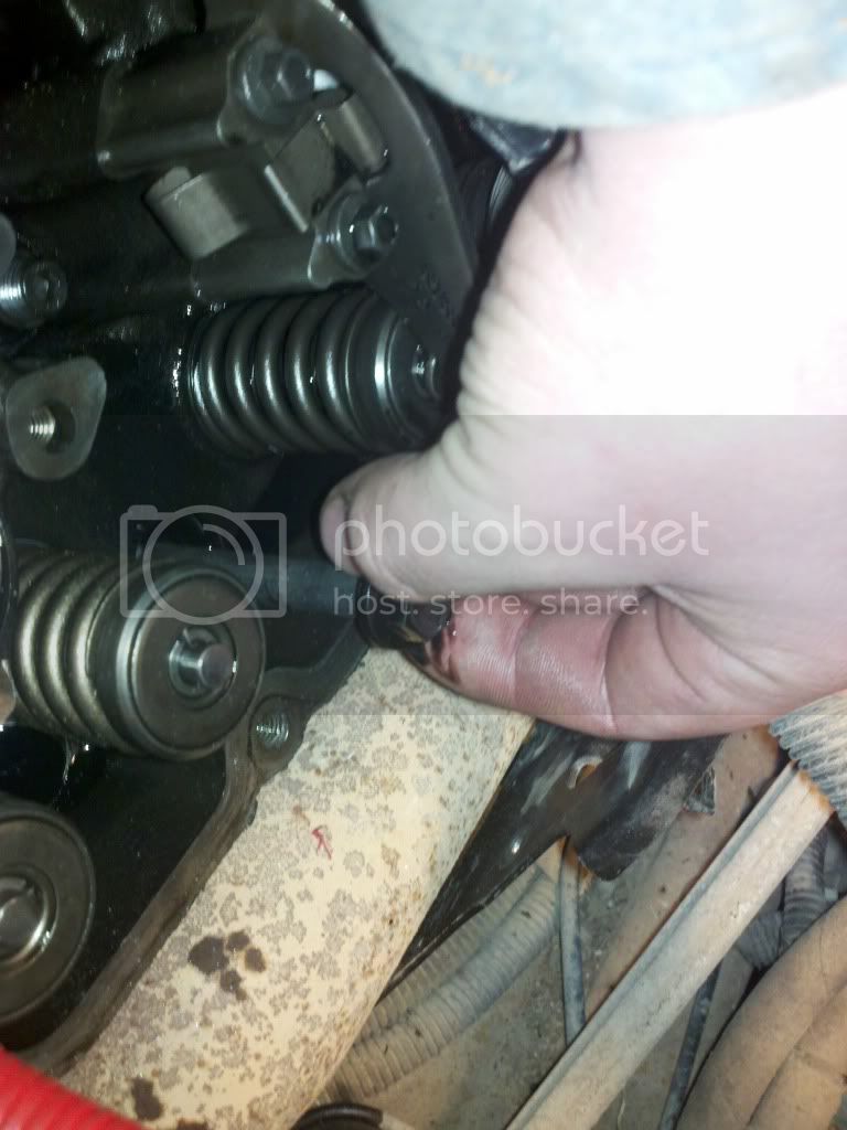

Coat the stud you are putting in with plenty of torque compound on both ends. It is provided when you buy the studs for a reason.

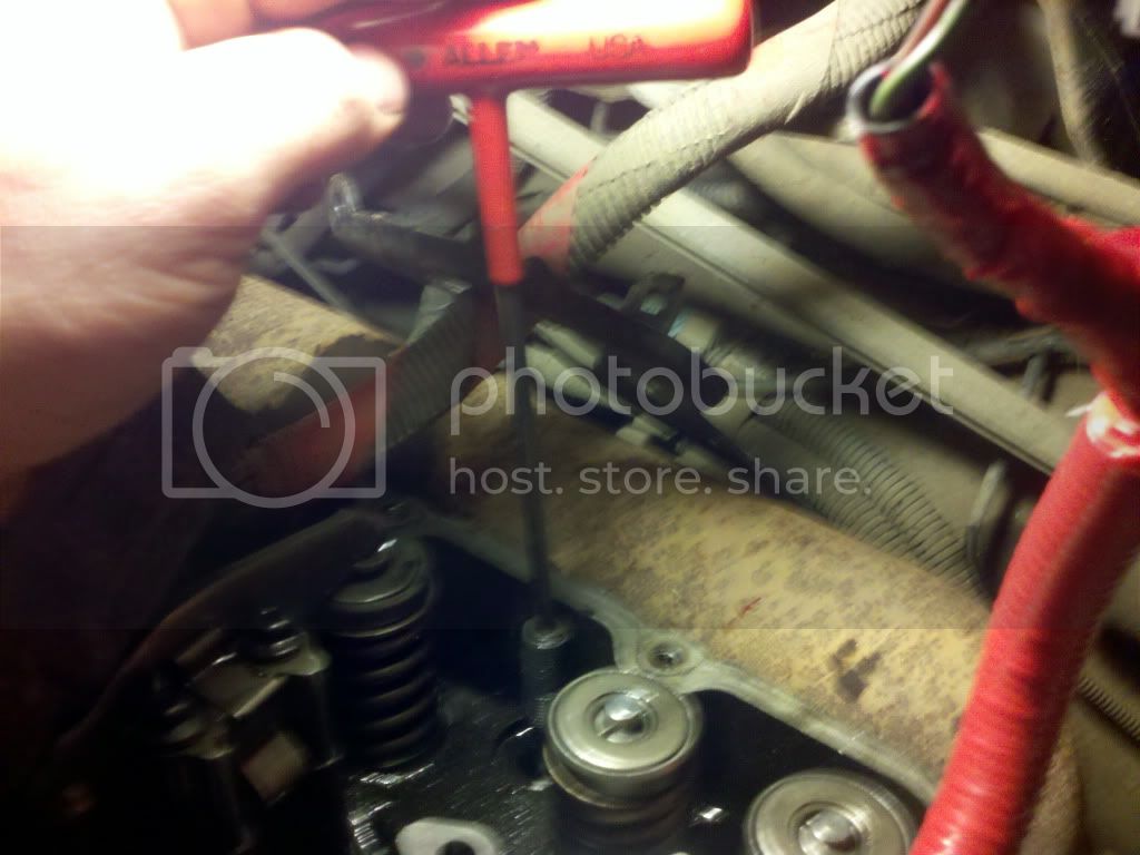

Use an allen wrench to screw the stud in. Just go hand snug.
