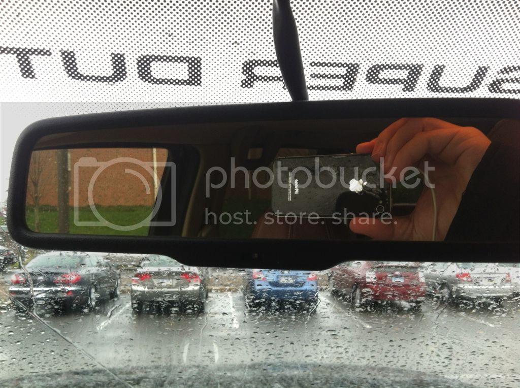

huh weird, i figured since there were wires going to it, it would be auto dimming. its possible that it would have the camera in it, then again, wouldnt one think that it would have auto dimming as well? i might have to run outside to look at mine. want me to grab a picture of the wires and such while im out there?
Dzchey21
11,784
wyoming
Yes please mine has a rather big connector but only three wires. Does the auto dim have anything on the mirror that let's you know it's auto.dim?
Maybe mine just has a dummy plug basically in the mirror

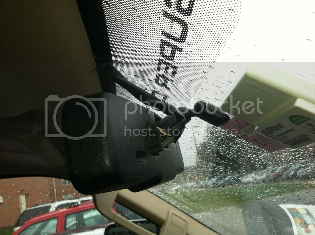

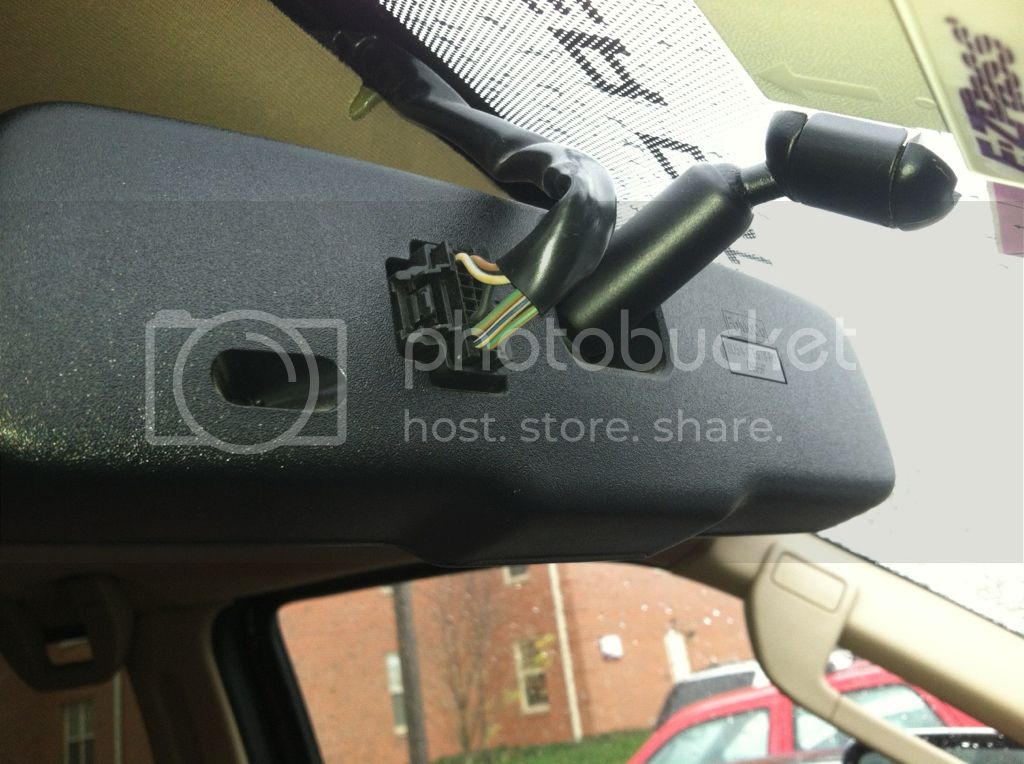

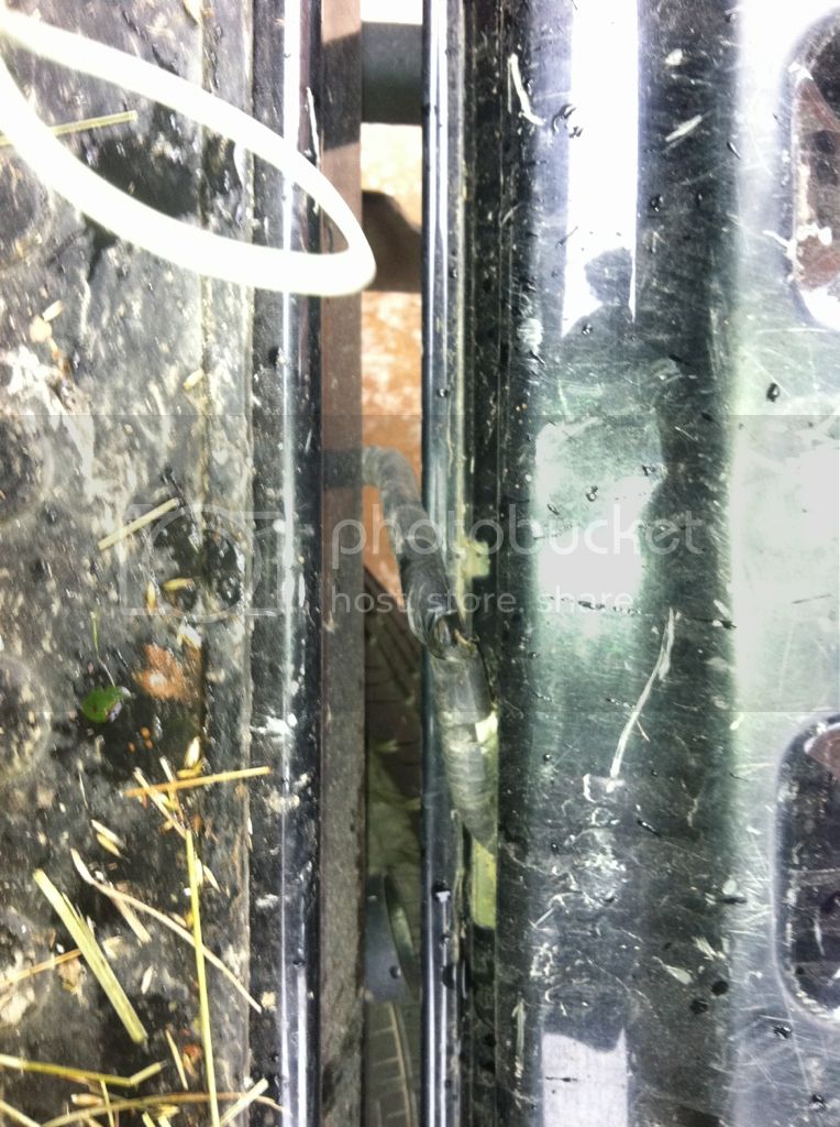

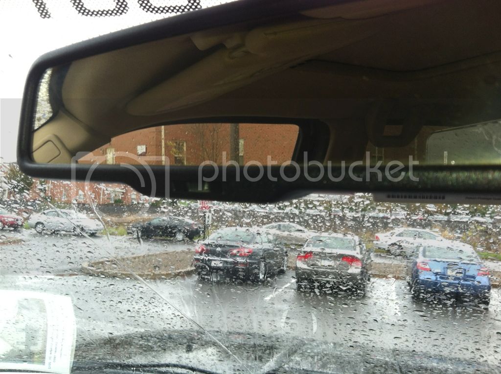

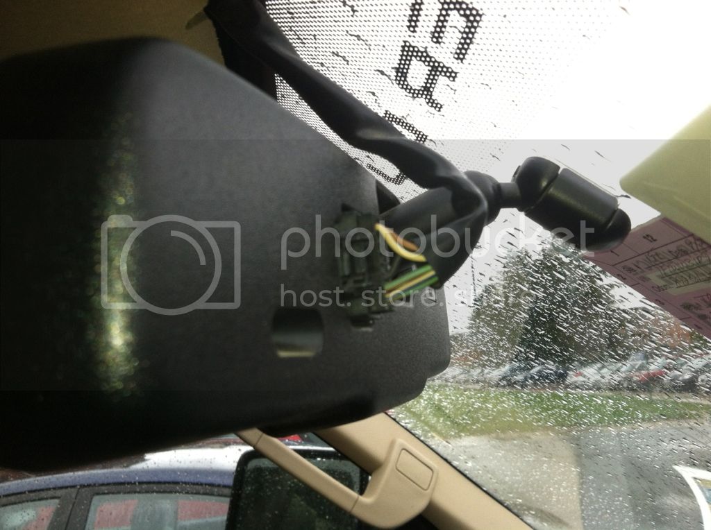

pics as promised.
I'm assuming your mirror has the same connector. but i have three wires. you can also see in the first two pics there is the sensor at the bottom for the auto dimming. i also threw in a pic of the tailgate harness for good measure.

Yours has 2 more wires going into the mirror than mine does, and the mirror is different for the auto dim... wonder WTF mine is wired for? I might see if i can locate a schematic and find out
