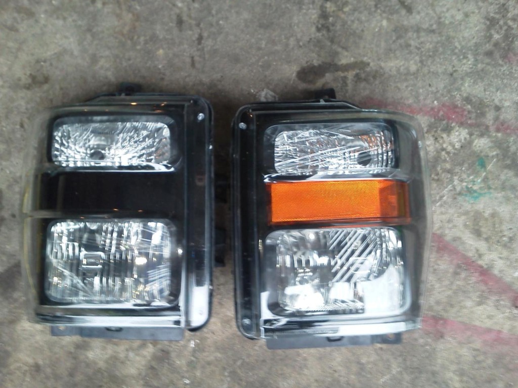

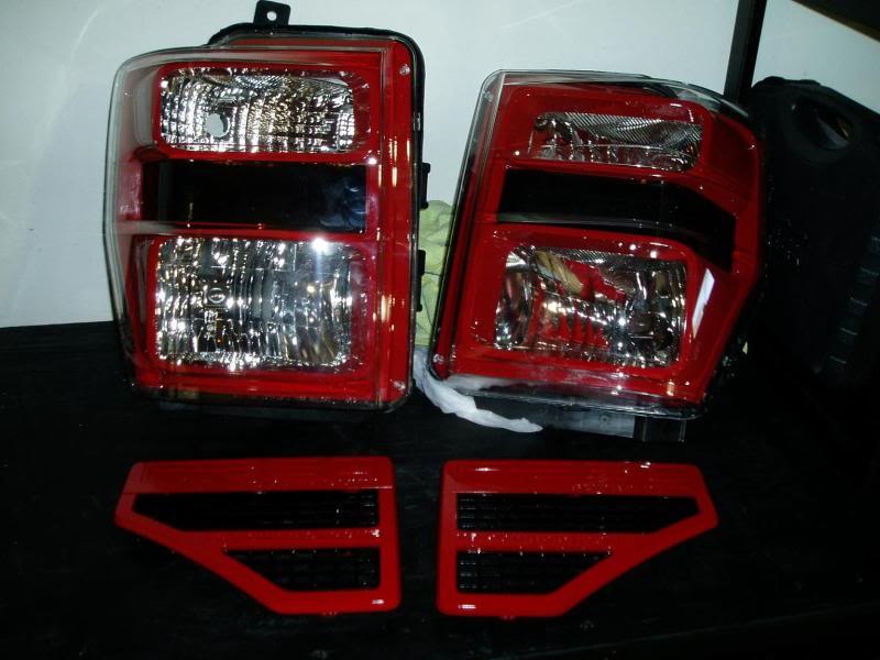

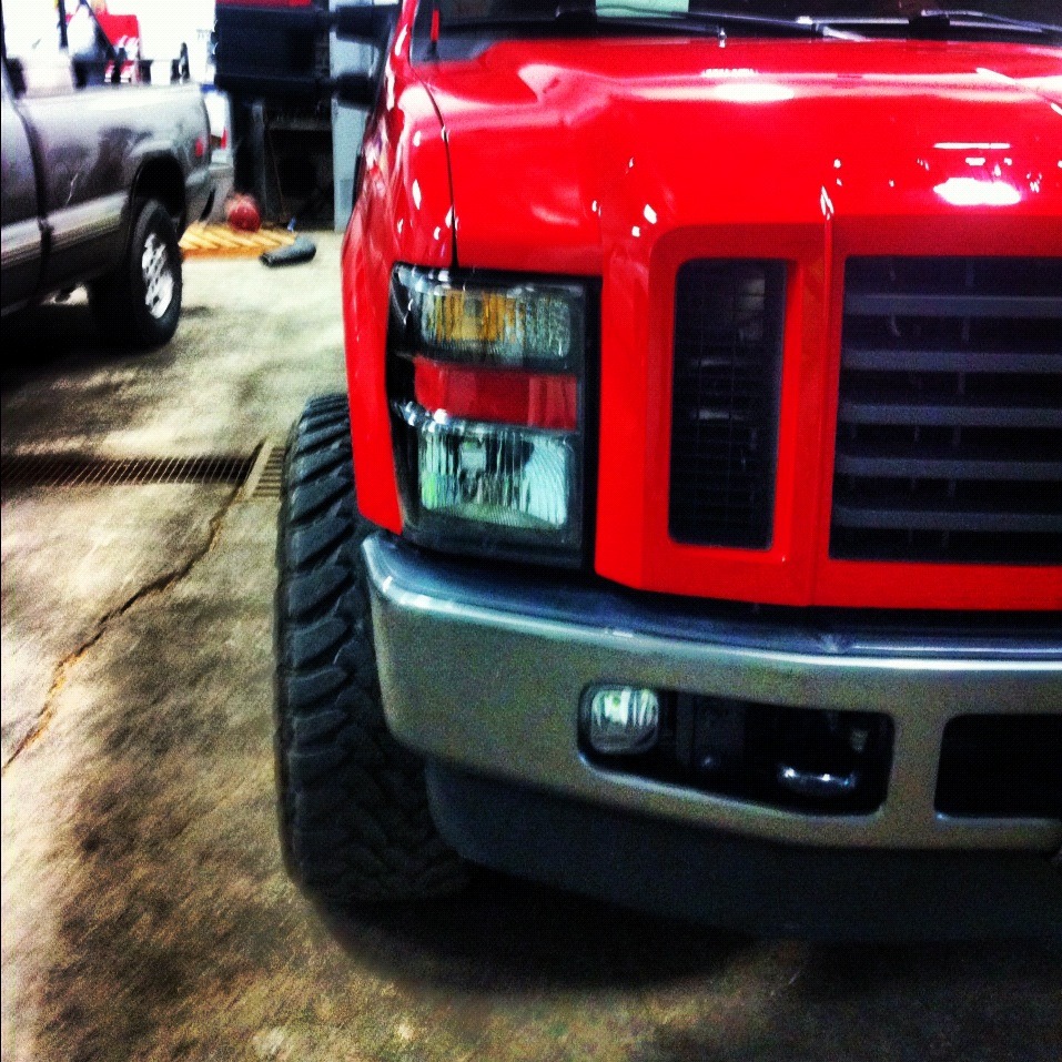

ImageUploadedByTapatalk1340059913.990551.jpgImageUploadedByTapatalk1340059941.602606.jpg
here's mine with orange reflector ImageUploadedByTapatalk1340060027.035957.jpg
here's a set of black reflectors vs orange. ImageUploadedByTapatalk1340060063.994564.jpg
you should be set. LOL oh yea here's red with black reflector.
