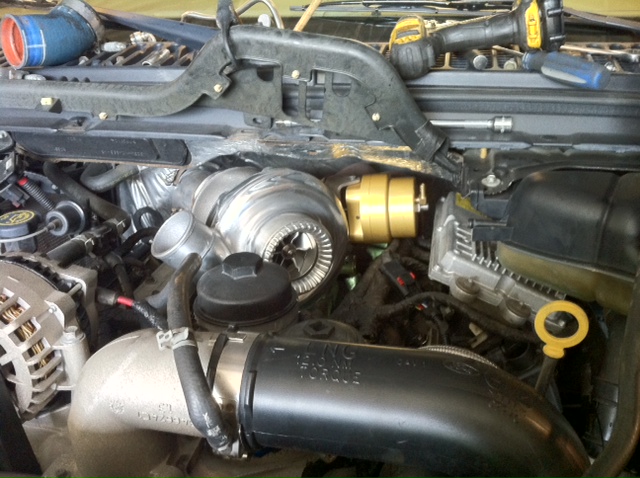

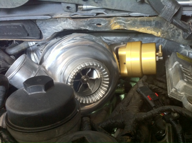

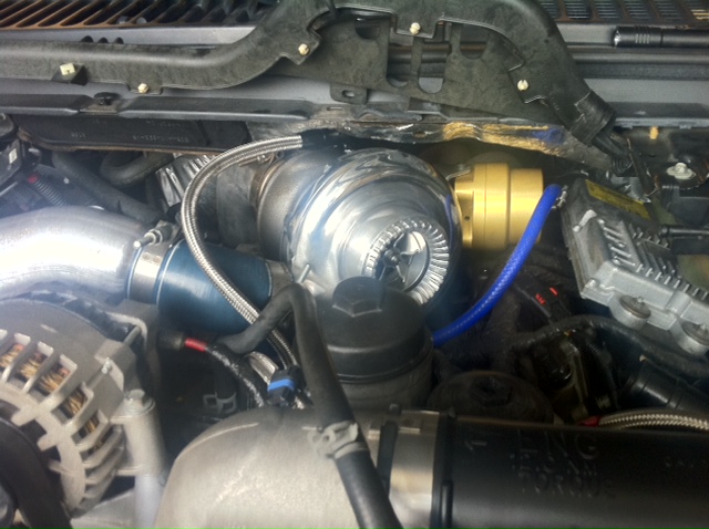

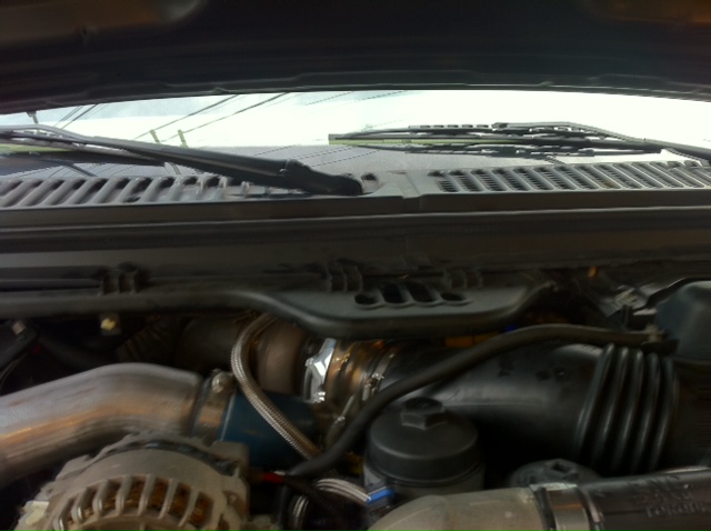

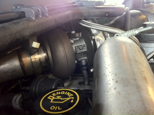

Here some pics and videos of our customers truck we put a bd turbo pesdistal and diverter valve kit on with a 66/71/.76 t3 housing on with batmo race cover
truck still needs a tune for non vgt so spool up will be better after the tunes get here

looks like that last vid is the truck just cruising and it's north of 1000. pretty warm...how big are the injectors?
Craig@MFI
2,184
yes 190cc injectors with standard tune for stock injectors and turbo new tune comes in tonight and will have new videos
BlueWaffle
3,239
Grapevine, TX
really? 66 with 190's? i'm stoked to see how this turns out once it's tuned. I have 190/100's and I'm itchin to step up the turbo but never thought a 66 would be streetable...
strokin6L
2,979
Springville NY
pics look good craig. Can't wait to see how it runs with some new tuning. Does the turbo actually bolt to the BD pedistal? It didn't see anywhere where it was bolted. I think i saw where the diverter valve bolted to the pedistal under the turbine housing.
