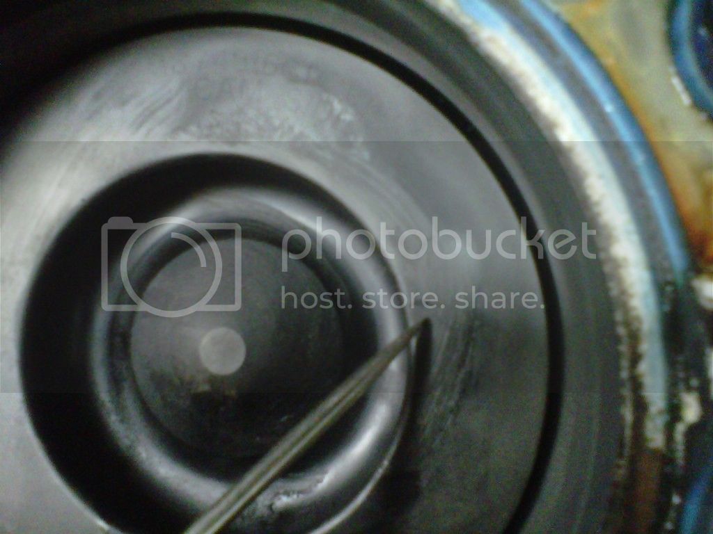

So we lifted the cab on my truck a couple weeks ago with the intentions of doing the following:
-head gaskets
-deck the heads
-egr delete
-down pipe
-cold side pipe
-replace egt sensor
-ported intake (if it makes it in time)
-Dualing batmos (after we dyno)
When Dustin (Dustball) got the valve train out, he found two bent pushrods. Took the heads off and found two cracked pistons.... ***!!! So if the heads are ok :angel: we're going to extend the build list to:
- IH pistons
- RCD valve springs
- pushrods (havnt decided on billets or stockers yet)
- low pressure fuel system
Just wanting some opinions, only planning on a 71mm and 30% nozzles someday, no bigger.

What he doesn't know is that I took and air chisel to said pistons to create said cracks :D
Just a couple baby cracks.
