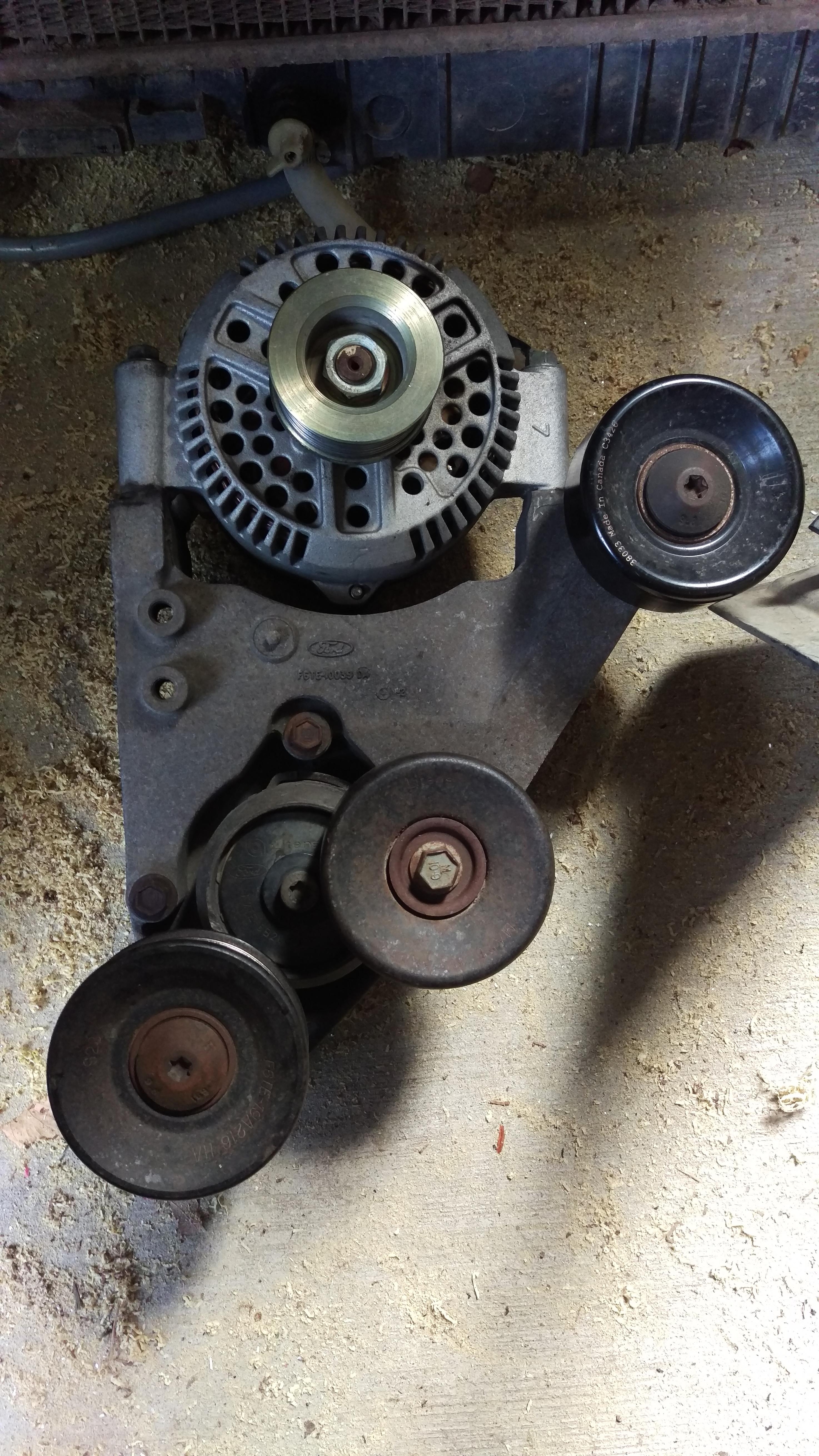

I pulled my 7.3 for what hopefully will be a quick reseal? I would like to replace the belt tensioner. I can't find a replacement that looks like mine? Was the original tensioner a single idler unit? Would a Motorcraft BT-50 fit?

That is a dual Super Duty tensioner.
It is a lot better than the stock one. Someone along the line of the life of your truck put the dual one on and threw the single one into the trash.
