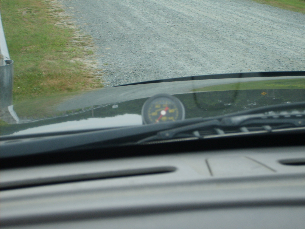

do not put a mechanical gauge in the cab....if the hose lets loose or the gauge craps out you will have the smell of diesel in the cab for a very long time... use an electric gauge if you can swing the price... if not ..mount the mechanical gauge out on the cowl.. I did mine with a piece of 1-1/2" PVC for permanent use..but you can run a hose out to the cowl and tie the gauge down to the wiper just for testing...
