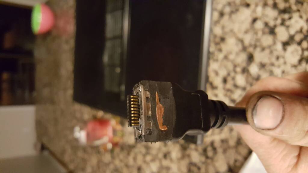

Graveyarder
Feb 12, 2013
16
Well, made some progress today. Plug turns out to be a variant of the dfp20 male plug. Just trimmed the outer shell off and she fit tight into the unit. Just have to wire the convert over to hdmi now.20161105_201341.jpg20161105_201404.jpg20161105_201411.jpg

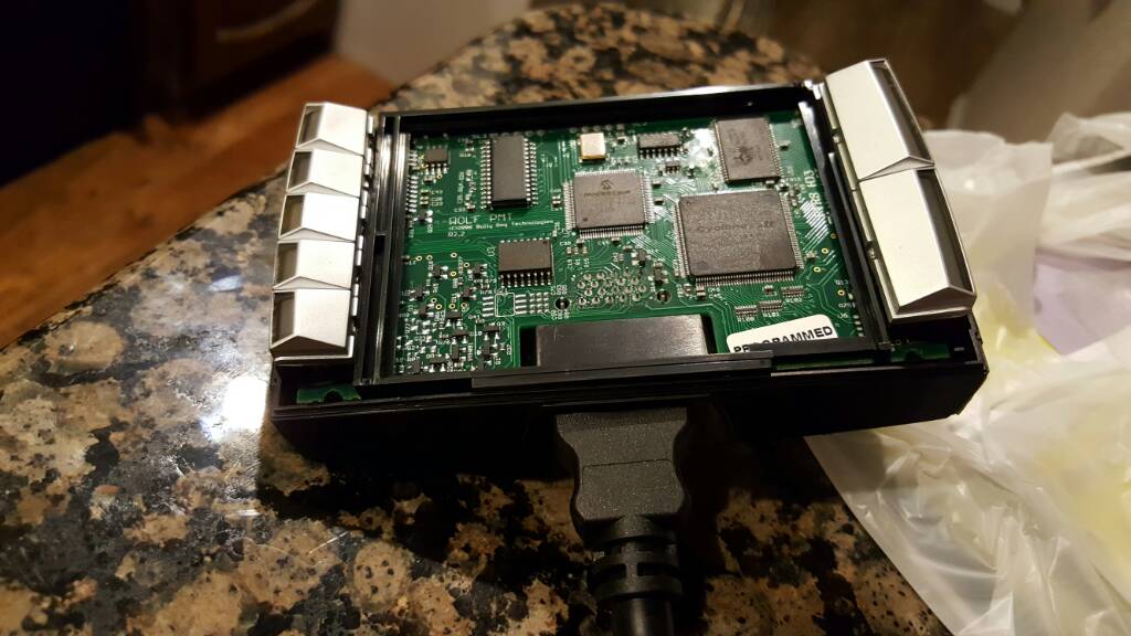

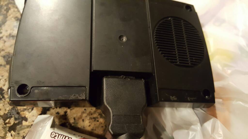

Graveyarder
Feb 12, 2013
16
Got the positive and ground wires pinned out. Now should just need the can-bus wires and we should be in business.
Graveyarder
Feb 12, 2013
16
4 screws on back and carefully peel top and bottom cover off. Careful it is very thin metal. Held on by 2 sided tape
