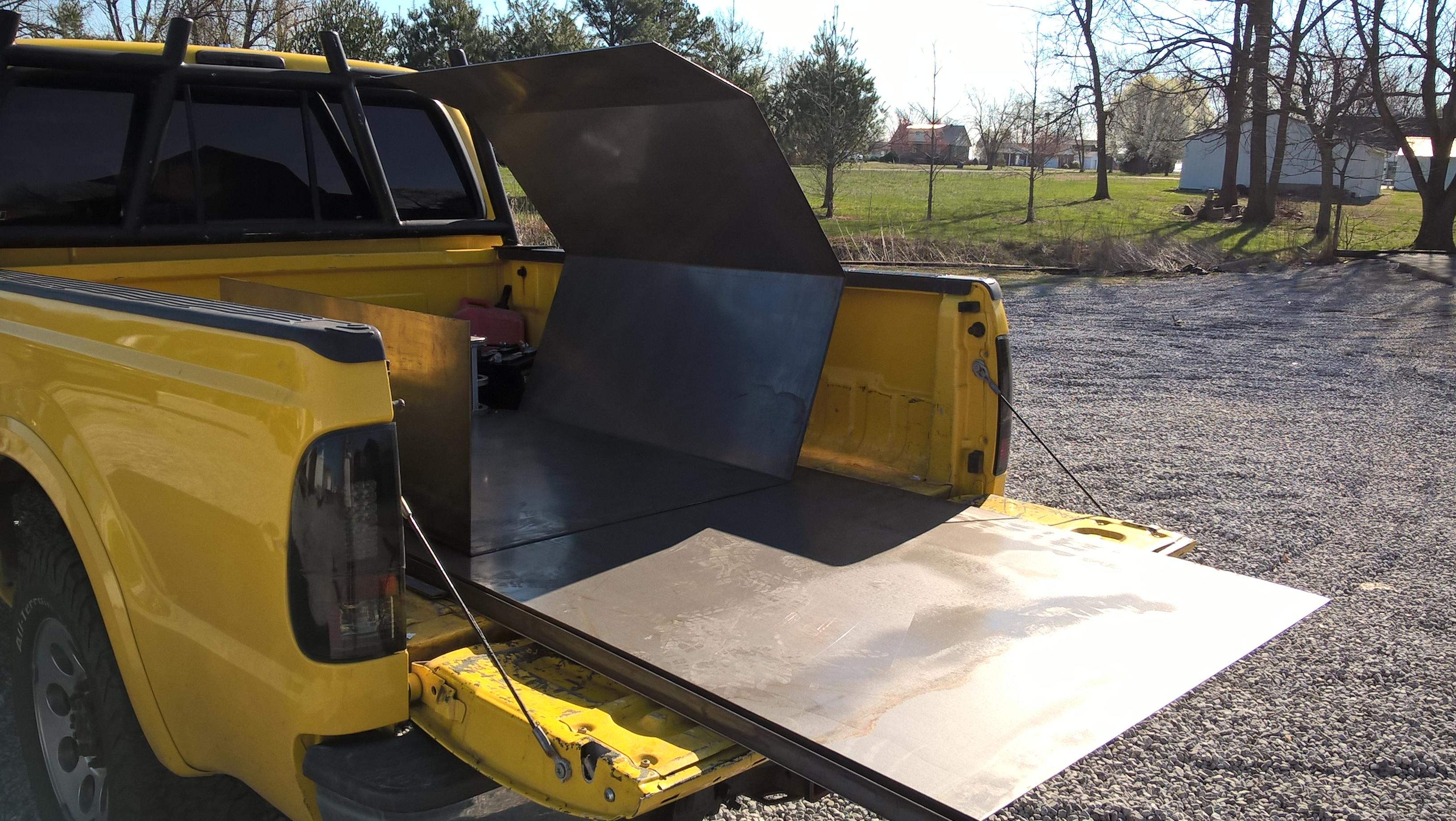

The dimensions are 48" wide, 36" tall, 36" deep. This was what I picked up from the black smith. My break is only 22" wide so I let them do the bending for me. The bent piece is a 4'x9' piece of 10 gauge and the sheet under neither is a 4'x8'.

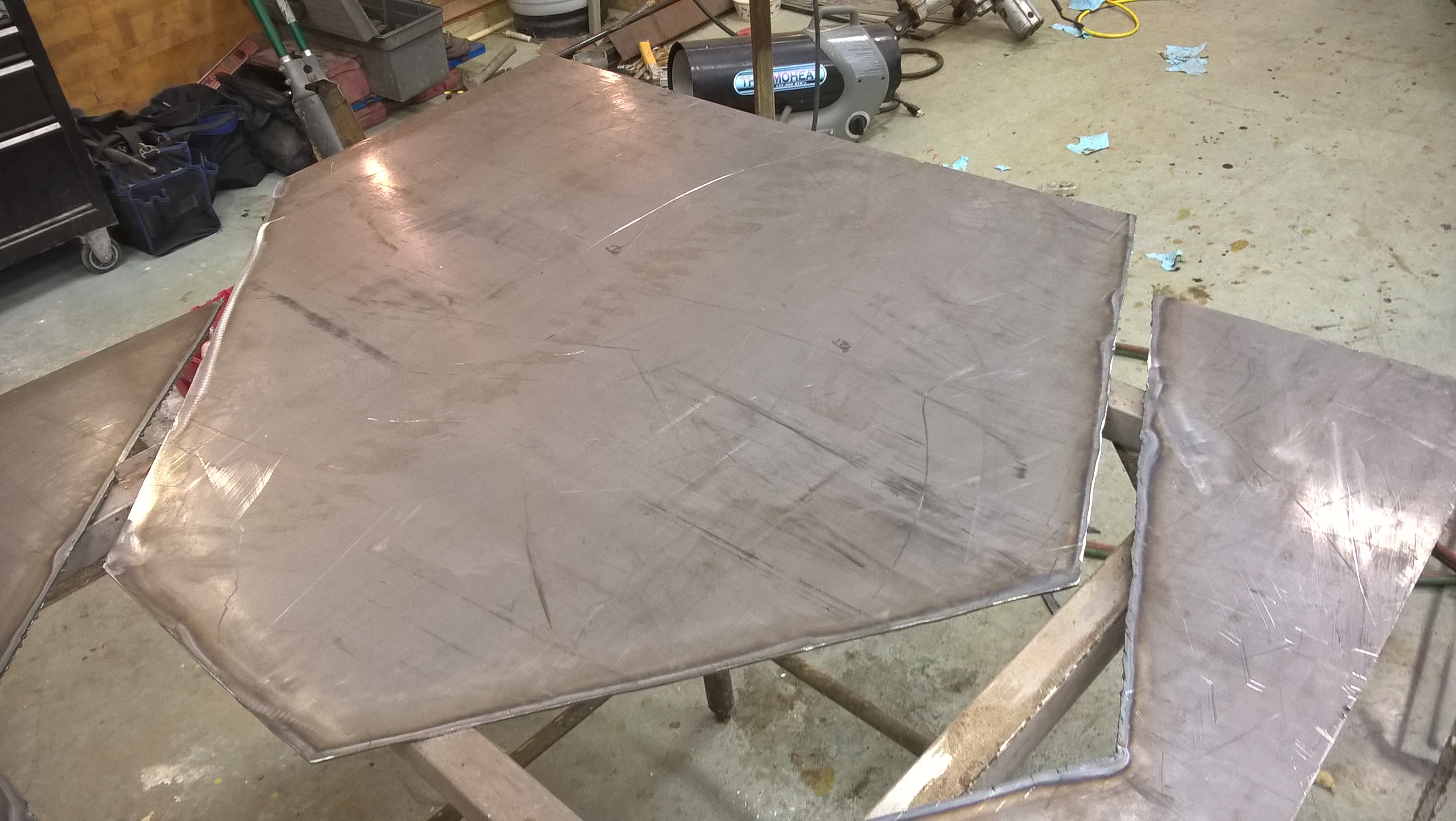

Still rocking a big vic oxy acetylene torch. Been looking at a hypertherm powermax 45 for over a month, but miller is offering a pretty good rebate on a miller 211 and a 625 extreme. Anyway, end caps cut and welded.

Both end caps welded. Had to he man it with a pipe wrench because the bends weren't exactly correct.
Btw, forgive the mess. My shop was going through a reconstruction. Then I bought a truck bed load of tools that haven't been sorted yet.

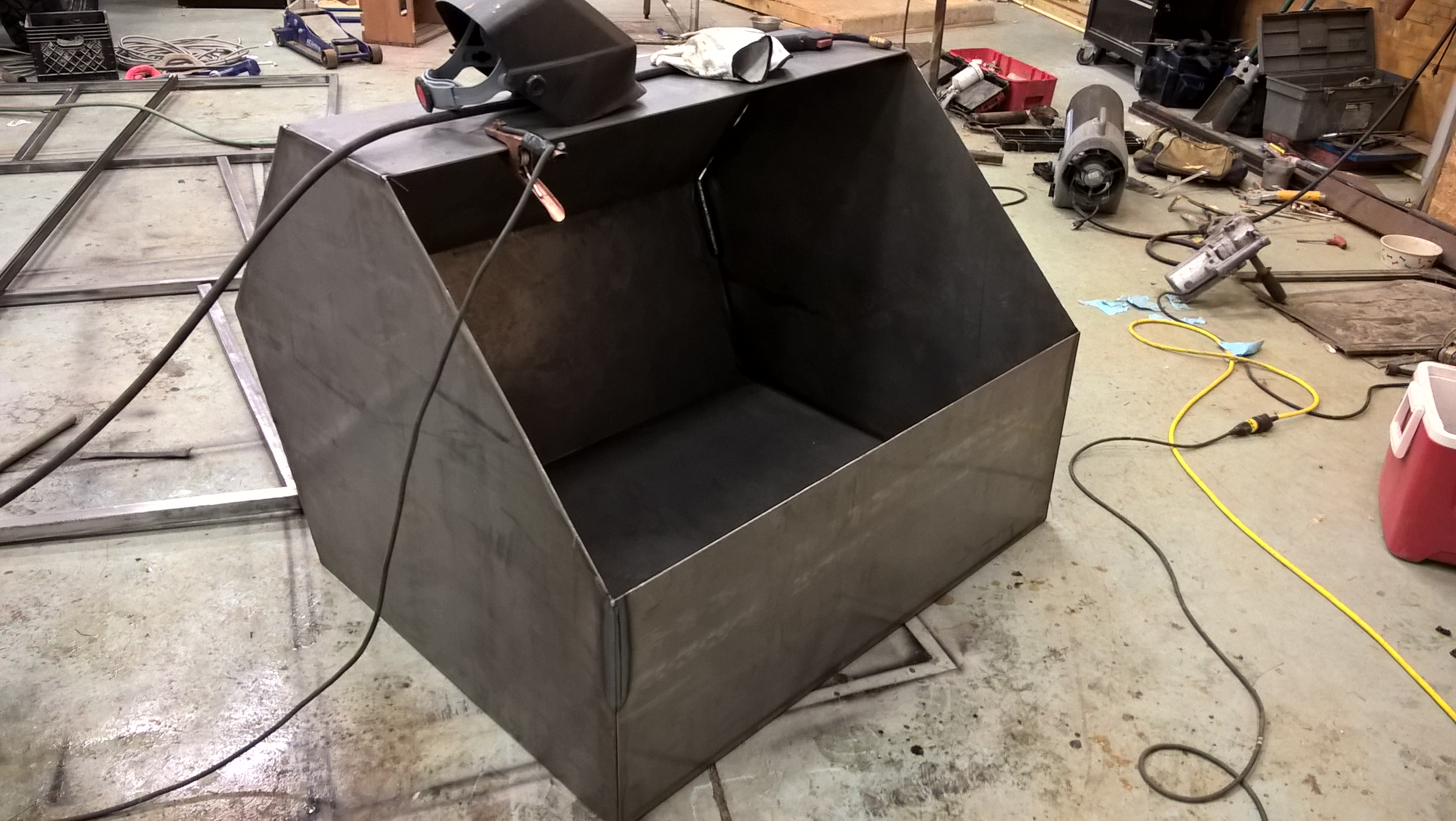

The box of the cabinet is completely welded. Two triangle pieces were cut for the bottom to funnel all of the used media to the center where a ball valve will be located that will reload the pressure pot, as well as the pick up for the siphon gun.

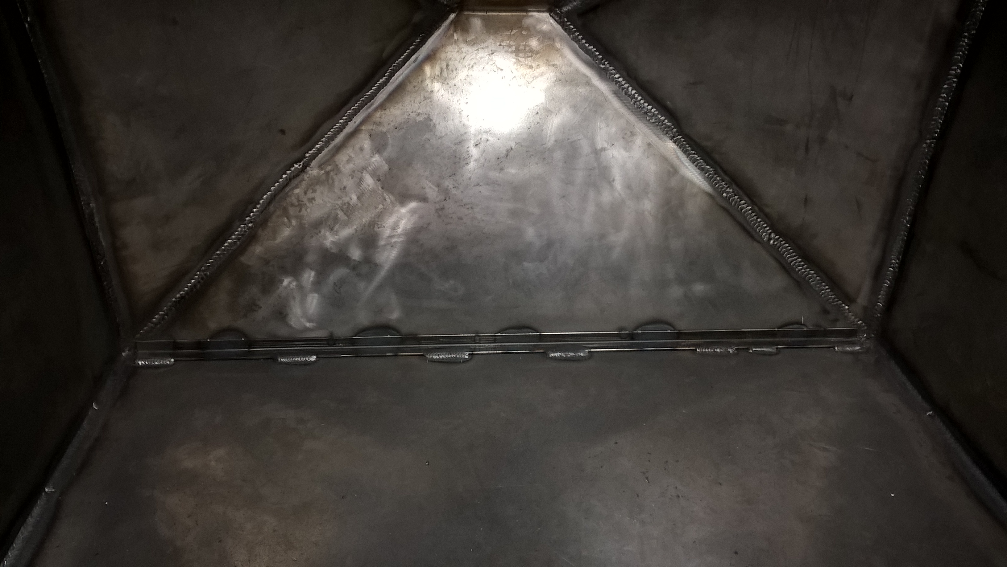

Two small pieces of angle welded to the front and back to hold the floor grate in place. Hoping to pick the material for that up this saturday.

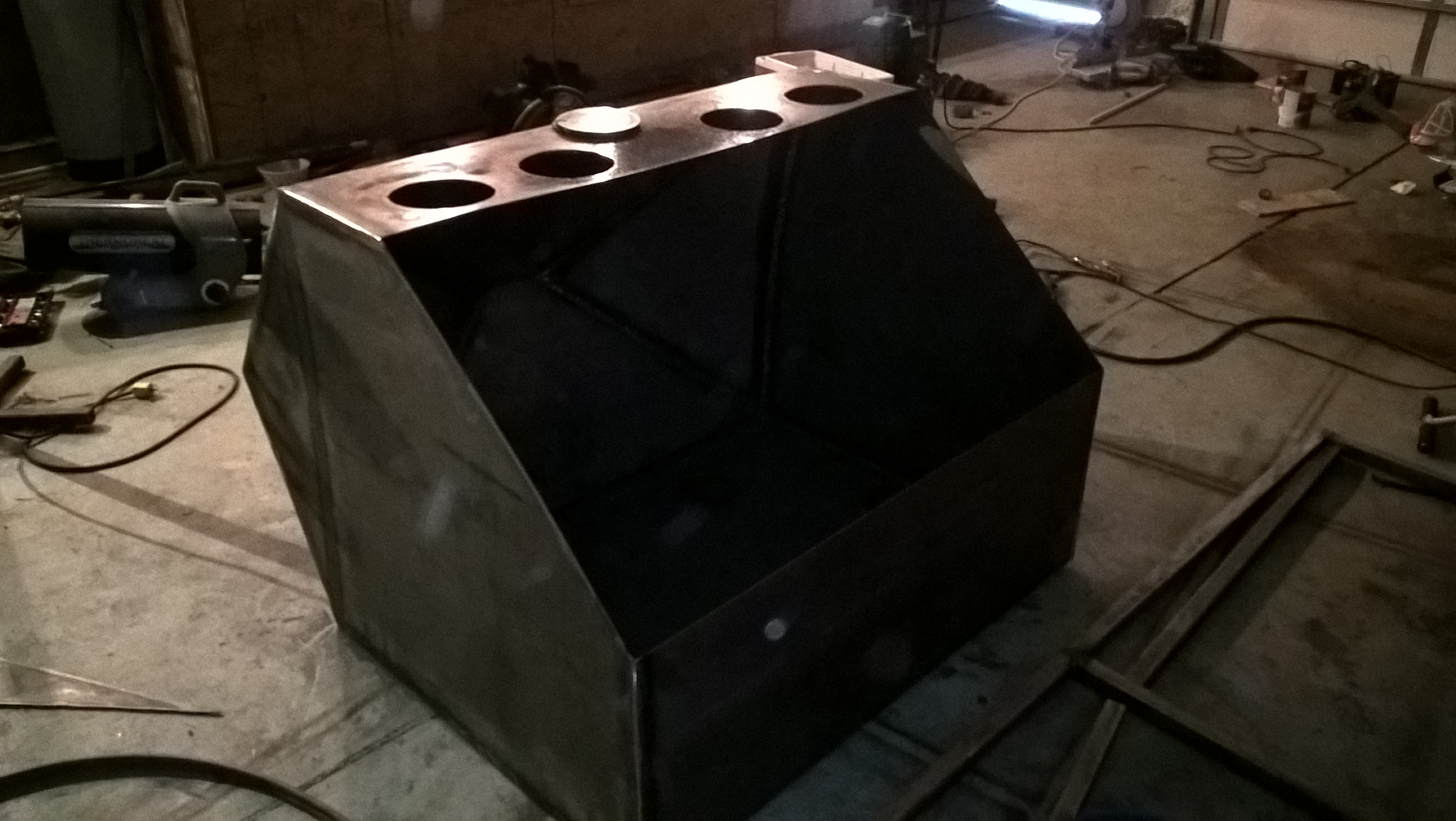

I hit a snag. I was going to use 5" exhaust pipe I had laying around to use for the section the gloves will hold the gloves. It turns out I'm to big and a 6" id pipe will be needed. I planned on using these metal cans and tig welding them in place, but I've decided to run to the blacksmith and see if the have some tubing the right size that's little heavier. If not ill just order some 6" exhaust pipe. I don't want to begin building the font and side doors untill I have these pieces welded, so Ill start on the pressure pot if I can't cone up with anything today.

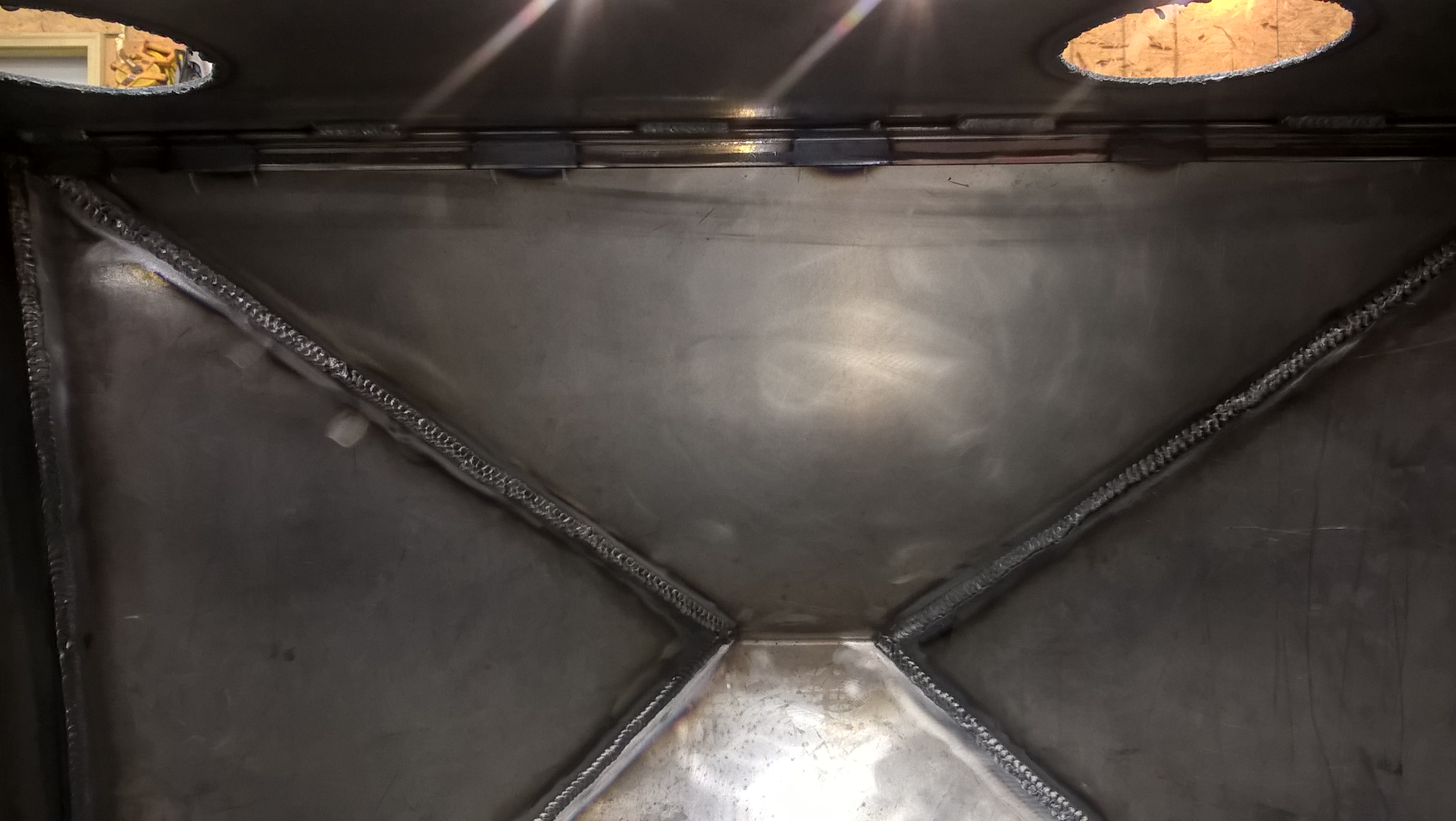

All 4 holes cut. The gloves will be left,left,right, right. I set in the position that felt comfortable with the gloves on and had my wife measure the distance between my arms. It came out to 18" center the center for the two inside gloves.
