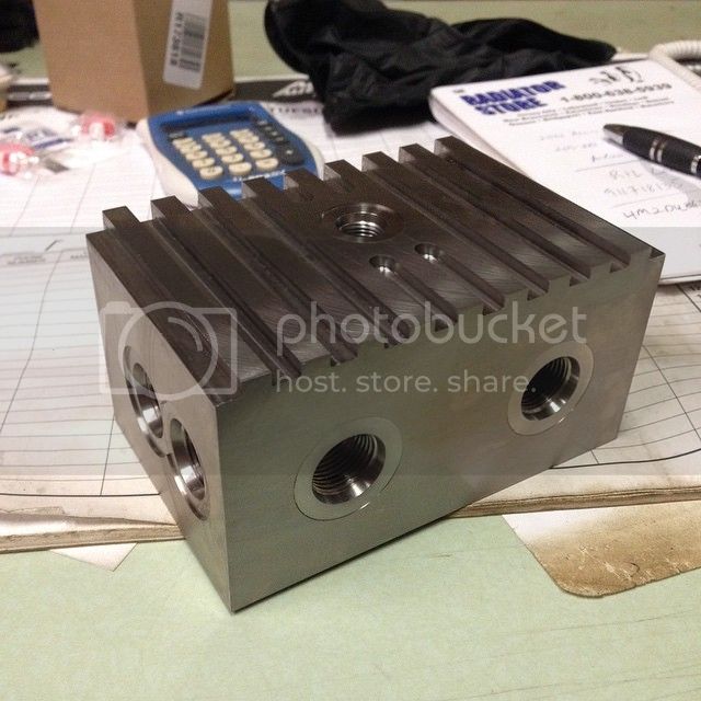

Yep that is the one I was thinking of. HTR has something that looks very much the same it just does not have the final mounting cuts in it.

I would think they can't be that hard to make. I have made adapters for Dynisco transducers that operate at 6 to 8,000 psi leak free. We used these to get Reynolds numbers on polymers that we were evaluating on our extruder. The transfer lines were operating upwards of 350 degrees centigrade too and they held just fine. I would take a stab at it if someone could provide a drawing.

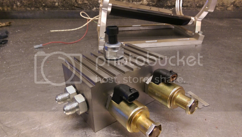

Mine that i made. Had a few people ask for one just haven't had the time.
