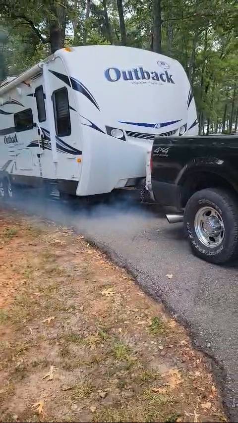

Blue-ish white smoke when at operating temp

Have you checked the downpipe coming off the turbo for oil? Mine did that when the turbo started pushing oil out of the turbine seal.
Lord I despise the thought of pulling it lol. I have not checked that, I guess I have hopes of if it was only doing this when warm, and because the Turbo is fairly new that it was the least likely.
Sent from my SM-S908U using Tapatalk
When mine did it I could see it dripping off of the V-band clamp. Mine was a GTP38R that was only a few months old...
This is a KC (stage 1 drop in) I certainly hope the build quality is better. We also had a 38R that locked up, only a couple years old, and very low mileage, then read they had a run of bad ones. Bought the KC for rebuildable, got lucky that it also performs substantially better too, especially towing. But I'll look into it once I can have more time with the truck again.
