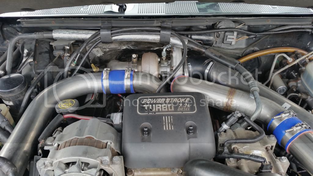

I have this Dieselsite Boost Fooler installed. The blue/silver fitting is for my boost gauge. The brass/pop-off valve is suppose to "open" when boost reaches a pre-set pressure. The black hose goes to the spyder. My question is.....would the pop-off valve limit boost in the entire system? I only could make 25 lbs boost. I moved the boost gauge tubing right to the spyder and it didn't change my boost reading (not pictured).
I know there is an air regulator type boost fooler out there. Anyone know the part number for it?
Thanks

Check the tube going to the gauge for cracks or brittleness. I was boosting low and found a lengthwise split in the 1/8th hose going through my firewall. I'm running the Dieselsite BRV and hit 42+ easily. My MAP agrees with the boost gauge 'til 22psi, then the BRV opens.

You will not limit boost in the entire system by that little pop-off valve. It would take a larger sized dump gate to do that.
Your pop-off should dump pressure off that little line going to the MAP and that's about it, doing what it's intended to do.
But I have to ask why? I ran over 60 psi on my truck with no boost limiter and it never de-fueled. OBS trucks don't need the fooler like the SD maps do.

Wrong,
The obs trucks need a fooler too. Mine defueled and bucked violently under wot till i put a regulator in map line.
Billy i would go the regulator route over that deal you got goin on.

Hmmmmm...you got me thinking.
When I stomp on the throttle from a dead stop, the truck starts bucking violently. If I ease into the throttle, it doesn't buck. Wierd
I set my shop's air compressor regulator to 25 lbs and hooked it up to my boost gauge tubing .....the boost gauge showed 10 lbs. I flexed the gauge within the pod and it jumped to 15 lbs. I have to investigate it further as I had to go to work. Either it's a kinked/broken tube or bad gauge.
I ordered a 25lb pre-set regulator from McMaster, similiar to the Riff-Raff one.
Truck feels to strong to be only making 25 lbs of boost. Something is going on.

Pssst......your valve IS a leak. When your valve senses whatever pressure it's set for, it dumps the excess pressure to the atmosphere.....leak. I never said I had a boost leak. I've been in this game a long time to know I have a boost leak. All I posted was a question about the valve. How things get twisted.
UPDATE:
And Swaan was correct :thumbup::thumbup::thumbup:, it was my boost gauge. The needle was sticky. Comfirmed with my air compressor. Set the air pressure to 30 psi and hooked it up to the tubing in the engine compartment. Gauge would stop at 20 lbs. I tapped on the gauge and it jumped to 25 then tapped again it went to 30. The needle would stick at slow pressure rise. If I opened the valve, the pressure, the needle went right up. I removed the gauge to verify it's not the tubing and duplicated the issue on the bench. Needless to say, the gauge is on its way to Autometer.

I hope you didn't think I was implying ours isn't a "leak".... was just reaffirming that it couldn't be causing your particular issue based on design in response to some of the other posts in thread (not you in particular). Glad you were able to figure it out so fast though! And hopefully one you can get warrantied.
