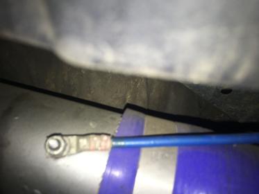

Here’s the tether I’ve got going.. pic not the greatest but you get the idea. Seen 50+ and no issues

Yeah that is a good idea. I've been poking around the hardware isles trying to come up with something along those lines. I'm thinking for the Y I'll fab a bracket similar to what comes with the afe bladerunner thing. Either way, looks like I'll have to dust off the tig to put something on the tubes.
