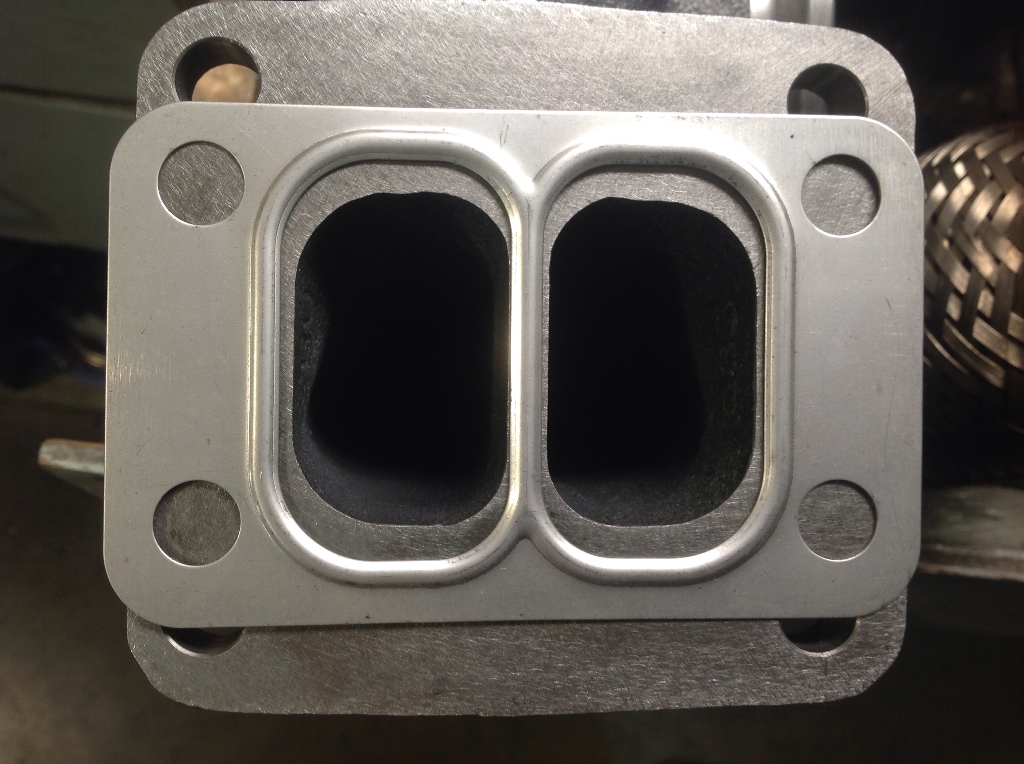

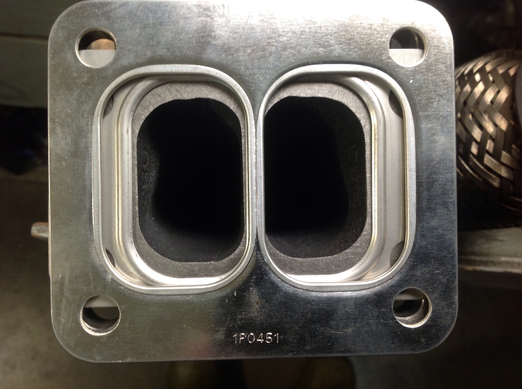

Here is a comparision of a tall port T3 gasket, and a T4 gasket.
This is a tall port T3 inlet gasket:
This is a T4 gasket on top of the T3:
Just so you know, there are some very small port T4 turbine housings out there.
