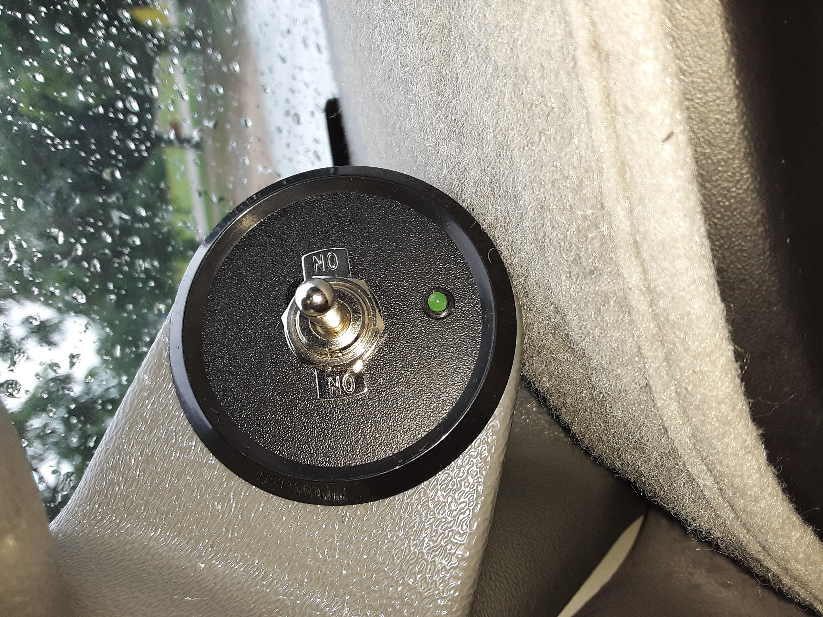

Yap there worth the money. I have two of them one on each obs . Saving for one to go on my superduty. I am a probley a little over complicated on my wiring for them as I have the secondary pump wired to activate by a boost gauge which can turn it on and off . Or I can on manually with a switch or off .

I will use the same gauge and switch setup in my superduty with the gauge and switch mounted on a column pod mount.
