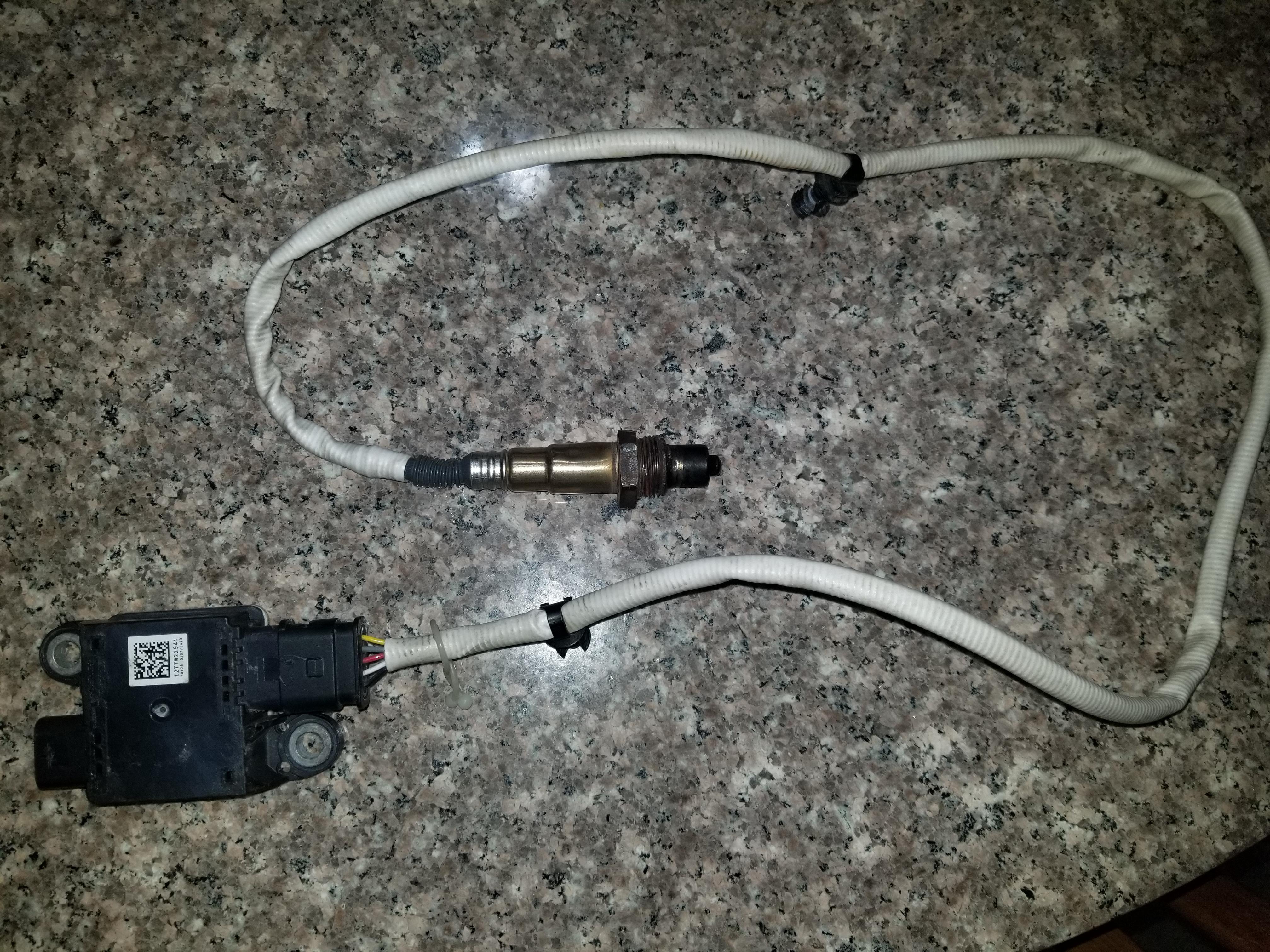

I damaged the 02 sensor in the rear tailpipe and need a replacement, I cant find a part number on it anywhere that works. If anyone knows that part number I would really appreciate it.

It's this I guess its not actually a o2 sensor

Thats a nox sensor and module. Base part number shpuld be a 5k202. Check with sunrise on here for a replacement maybe?
