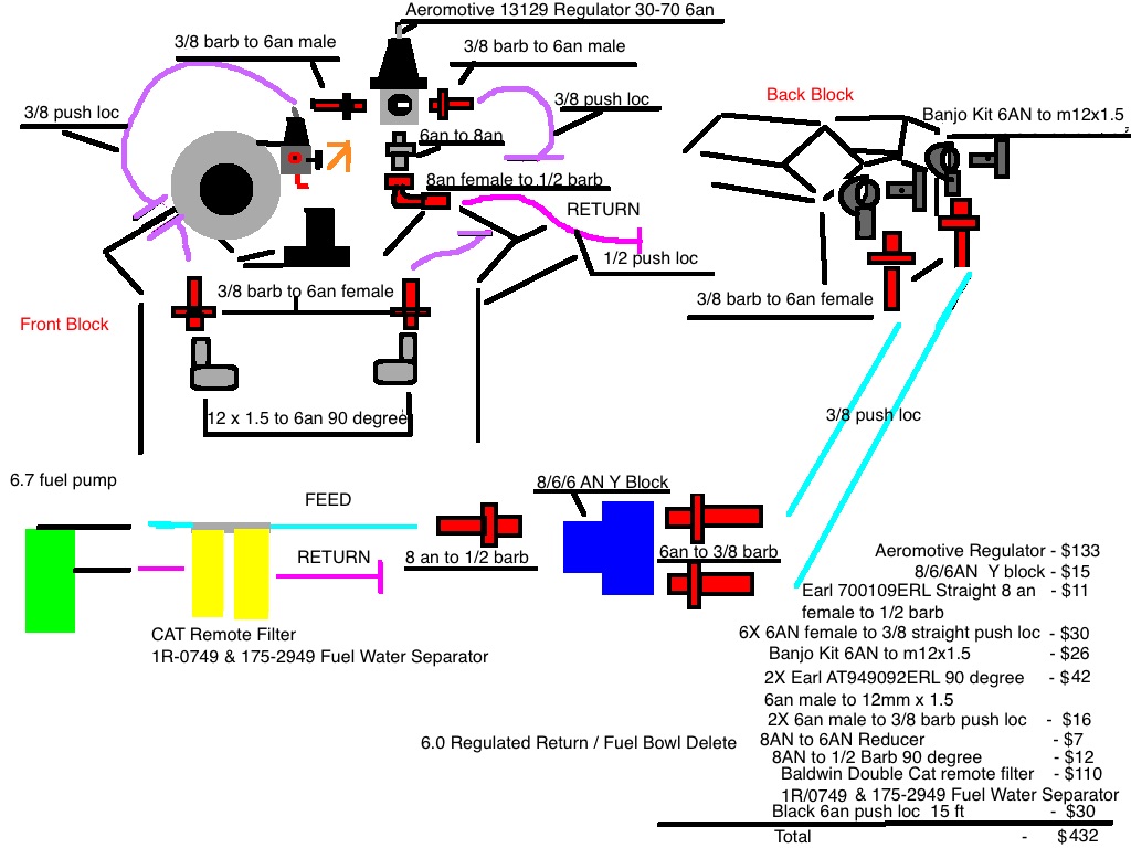

So I'm looking to build a RR for my truck. I have sorta have a idea of what i want to do. My 6.7 pump to a dual remote filter base using a cat 1r1749 fuel filter and 175-2949 water separator to a y block. Then down size from 1/2 to 3/8 at the y block. Feed back of the heads using a 3/8 push loc barb with 6an female to 6an with 12x1.5 banjo. Then out the front with 12x1.5 90 degree 6an with 6an to 3/8 push loc up to a 13129 aeromotive regulator then straight back to the tank. Im trying to ****** my upper fuel bowl. I see no need to purchase it when I only use 1 of the filters.
I do have few questions.
Will going straight back to the heads be fine?
Will returning straight back to the tank hurt anything? I see on the purchase kits, they have a block you return to which then goes back.
Also will using push loc hose hurt anything or will it be to hot for hose?
Is the 13129 regulator enough for my needs?
I have made a paint drawing of my idea and prices i have found.
Can y'all look it over and see what I'm missing or could improve somewhere.
Please don't make fun of my drawing to much. I know its not the greatest but help me get a visual of what I wanted to do.
The picture goes from bottom left to right and up then back over

I would not use push loc on the back of the engine, way to hot. That being said I just replaced my old regulated return with a strictly diesel, yes they are a touch pricey but you can't beat the fit or quality. The RR I took off used 90's in the back and had braided stainless lines from there to the regulator, it took some creativeness to tie the lines up so the wouldn't shake around and rub, after swapping it out I wished I'd never bought the old one.

I do like the strictly kit. It's just I would like to feed from back of the heads and ******** the bowl. With the strictly kit I only really need half of it because then I would still need the buy rest of the parts.
So I need to look into braided or hard lines from the y to the back of the head.

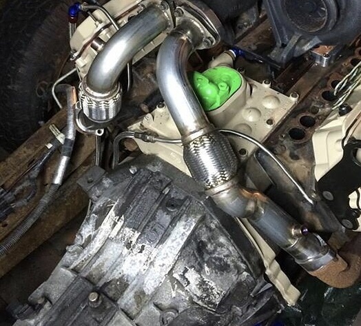

I’m feeding the back of my heads as well. I found a guy that made a set of hard lines for me to use.

Nice! Did you install hardlines with cab on or off? I feel it would be difficult to manipulate the line over the trans with cab on.

I did it cab on while I was doing my T4 setup. It’s really pretty easy once the up pipes are off.

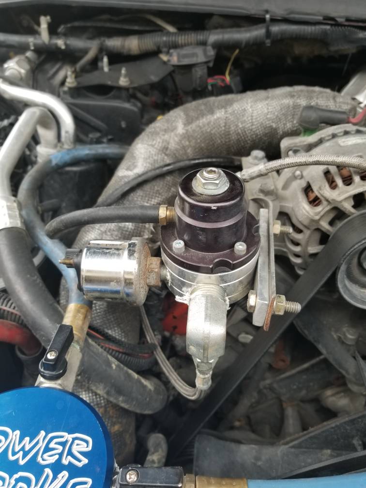

Here's one for you. Still utilizes the upper filter.
I'm still confused as to why they used a boost reference regulator.
