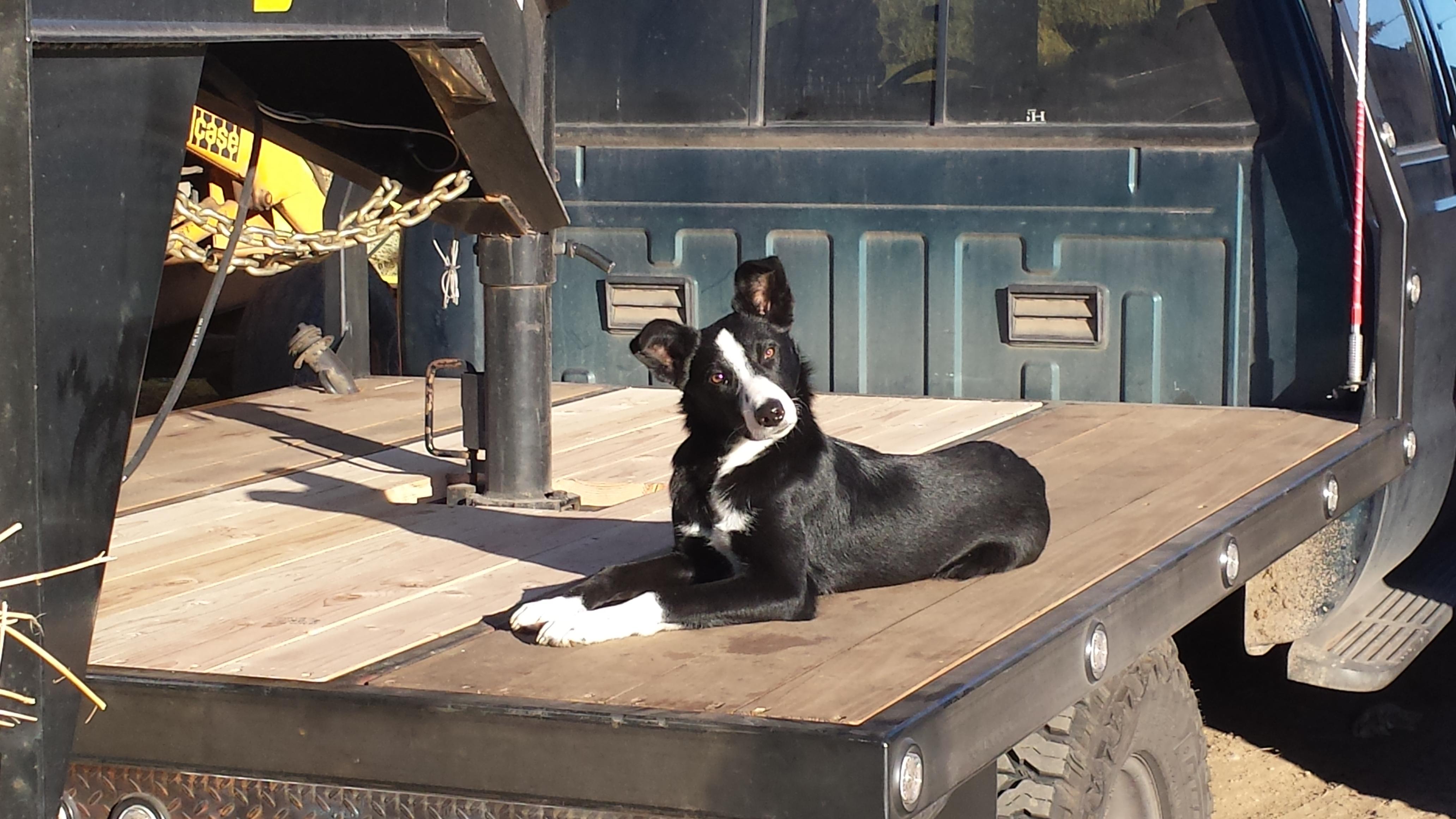

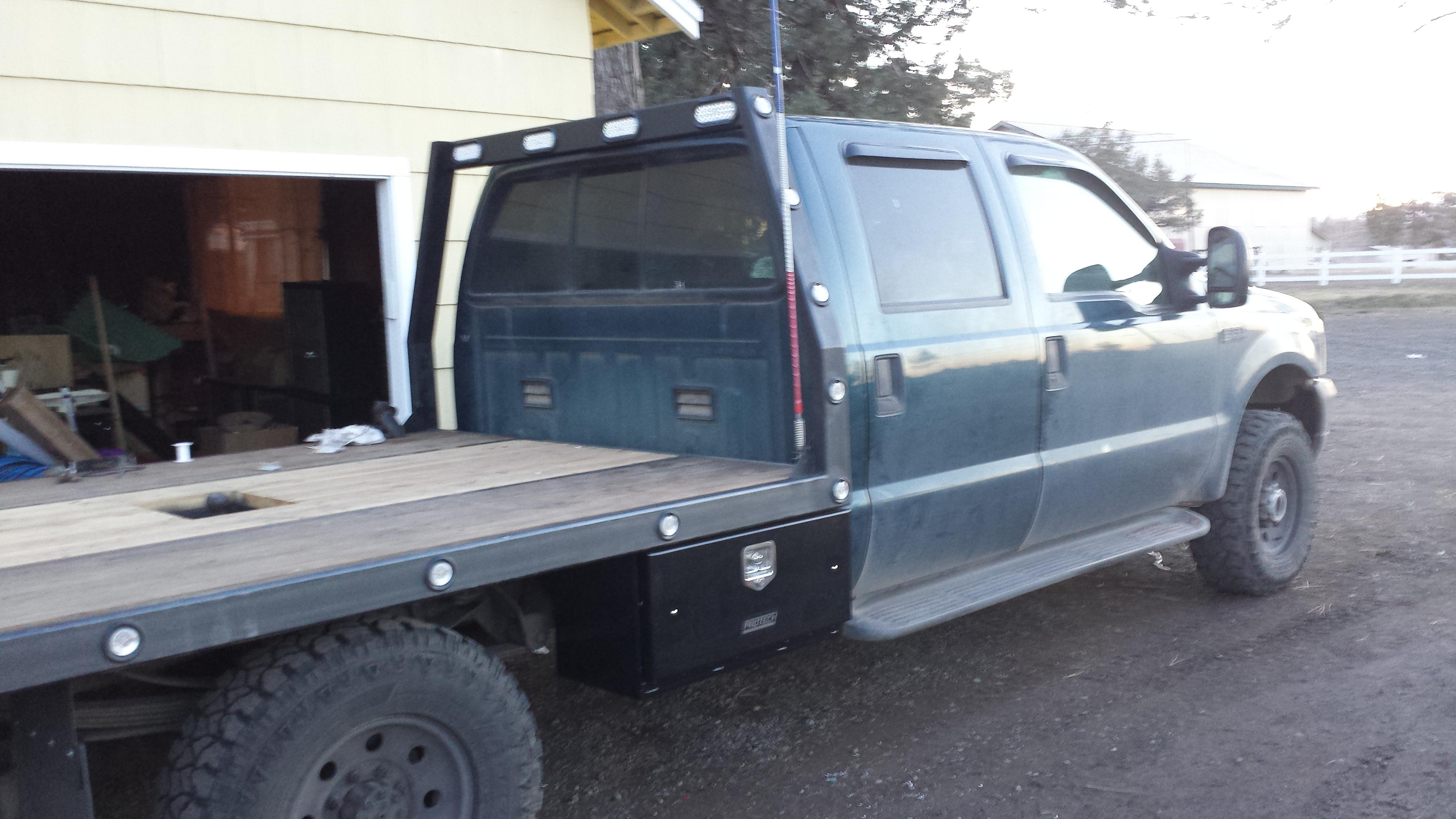

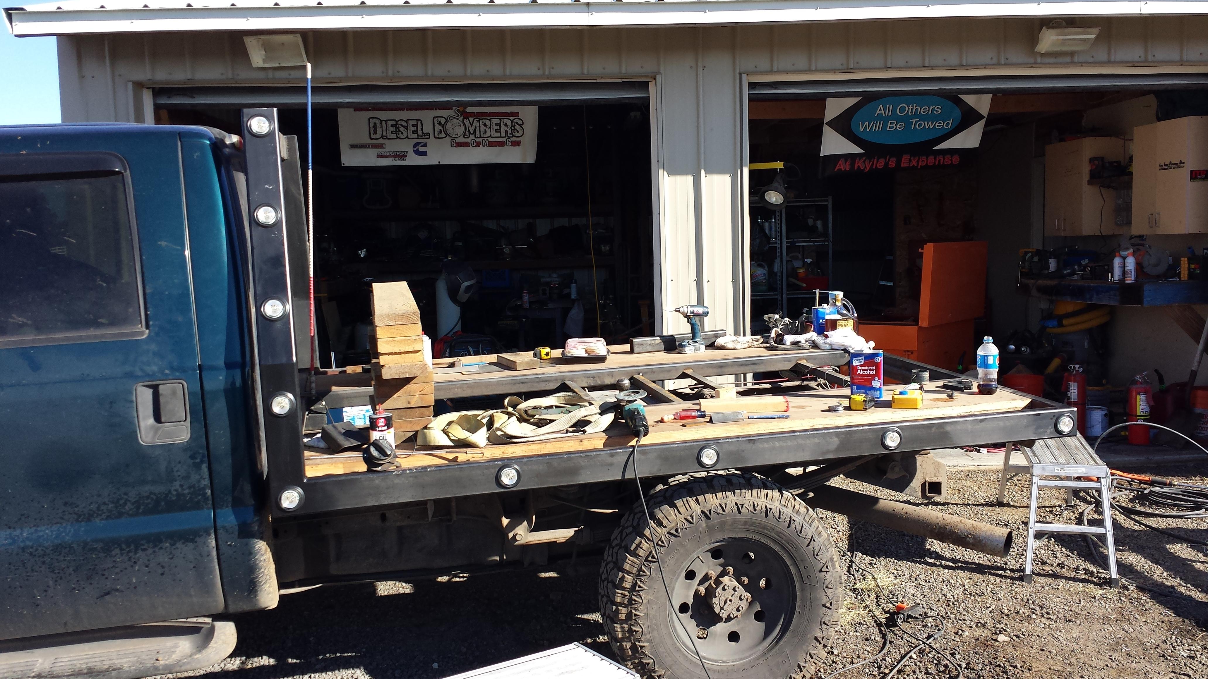

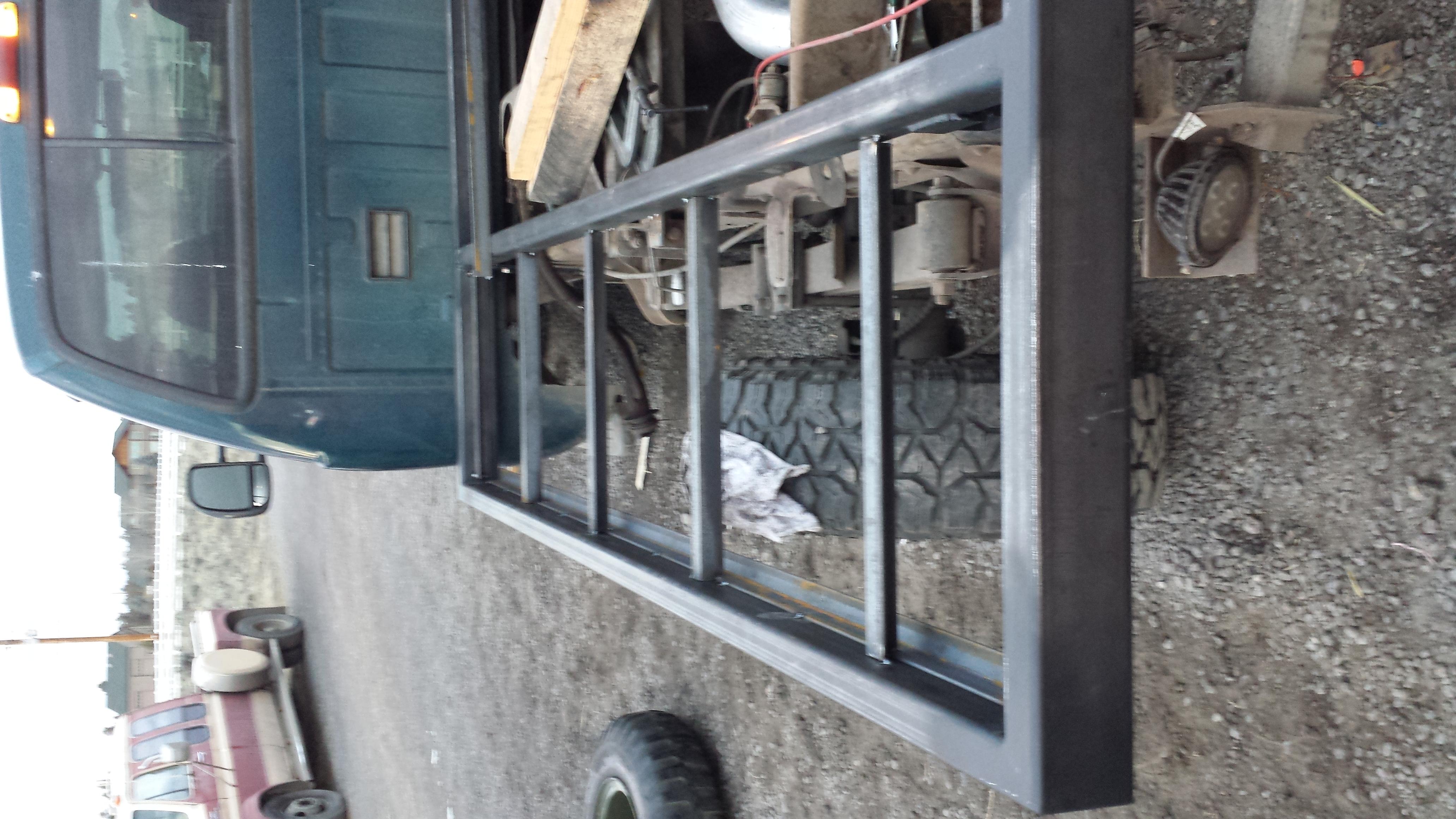

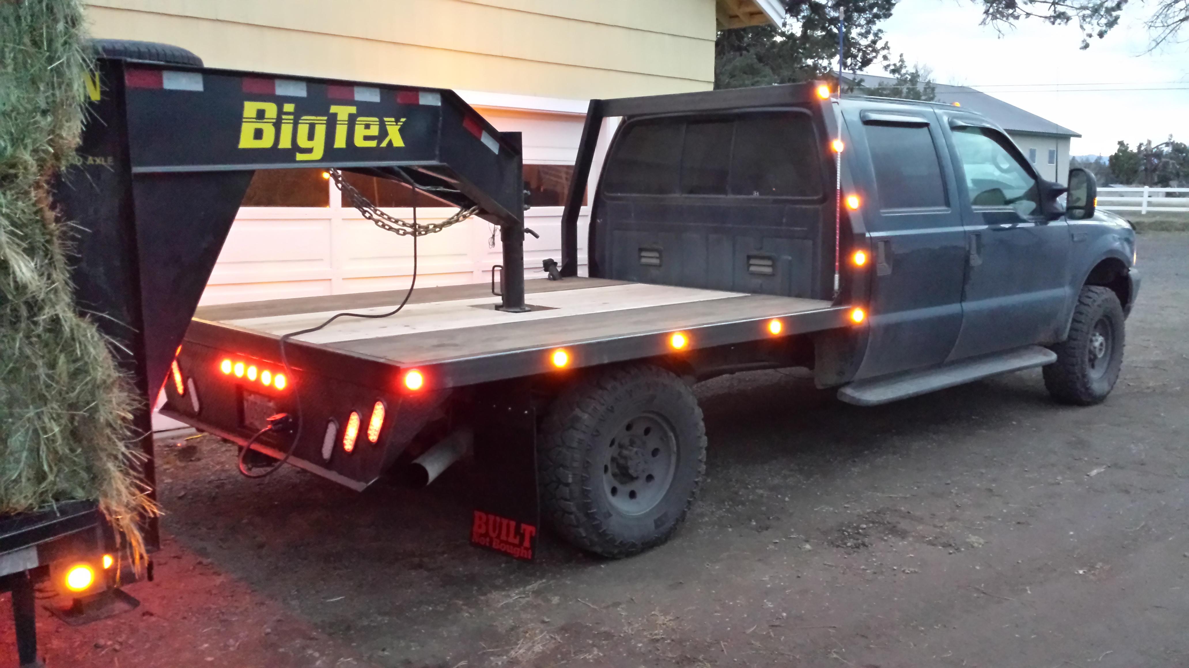

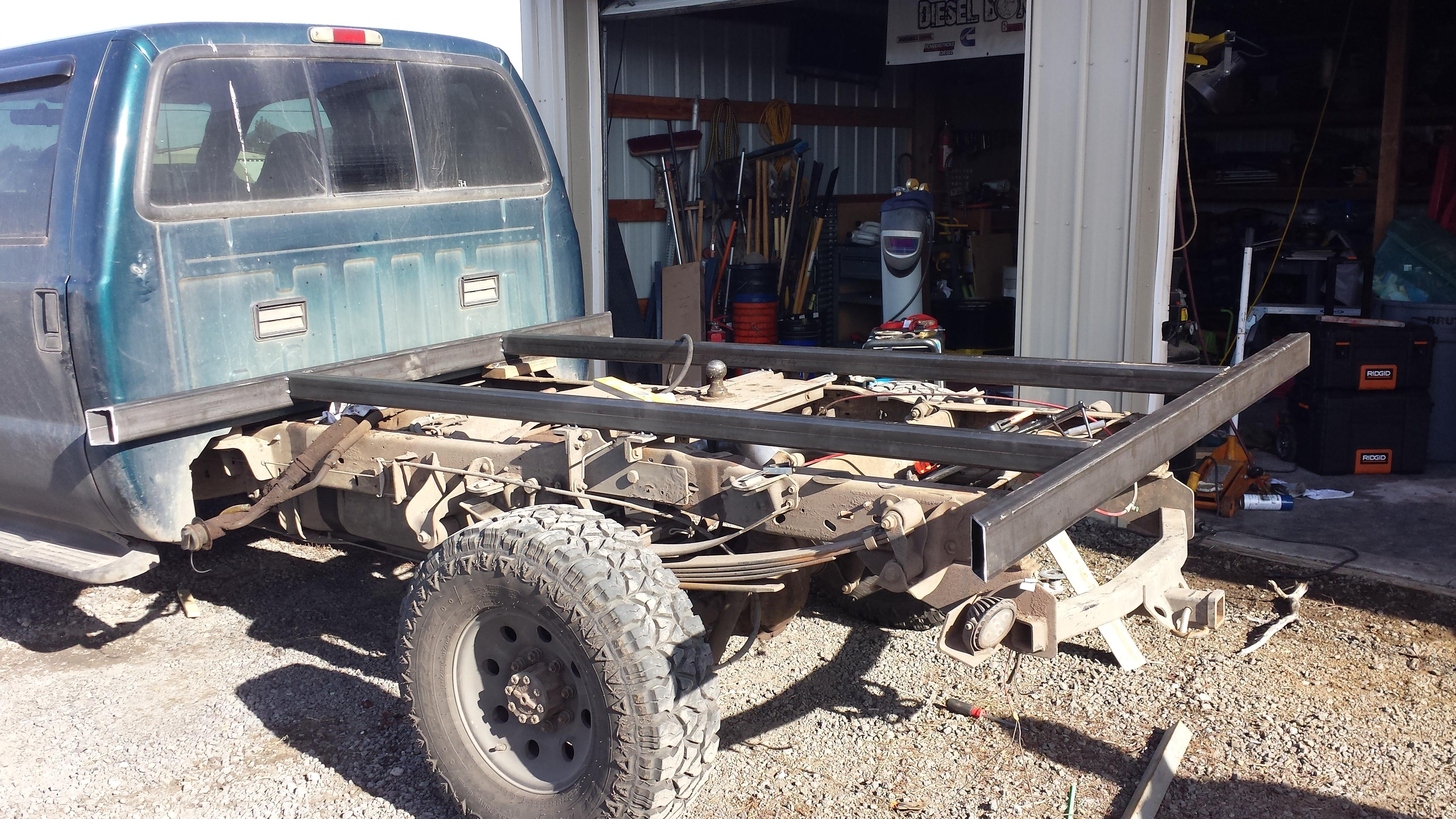

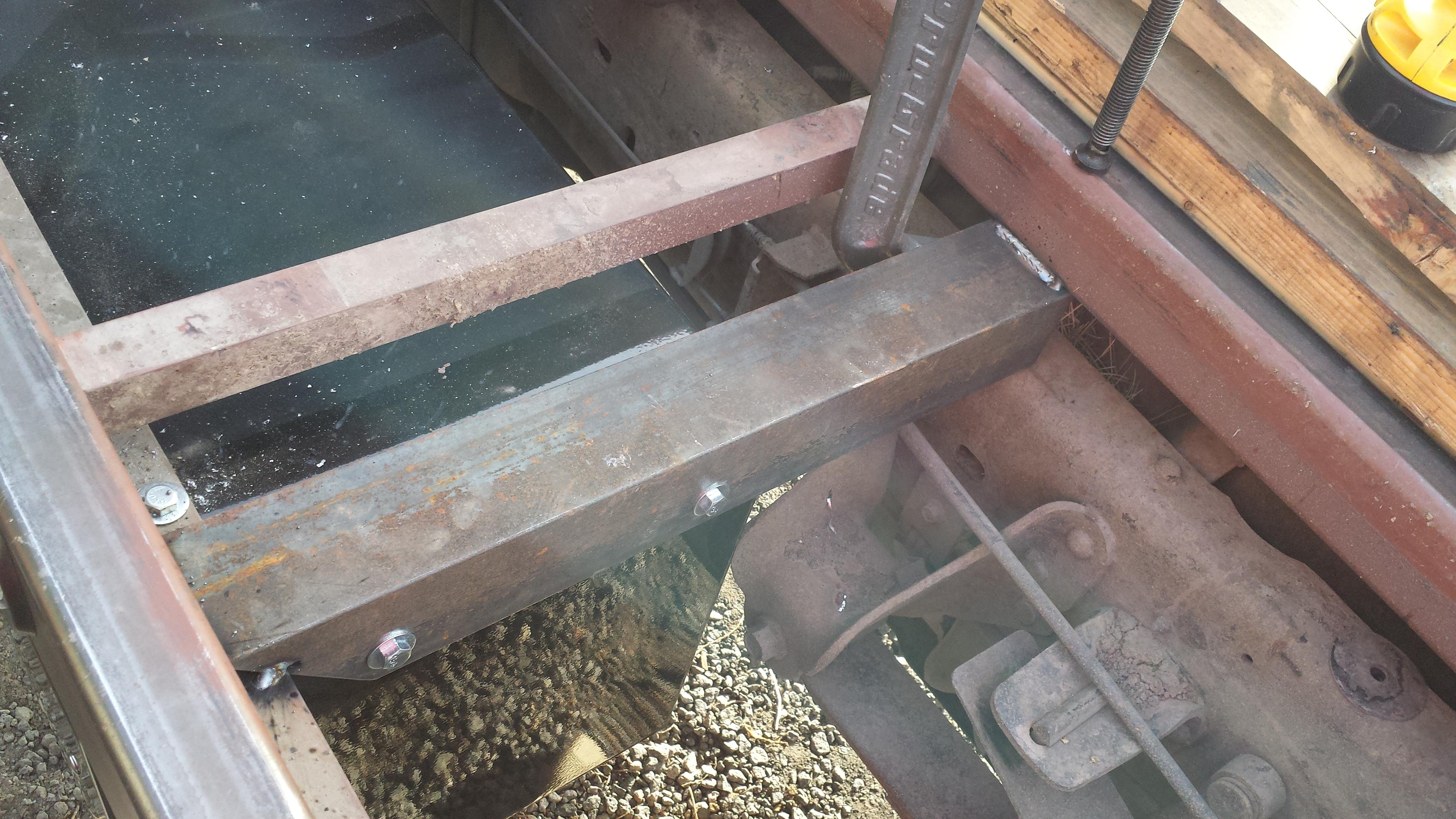

Well finally got around to getting this started.... decided to keep my B&W GN hitch and build the bed around it. In doing that i decided i liked wood deck better than metal and decided to make it look kind of like my trailer (main beams showing through the deck).... i have mis matched boardes at this point, the two exhaust tips dont match, headache rack/slip tank isnt done (including 4 more ovals in upper bar) and my Protech side boxes are in the back seat but its slowly coming along!! All Truck-Lite LEDs all the way around...
Big thanks to CSIPSD for letting me use the shop and tools to get it done!!! uploadfromtaptalk1425191720304.jpguploadfromtaptalk1425191998800.jpguploadfromtaptalk1425192098626.jpguploadfromtaptalk1425192183522.jpg

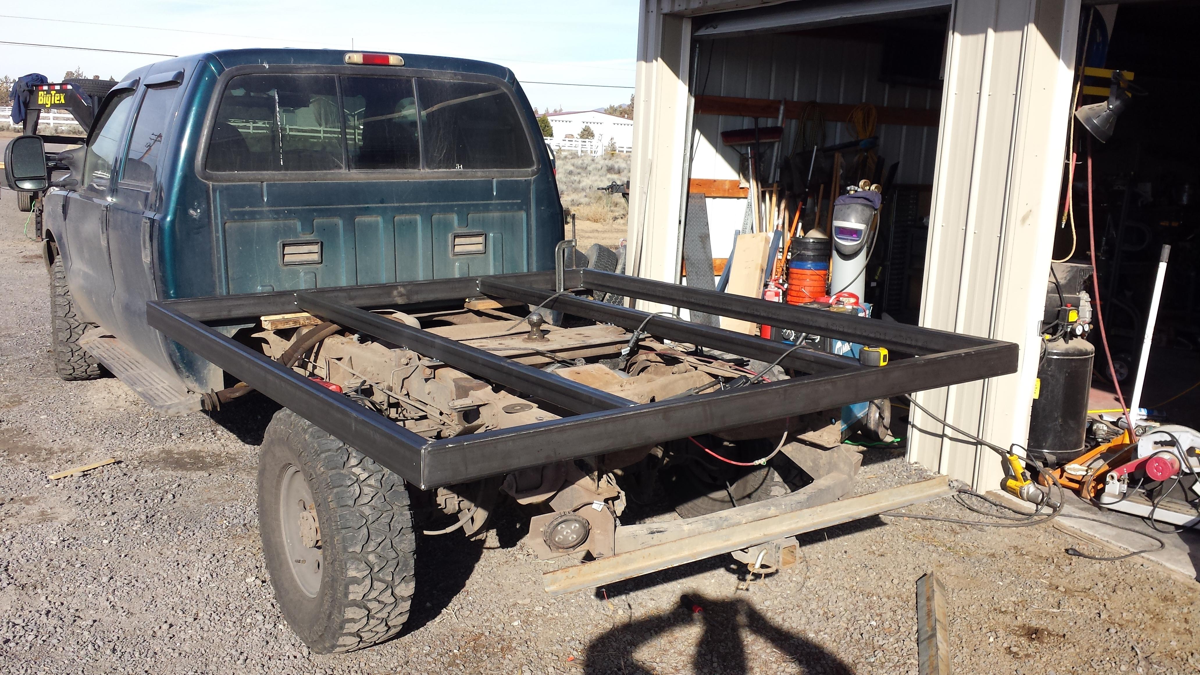

I have several more pictures but im on vacation, on an island and service is way too ****ty to try to upload anymore! Loluploadfromtaptalk1425192442377.jpguploadfromtaptalk1425192520431.jpguploadfromtaptalk1425192584945.jpguploadfromtaptalk1425192673495.jpg

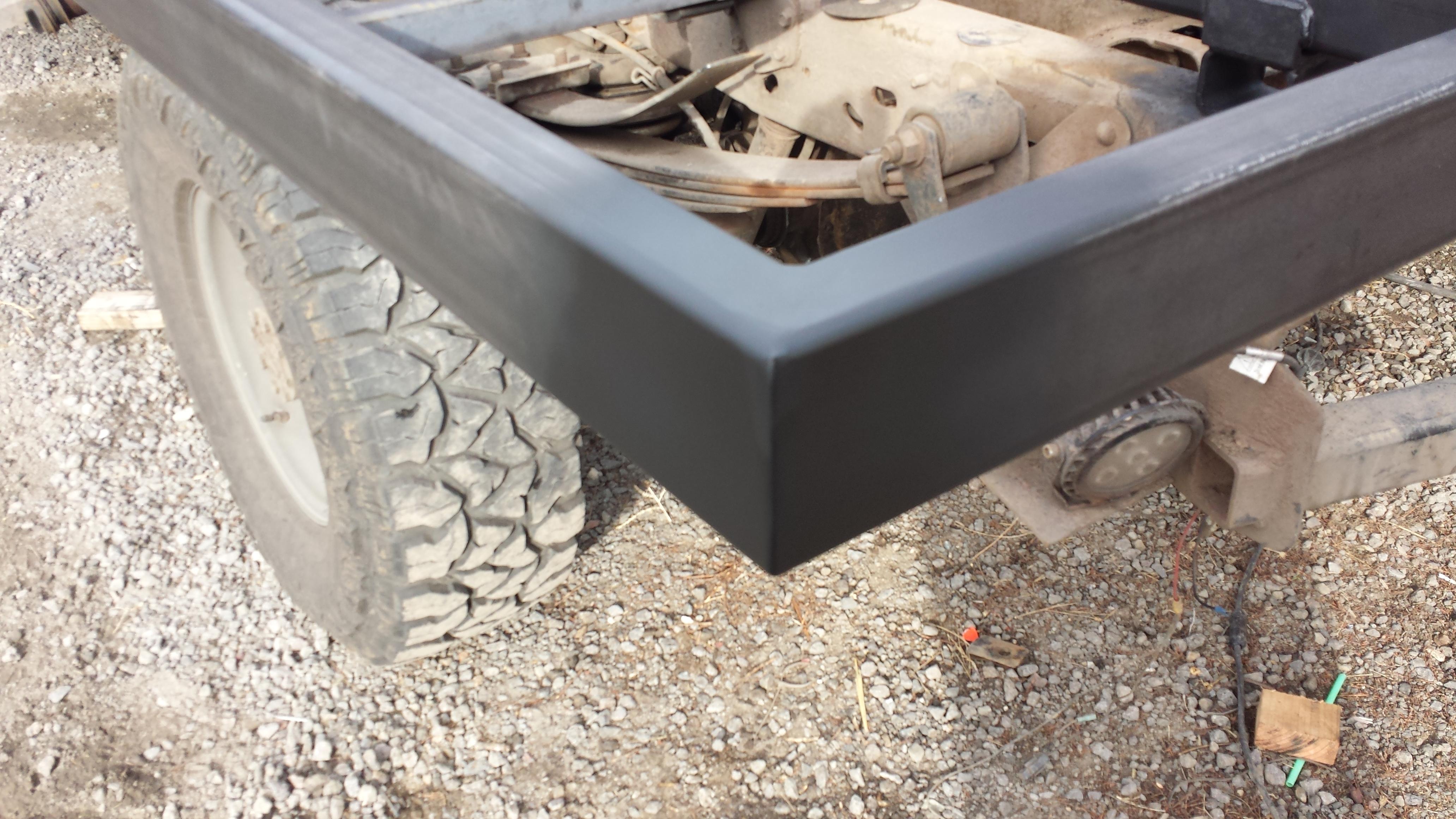

Nevermind my pup, just shows the main beam look a little better.....uploadfromtaptalk1425193918139.jpg

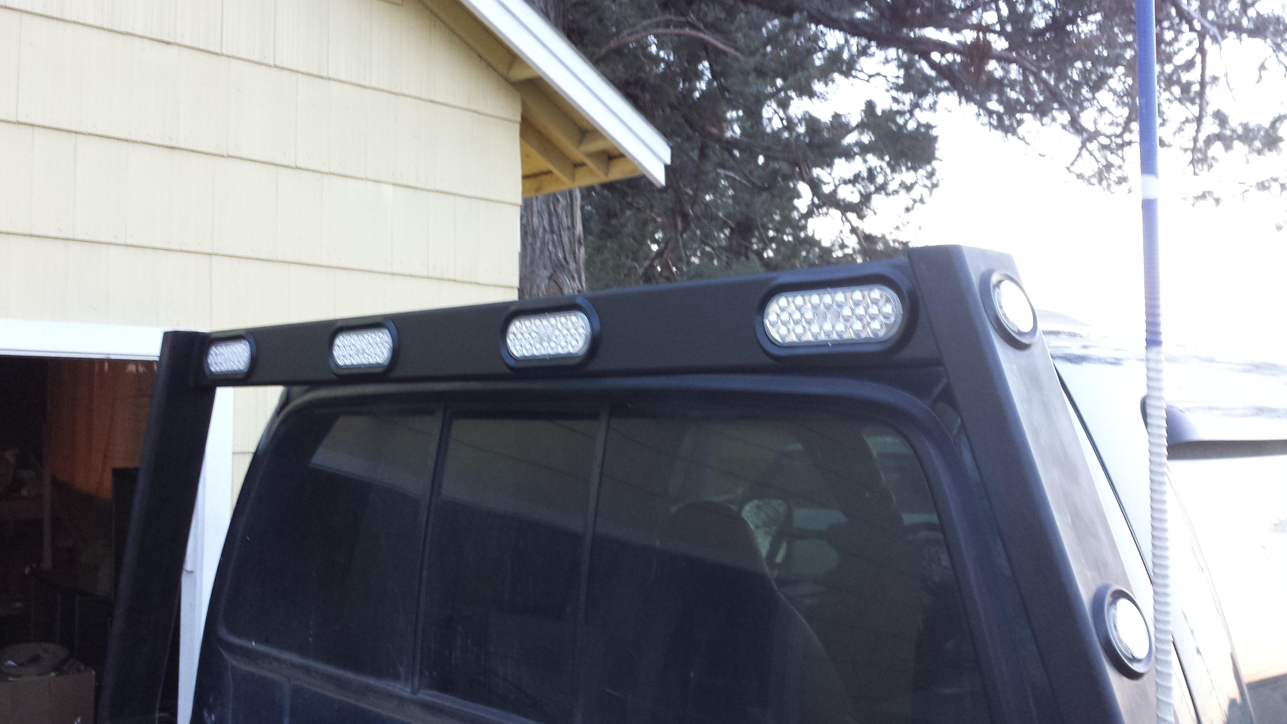

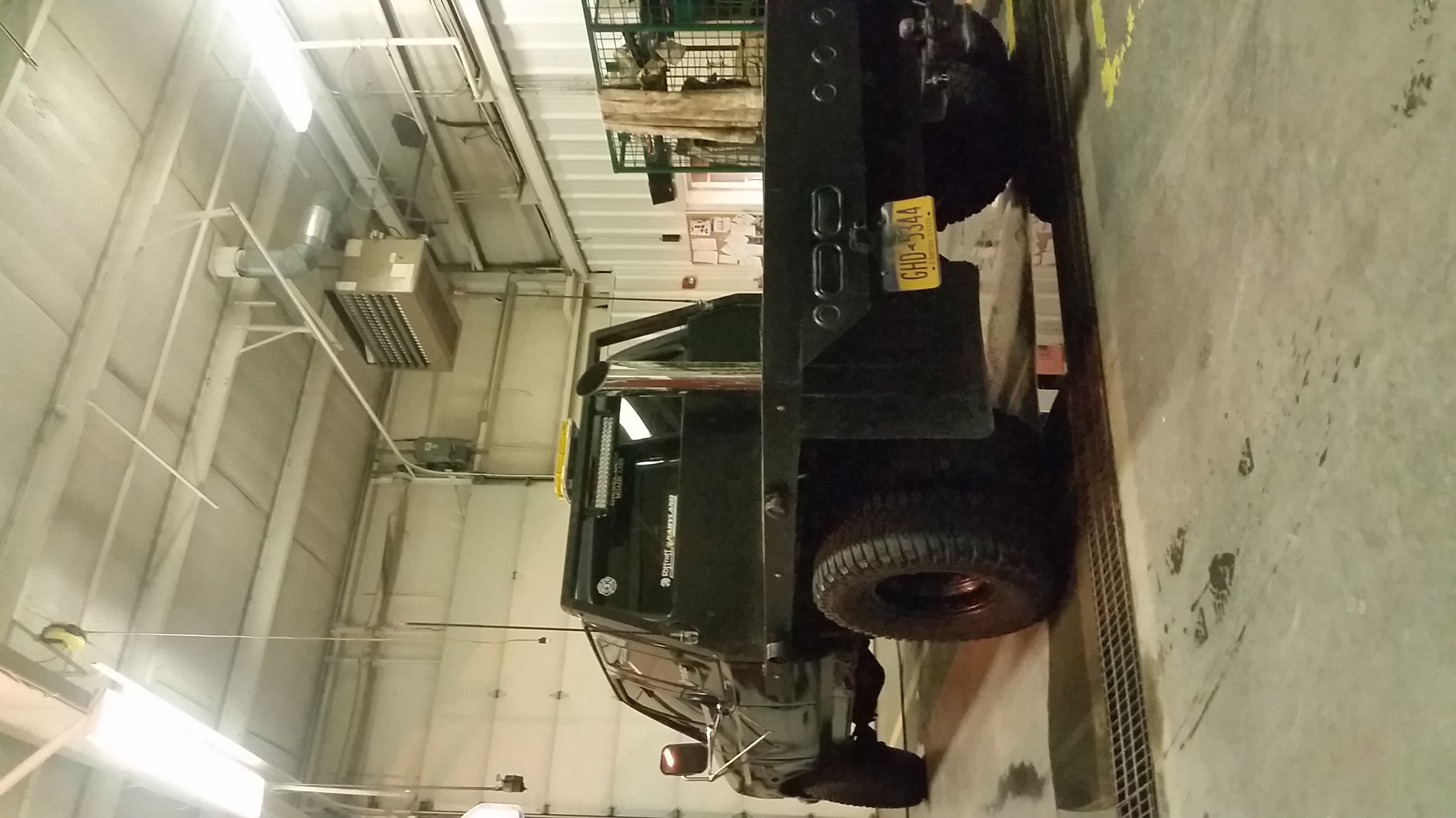

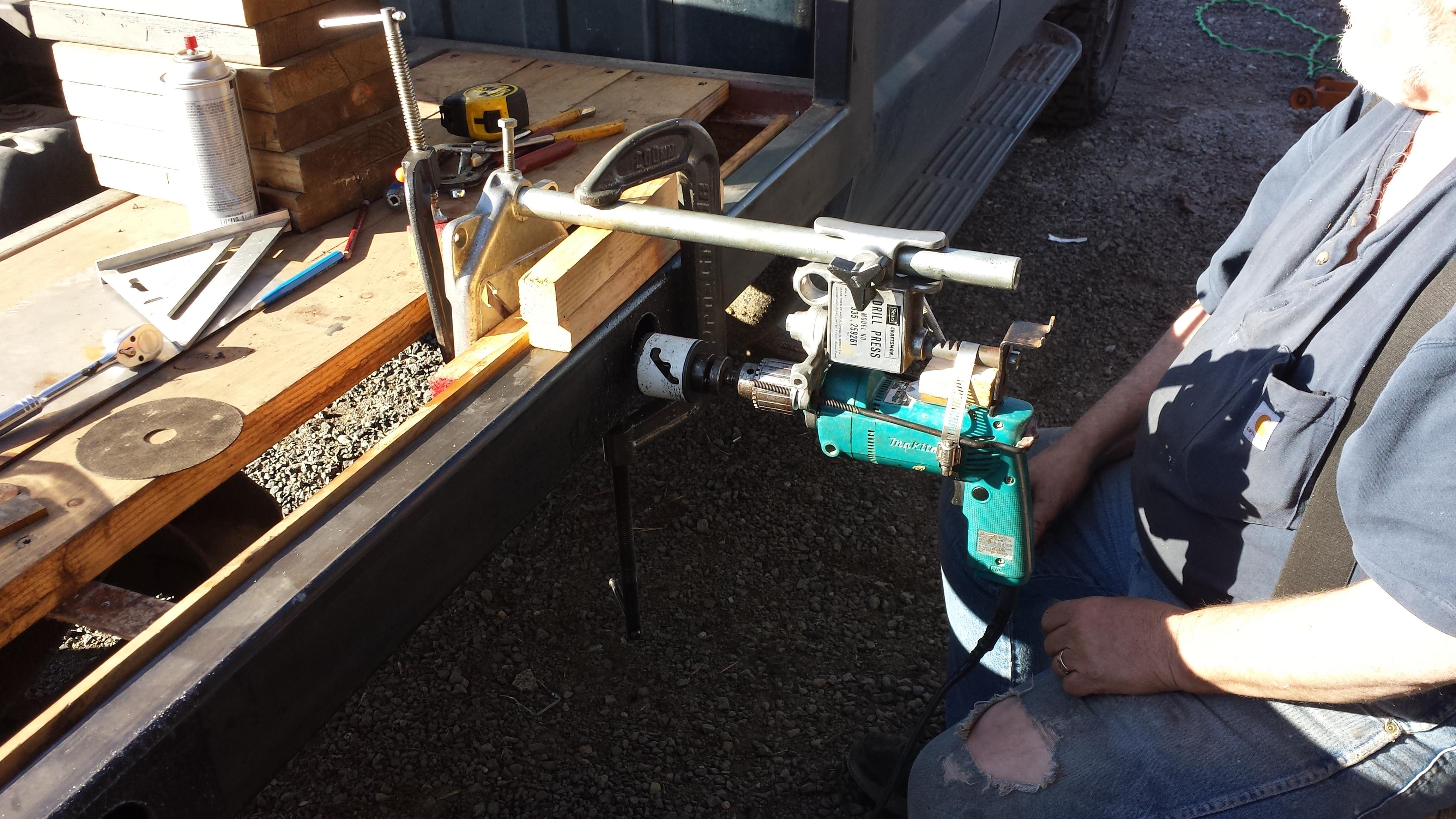

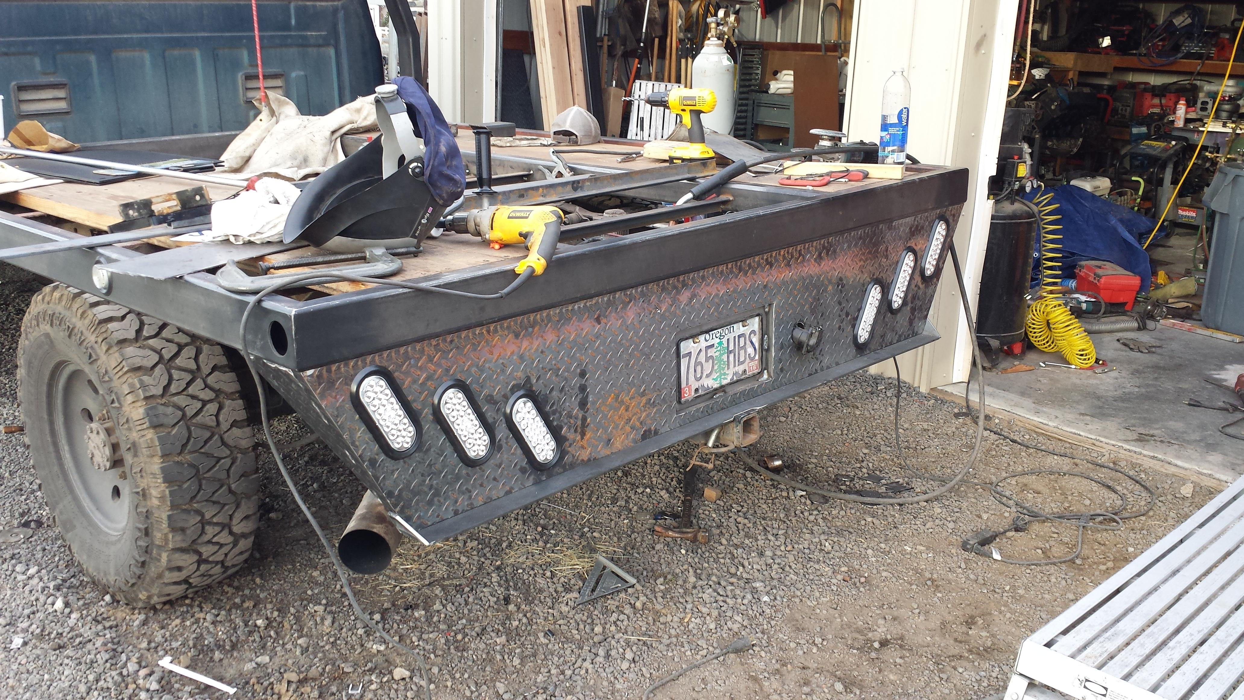

Nice!! How did you drill the holes for the tailboard? Im thinking of redoing my tailboard a little different and im gonna put two stop/turn/tail lights in the top corners of the backrack but im not sure how im gonna make the oval shape. Best picture i have of the tailboard
blk99
Feb 18, 2012
210
For ovals, use a 2 1/2" hole saw for each end of the oval... center to center of holes is 4 1/4".... then just connect between the 2 holes with a cut off wheel and grind all the sharp edges off.... easy cheesy....
The tail board i built a frame work and then skinned it with the diamond plate that i already cut all the holes into....
Today i plan to start working on the transfer tank/fuel filler setup and get my 4 ovals put into the headache rack.....
Got the boxes on yesterday, finally!!

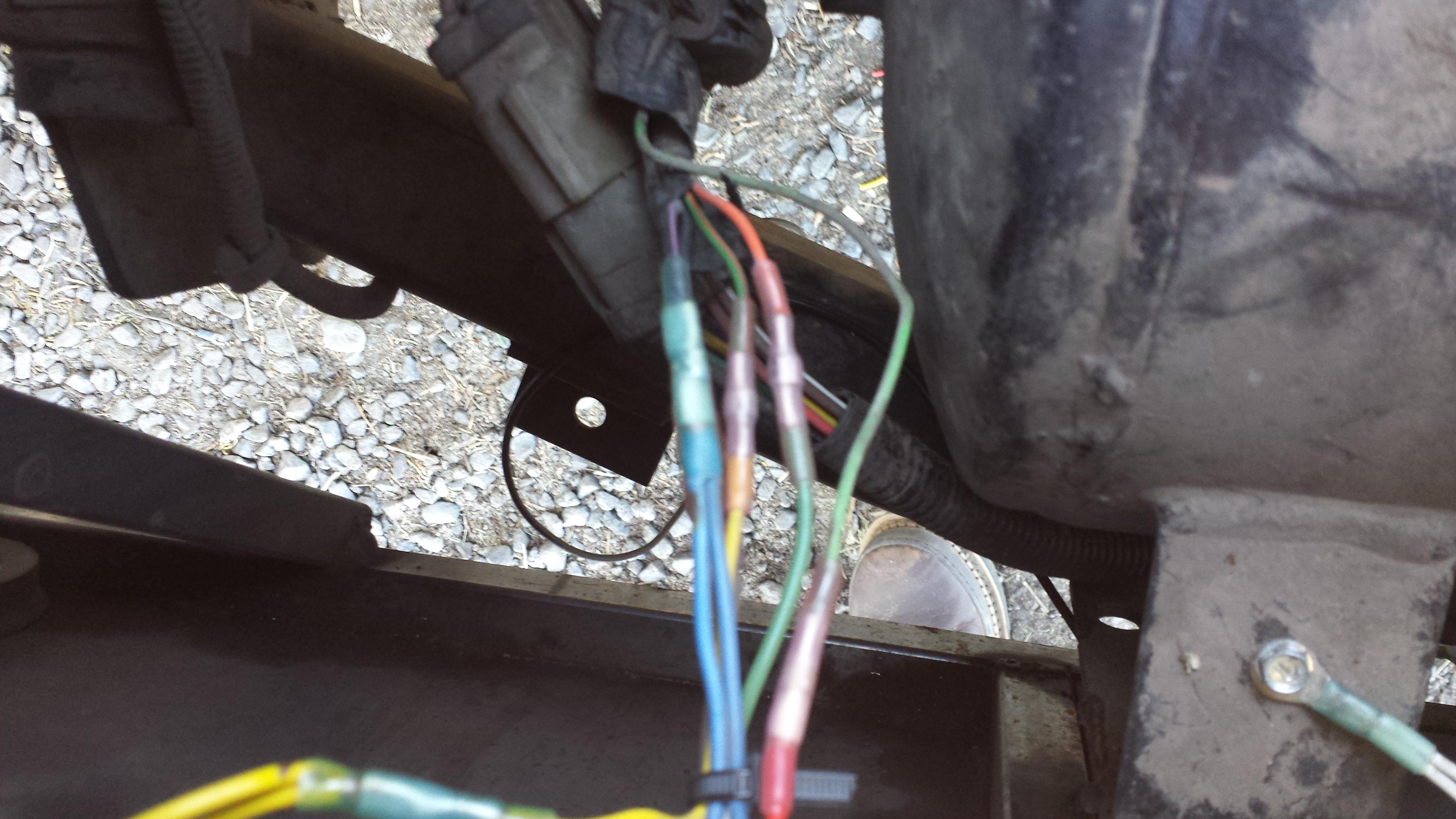

Got the 4 headache rack lights cut out and wired up today.... outer 2 are stop/tail/turn and inner 2 are only stop/tail.....also ran wiring for 2 of 4 LED 5"work lights that will hang from top bar....150+ ft of all 16 gauge wiring and been using all shrink wrap/solder butt connectors....
Glad to finally have all the lights in and wiring done! uploadfromtaptalk1425793204515.jpguploadfromtaptalk1425793236711.jpguploadfromtaptalk1425793273040.jpguploadfromtaptalk1425793317099.jpguploadfromtaptalk1425793353293.jpg
