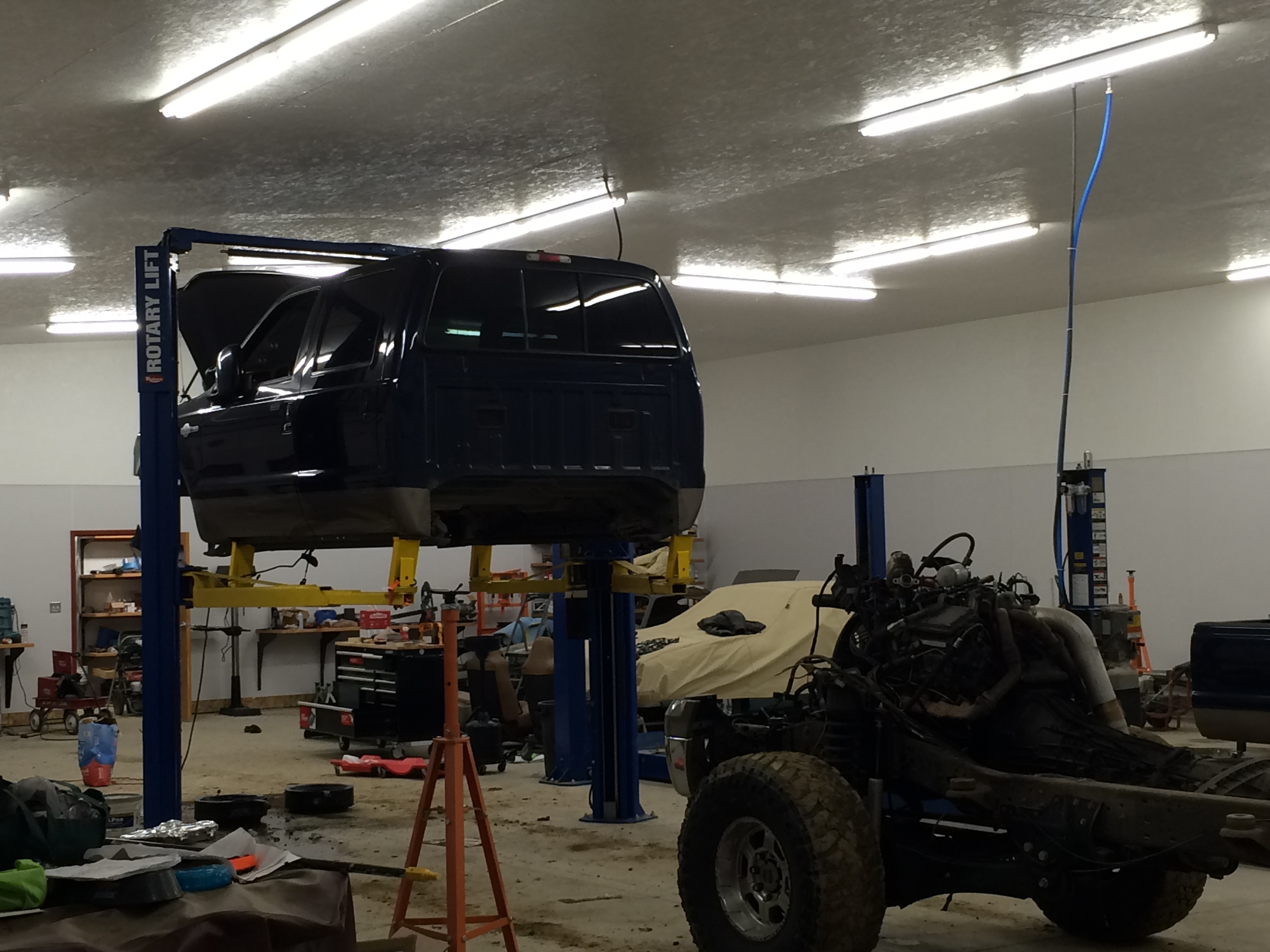

In December I had the #8 rod let go and decided toits go all out on a build. Using carrillo rods, billet cam and stage 1 valvetrain, ported heads, ported manifold, o ring the block and coated pistons and heads. power goals are not set, since I will do the motor build this year then ill do a different turbo set up in a year or two if work stays this good.
Will up data pictures as I go and details.
