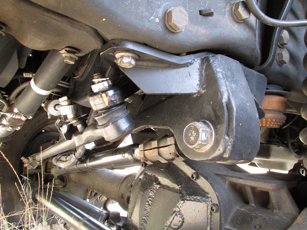

I talked to Marty a lot on the phone trying to solve a bumpsteer issue. I figure ile put some pictures of the customish trac bar bracket myself and a friend put together to solve the problem per Martys recomendations and my testing. Hopefully he dosent put the pics in the Why File.

Yes on the PSC ram assist modded box and PSC ram.
The trac rod is Icon.

I took me hanging my truck from a crane by the tow hooks then removed parts so I could get the coils out. Once the coils were out I locked the tie rod down then raised the truck up and down to try to get an idea as to what the problem was based on what Marty told me. Hes why I took the four link off and put the ALAs on. I ended up adjusting the ALAs all over the place with no improvement. I probably tried something like this five times. It came down to changing the upper mounting position of the trac bar, which led to modifying a skyjacker trac bar bracket to suit my needs.

The problem is not to bad at this point, since ive made the new upper trac bar bracket.
I apologize if im using the incorrect word by saying bumpsteer. The issue was and still slighlty is, the steering wheel will rotate, steer, oscilate in my hands when going over bumps, most noticable at highway speeds. The handling of the truck is not a problem, it steers where I want when I want.
The situations that this occurs now is when I travel over roads and bumps are not even all of the way accross. Imagine going over a speed bump that is at a perfect 90 degree angle to the road, both front tires hit the bump at the same time. In this situation the steering wheel does not rotate. Now if the speed bump is at a 45 degree angle to the road. The right front tire hits the speed bump first, the steering wheel will turn to the left then when the left front tire hits the bump the steering wheel will turn to the right. Thats the jist of it.
I havent driven another truck with the same setup as mine, so maybe this is acceptable and im just to damn picky.

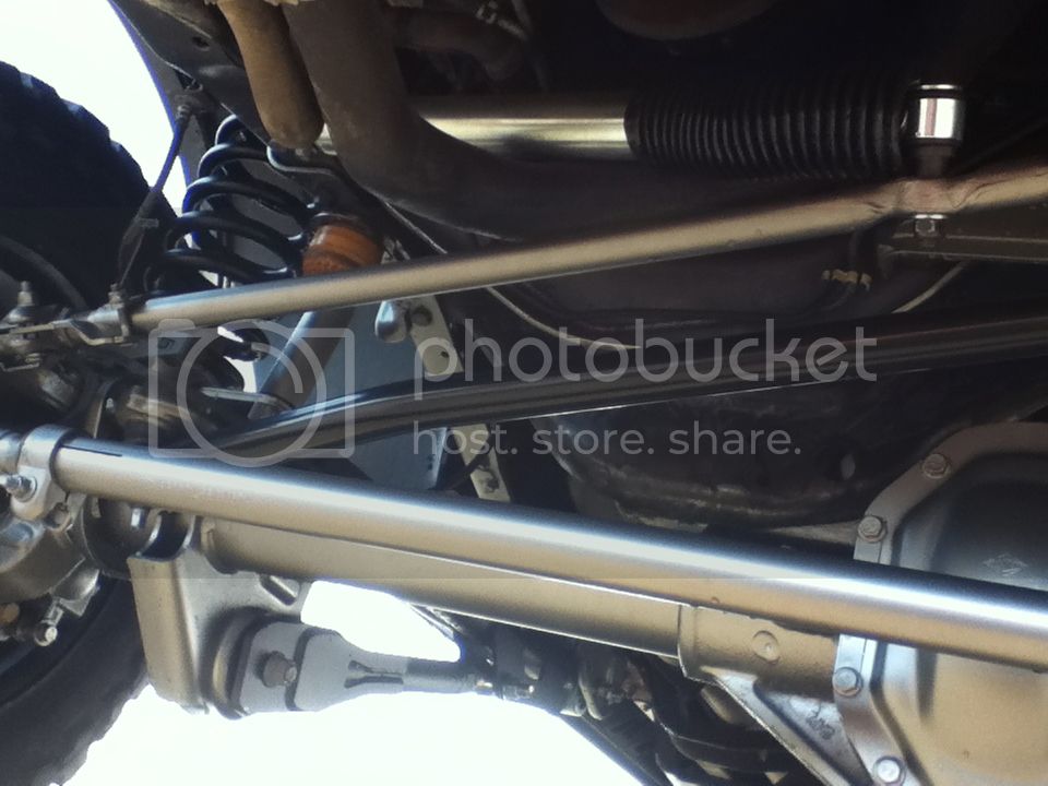

Hope Dave can help you out. I am thinking it has got to be your track rod bracket... If it got better from start to finish than maybe that is it. Something is just slightly out of whack. I am going to throw up a couple pics that you have seen of my buddies setup. Just for anybody else out there... 08 axles on 2000 truck, stock 05 track rod bracket, stock 08 steering box, OUO Ala's and OUO traction bars. 4.5" Icon...
Like I said Dave is a wealth of knowledge and hopefully he can help you out.
