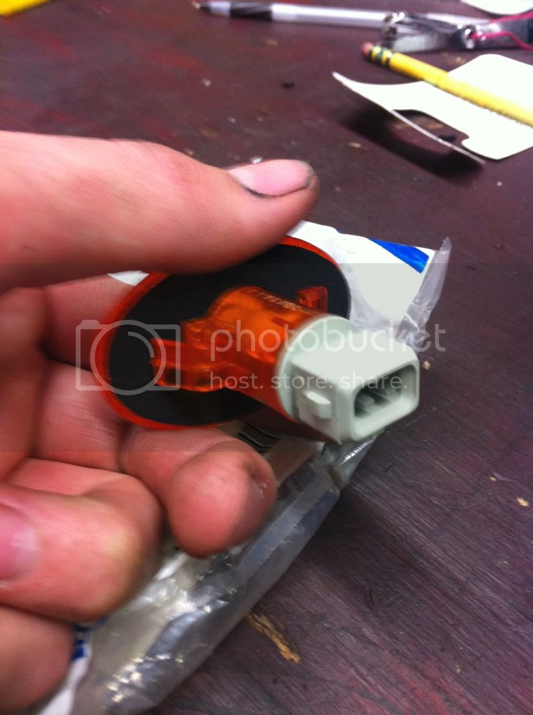

On edit I happen to have one laying around
Turn to left
Pull
If you do happen to break one here is the orange part number for 99-10 fenders
