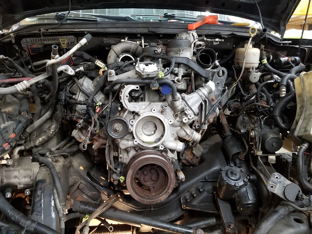

Well here we are once again. I'm right at 198k, Just 30k since I did the top end, (and thought about pistons), and now have a cracked piston. Rebuild time. It happened out of nowhere, and I just got back from a 1100 mile trip with the camper and the truck ran perfect... until it didn't.
This time, I decided to tackle the job myself. Since I have a nice space, but no lift. The engine is coming out the front. I'm semi mechanically inclined, but not a pro by any means. Hopefully some of you will catch some mistakes I'm bound to make. I don't dd the truck, and don't drive it in winter. So all I have is time.
Once I get it out, I'm going to have my block rebuilt. Do some form of coated pistons, cam, and possibly try to go for more power while I'm there. Truck is in great shape, so instead of spending $60k+ on a new truck, I will make this one new.

Getting closer to having it out. I only have ~7-8 hrs into it to get to this point (I'm slow) .. But hoping to pull it Sunday. It took some time but it hasn't been extremely hard or anything to this point. I didn't even swear once yet, that's rare for me lol. Converter bolts were no sweat either.

Got some time into it this weekend. Came out relatively easy, and I just did it myself. Confirmed #8 is cracked, and the cyl wall definitely needs a bore / cleanup.. I will get it stripped down the rest of the way and get it to the machine shop.
Found a broken stud on the turbo resulting in a leak at the driver side up pipe. This is probably where all the soot at the turbos came from. Also looks like my 30k mile Rudy's up pipes are leaking at the passenger side bellow. That sucks, now I need to spend more $ on up pipes... again.
