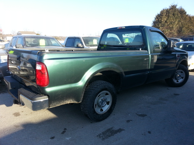

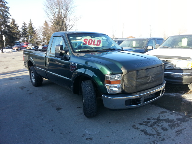

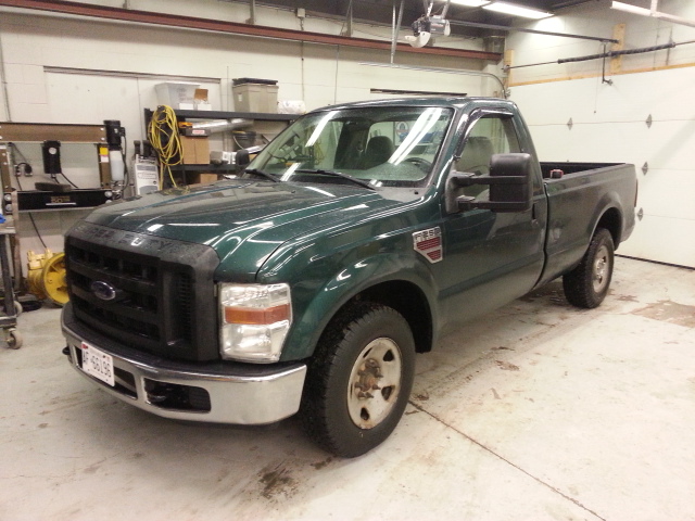

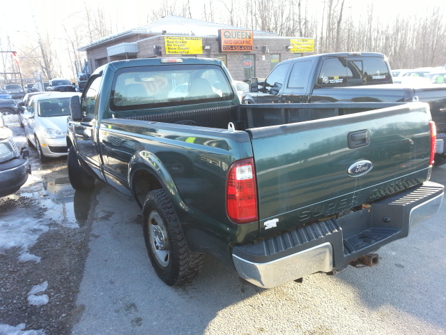

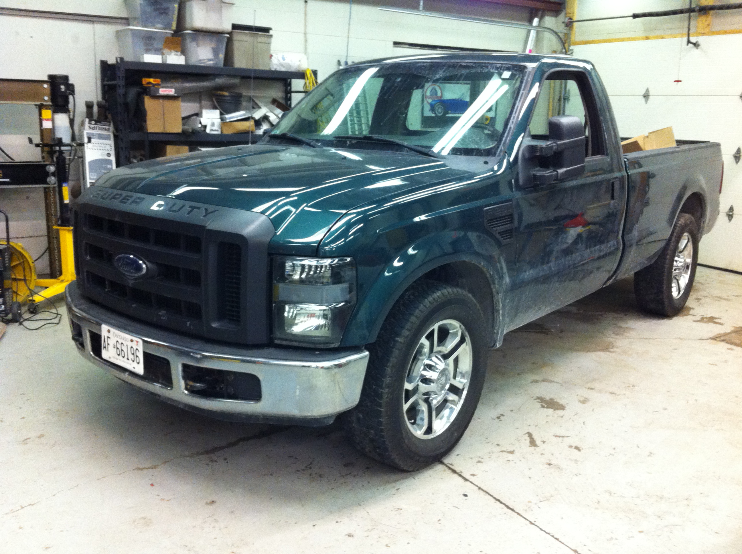

Well guys the time has finally come to build my play/ drag truck! My names Devon Williams from Ontario Canada, I have been on the site for a couple years now and have had 2 fun DD (6.0l and 6.4 that JohnP currently owns) that have treated me well. I got a promotion at work and a company truck that has allowed me to finally build my fun truck. I spent a while looking, almost bought something at the Richie brothers sale but the kms were just to high… finally (and surprisingly) I found this one owner farm truck 15 minutes from my house! Ironically it was the same color as my previous truck but was pretty scratched/ beat up. I think the guy ordered it extra basic with manual locks, wined up windows and no cd player.. but it serves my purpose, here it it’s the day I bought it on the lot, 3 and a half weeks ago

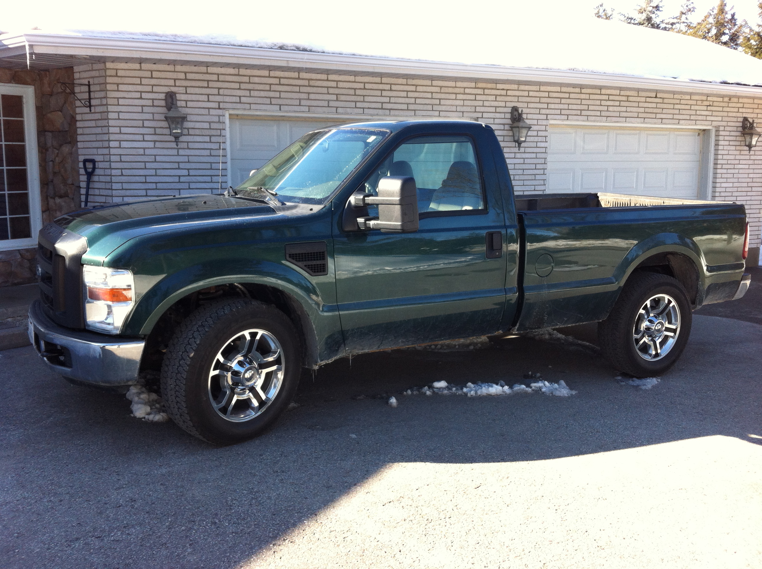

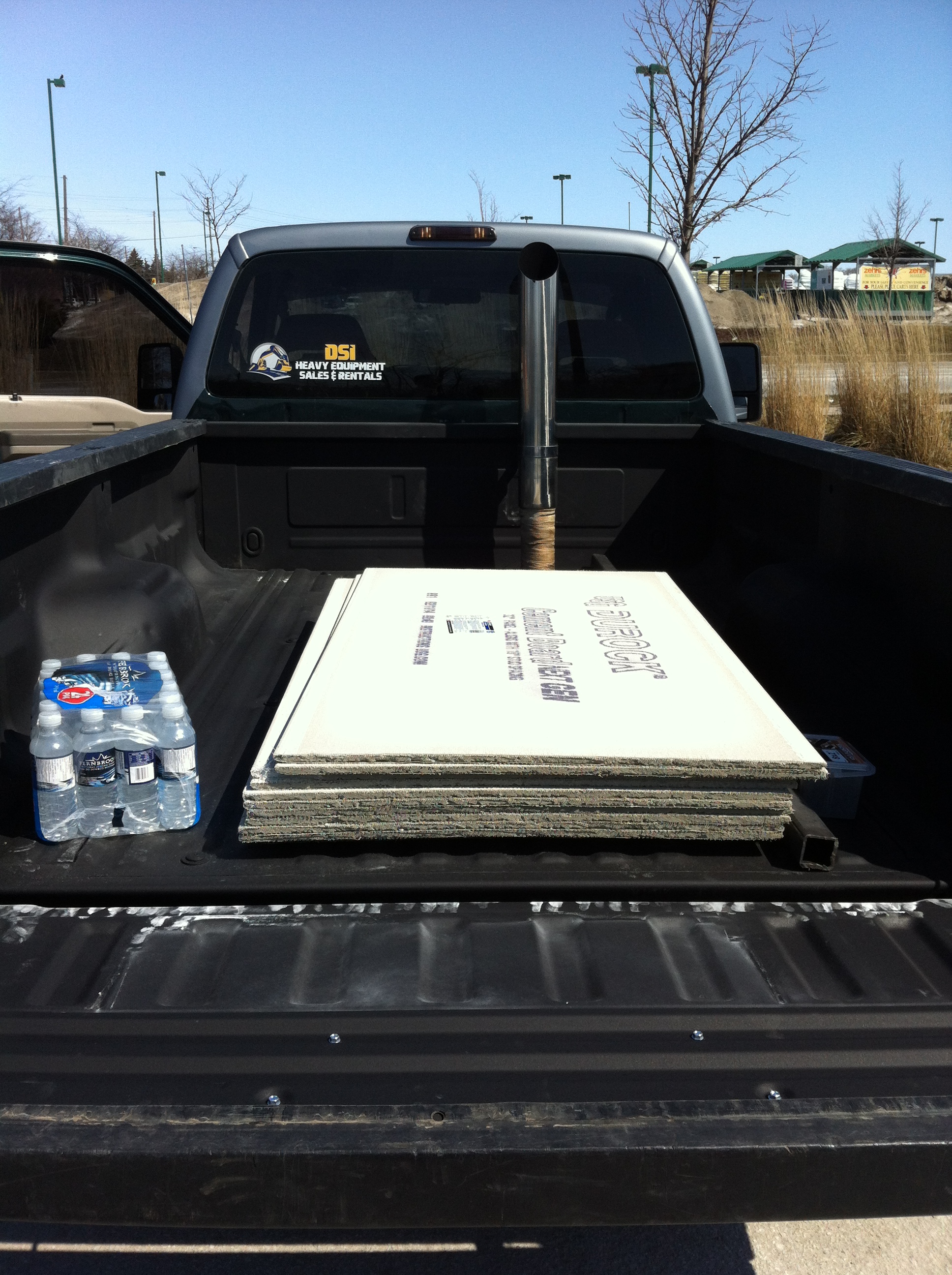

First order of business was getting it road worthy, it needed full brakes on the front, fluid changes and I put on a set of Harley rims that I had. I also removed everything unneeded in terms of weight, ditched the spare tire assembly, trailer hitch, jack etc.

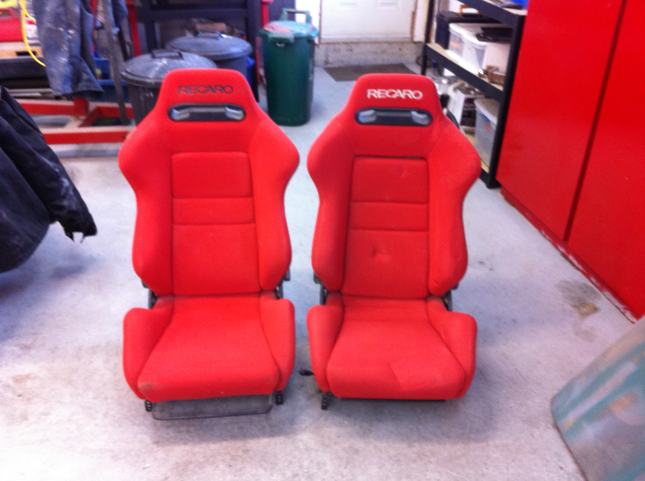

Then came a set of Recaro race seats that I also had along with an SCT live wire with a Gearhead base file and 5” stack, all of which I had saved for this build.

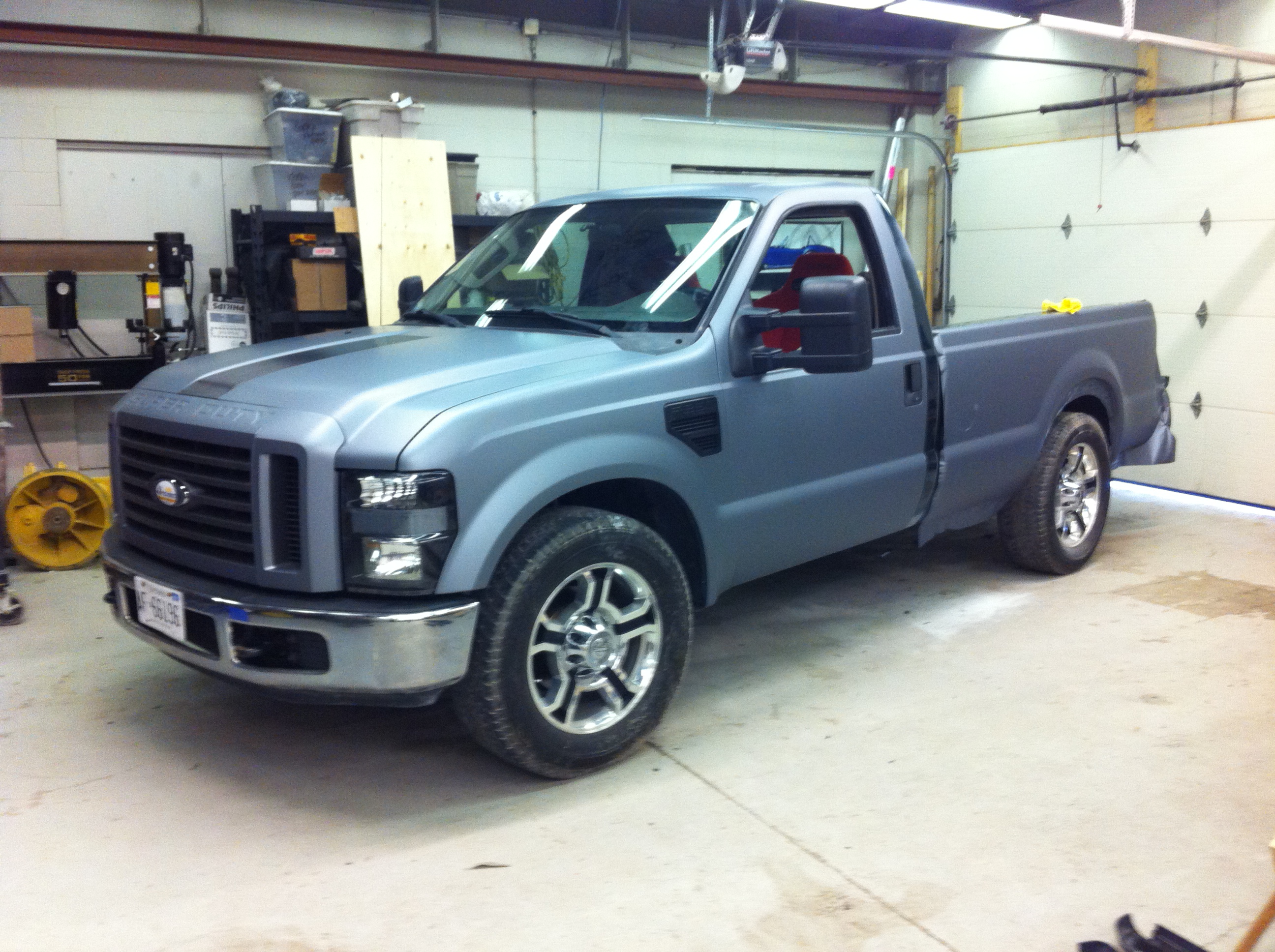

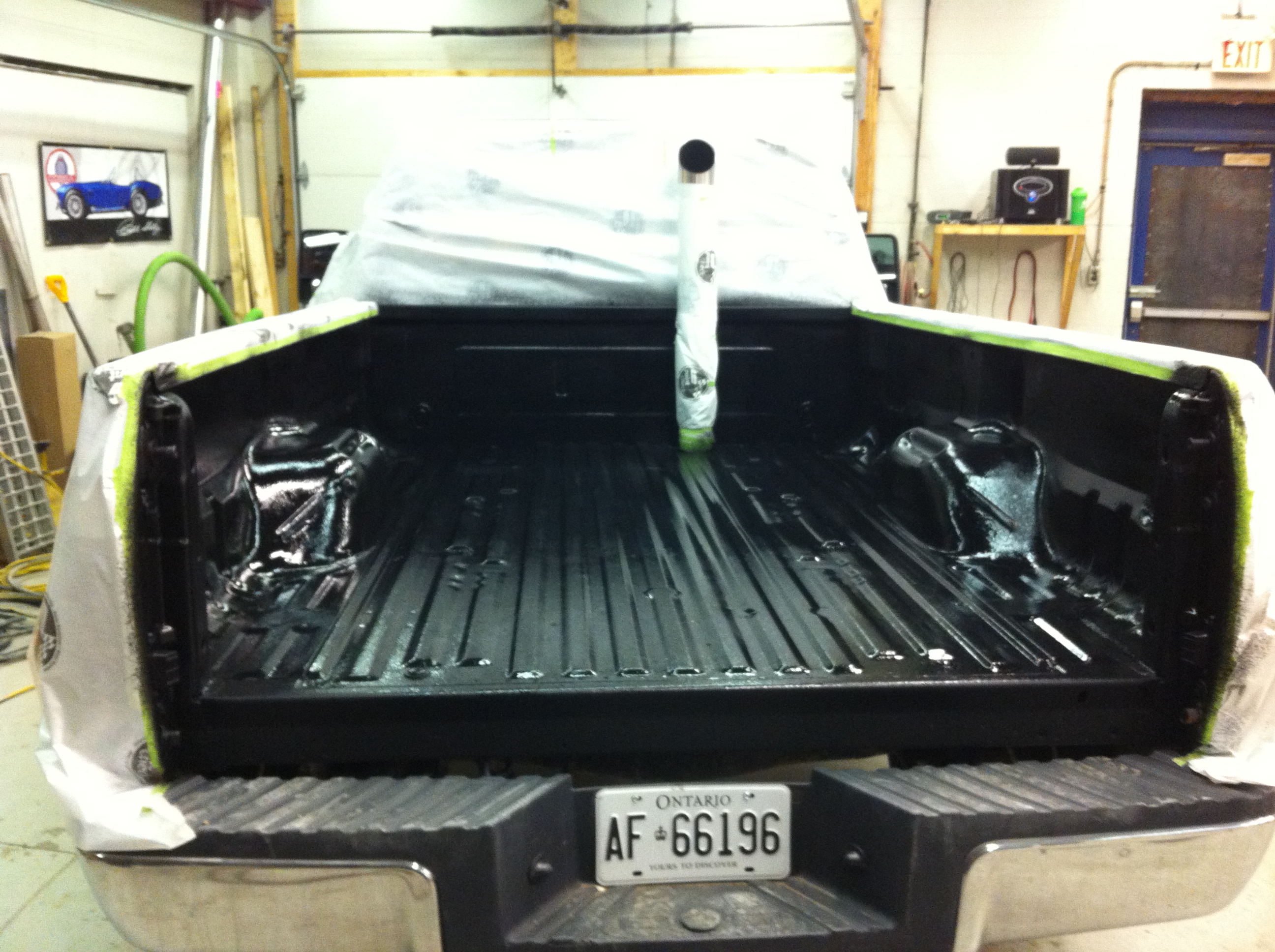

It also got a quick duplicolor spray bomb bedliner at this point to clean things up

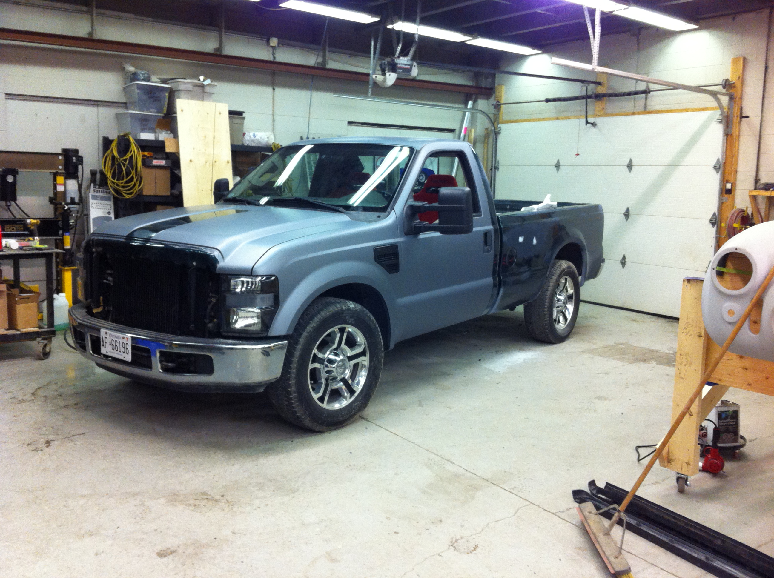

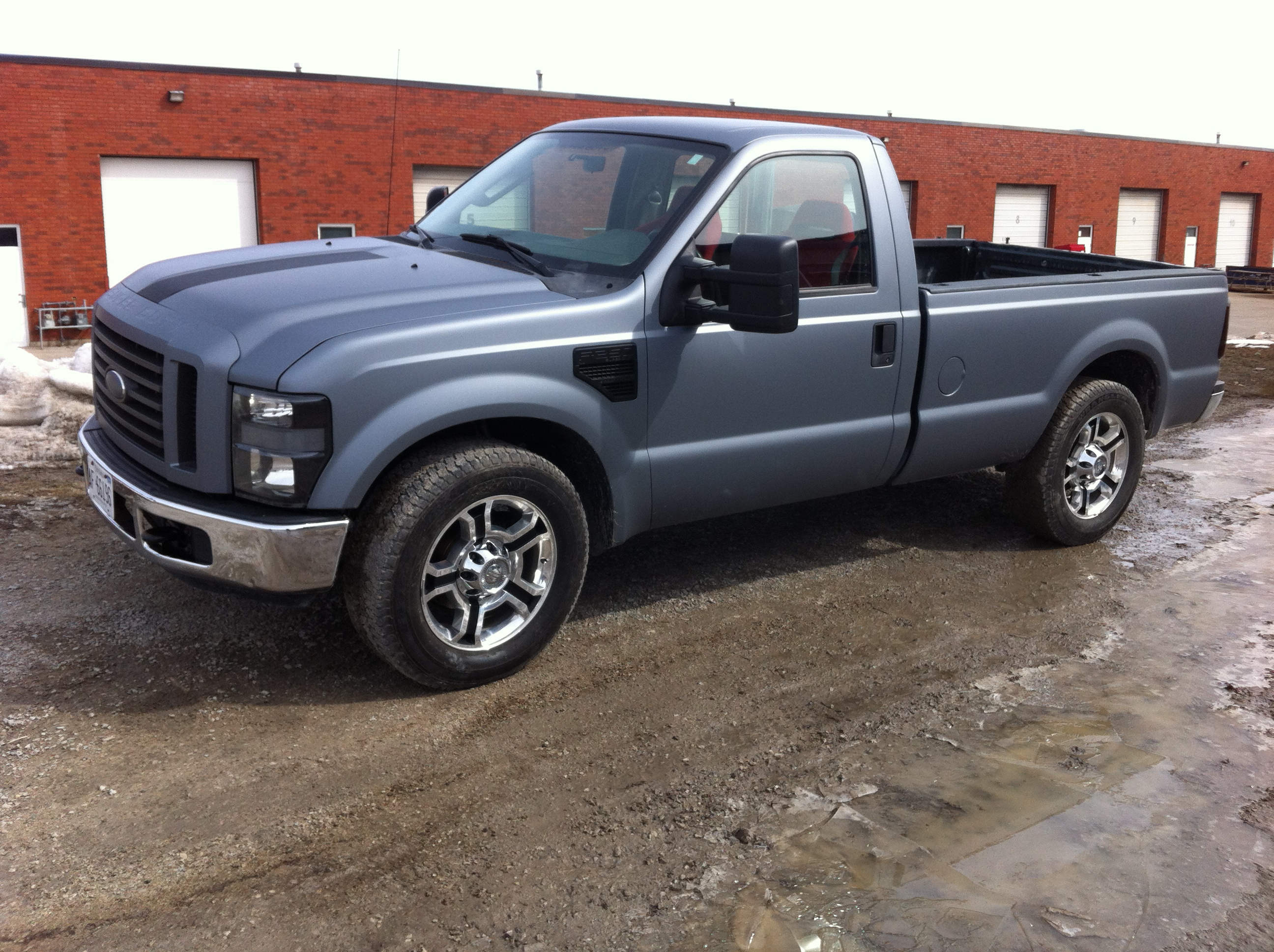

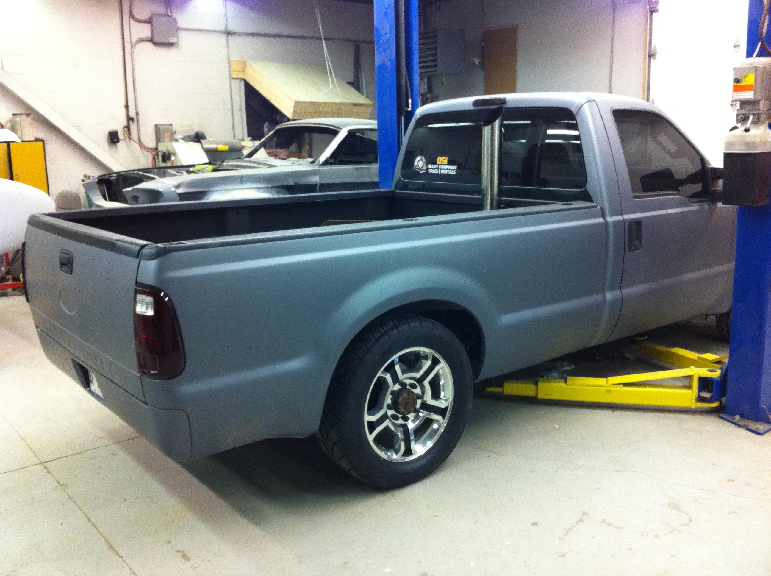

Then it was time for a color change, I decided I wanted something different so 3 buddys of mine and I spend 3 nights wrapping it in 3M Matte silver 1080 vinyl, most people love it, some say it looks like primer but I think it suits this truck perfect, very happy with the results. I also got it tinted with 20% all the way around and sunstrip, aswell as wrapping the tail lights/ 3rd brake light in laminex

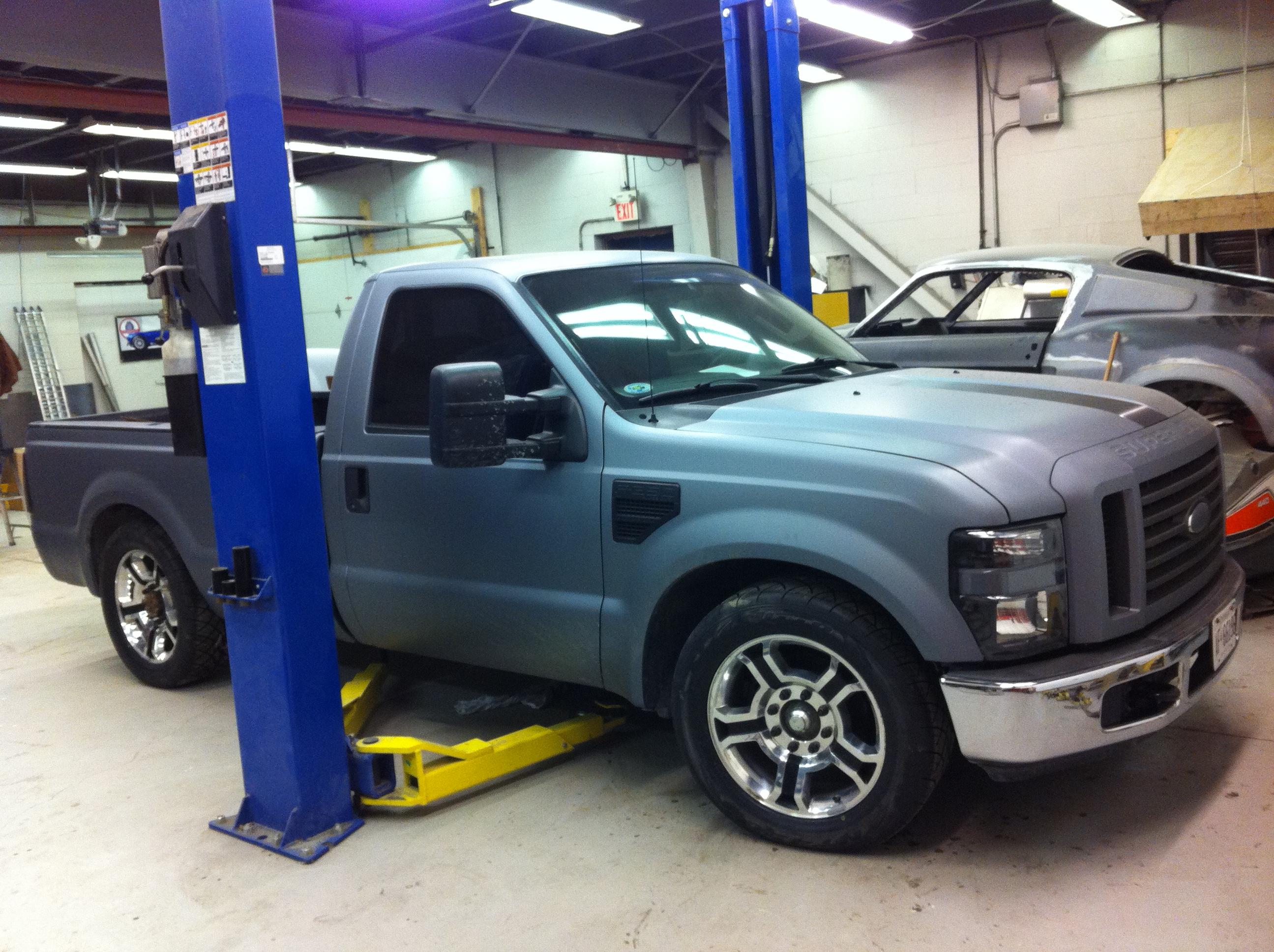

devdiesel
Apr 2, 2012
376
Barrie, Ontario

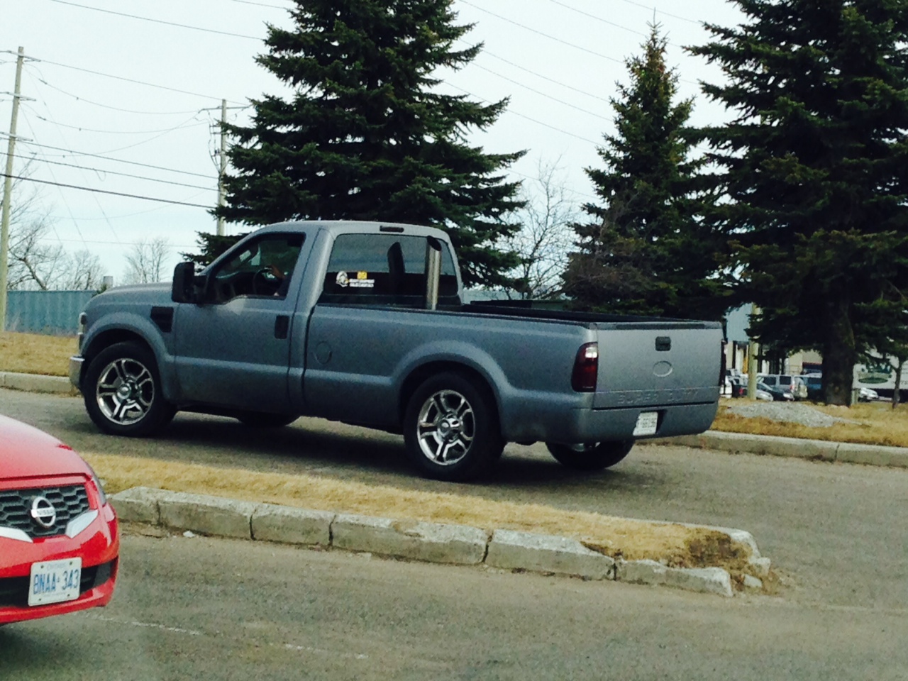

This weeks project what correcting the elevation, the DJM 3-5” drop kit arrived Monday and we went to work again, I also removed the overload and 4th spring from the rear pack. End result is exactly what I wanted, I also had a set of 420’s (305/50/20) installed on the harley rims. And a street scene bumper showed up yesterday which I wrapped and installed, really cleaned up the back end.

Ya it can have a blue tinge to it in pictures, it's much more silver colour in person
