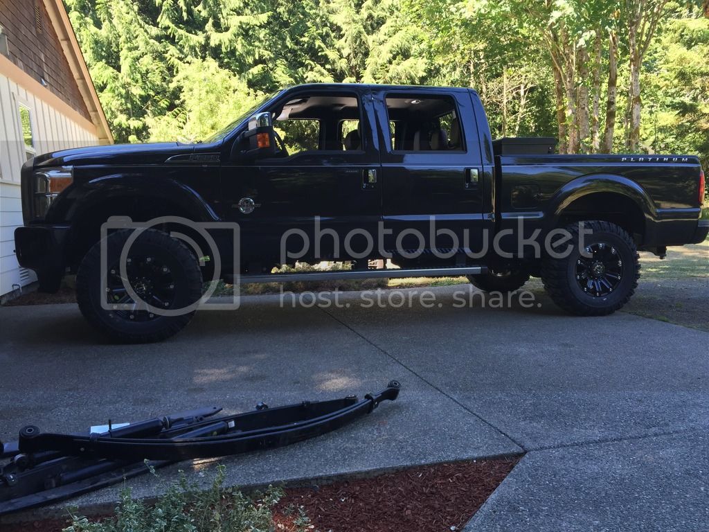

Finished product with the stock suspension in the foreground. The Carli and 35's really make it sit higher than I anticipated, more close to 3 inches of lift, so it almost looks like a 4" lift according to everyone who's asked about it, lol.

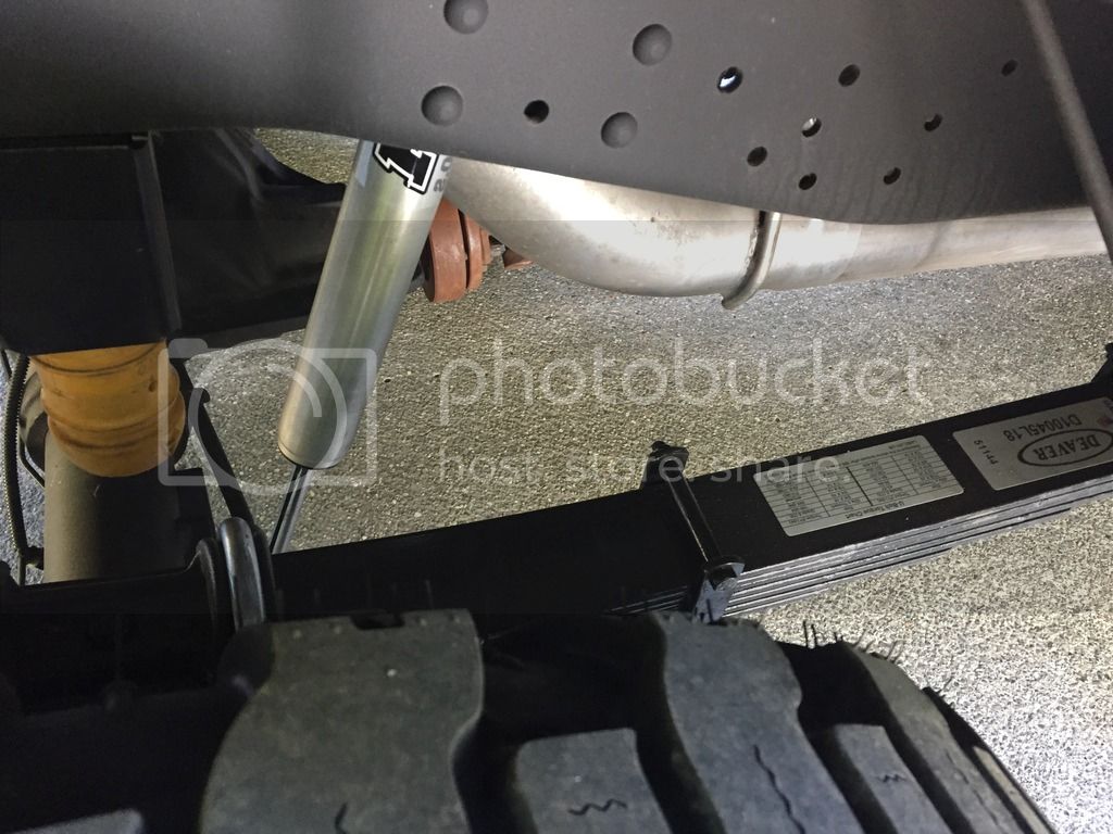

Rear deavers, Fox 2.0's and bump stop brackets. Deavers are freaking heavy, I had 2 other guys helping me and even then we all looked like we'd just given birth after getting just one side in...
A better look at those beef monster leaf packs. Damn things ripped my brand new line-x too, lmao.

Your truck looks awesome! Really badass if you ask me. I am just a little worried however about the height once my truck is finished. Weird how in some other photos I saw of people's Carli-leveled trucks, they didn't seem to sit as high as yours.
I too have 35's, and I chose the leveling kit because I didn't like the idea of a 4" lift. With the Commuter kit I am really shocked to see how high your truck ended up sitting. Do a lot of people really mistake the height for something other than just a leveling kit?

I can tell you that with the 4.5" lift, it's not that much taller. It's most definitely taller, but my 5'4" Fiancee can still get in with the factory steps no problem. You shouldn't have any problems with the 2.5".
UNBROKEN
2,788
I think 2.5" with 35's look great on these trucks. 4.5 with 35's just looks off to me.

I totally agree with Unbroken. My belief is that these trucks are complimented by a 1.5"+ lift/level, and they just aren't acceptable at stock height with 35's.
Randy, I just hope it doesn't end up looking like more than I wanted

I've had guys come and ask if mine is a 6in lift, 4in lift etc. Everytime I tell them it's a 2.5in lift, I get that blank look. LOL

Yes everyone thinks it's a 4" kit, I think it's a lot to do with black truck on black rims, messes with the perception.

Truck looks great man! Could you measure from the ground to the top of the cab please? I park in a parking garage and would like to know the overall truck height.

Anytime, if anyone has questions feel free to pm me. Height from ground to cab is 82" btw.
