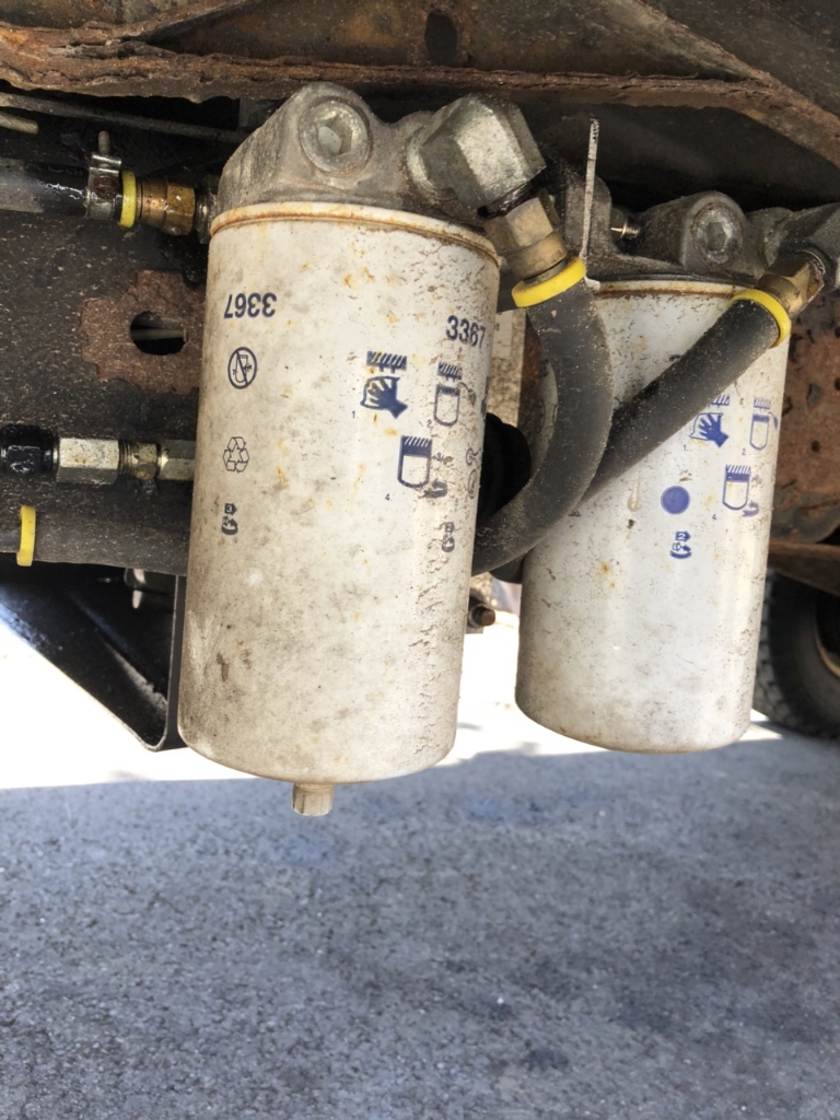

anyone know the correct CAT filter part #'s for E-fuel?
Post and pre filter...
I am using the "Fuga" setup and works great.... came with Napa filters
pre-33367
post-33528
can't find a cross reference to cat.
thanks.

Well,
They are 2" longer and not comfortable with them hanging that low.
they are outside frame rail under driver door.
are far as the #'s
marty quotes cat filters at:
pre-10 micron
post-2 micron
my napas are:
pre-32 micron
post- 2
not sure which is better.... 10 or 32
32 is finer I assume?? or is it the opposite....?

Do any of you guys use an O-ring INSIDE?
while searching for filters I found this in an Amazon review...
Your thoughts?
If you use a WIX 33528 or the NAPA 3528 you MUST install a BALDWIN O-Ring Part # ES24-B BUNA O-Ring on the Center Post,
if you use a CAT 1R-0750 Filter you will need the BALDWIN ES24-D style O-Ring ,
the difference between these two O-Rings is the ES-24-B is Thicker to make up for the deep recessed open end of the WIX/NAPA and Donaldson and similar filters.
The ES-24-D O-Ring isn't as thick because if you compare the CAT Fuel Filter to the others you will see that the CAT filters are almost Flush on the mounting (Open End) and do not have a Recessed center Mounting hole like the WIX and others.
Your thoughts?
This is a real issue. Not running the post seal leaves a path for contaminates to leak through the threads and bypass the filter.
My company has a national account with Baldwin and I buy direct, get to spend time with factory reps etc.
Cat filters are made under contract. Sometimes by Baldwin.
Baldwin was recently bought by Parker. We will see if they ruin it or not!
