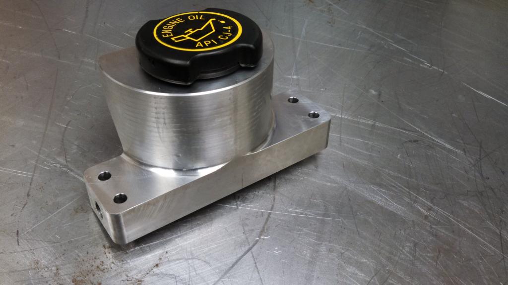

We also have some of the deletes that replace the bulky ccv tank.
MPD makes a very nice one as well !
They will be clear anodized use factory cap and use all factory hardware.
They also are fitted with 1" breather that comes with 6' of hose
that can be ran where ever you would like . The one in the picture is a prototype and is dull and not ball milled or cleared.
I will post pics of new ones in a few weeks if anyone is interested .
Pm for price and availability

Very nice! Clean and simple.

Sorry for the bad pic guys. But I think its simple and to the point. The other side has a nice contur to it with ball mills in the side . It will dress the piece up a bit . The new ones won't be done for a few weeks yet :( . But let me know if I can help thanks for the feedback guys !
