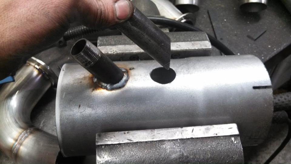

[QUOTE="ncollins64, post: 699545, member: 8604"] i did this on my pipe. cut the tip of the 2 pieces at a 45 deg angle and with the angle facing the back of the truck weld the pieces in at a 45 deg angle. should be the same as in that pic of eriks truck [/QUOTE]
