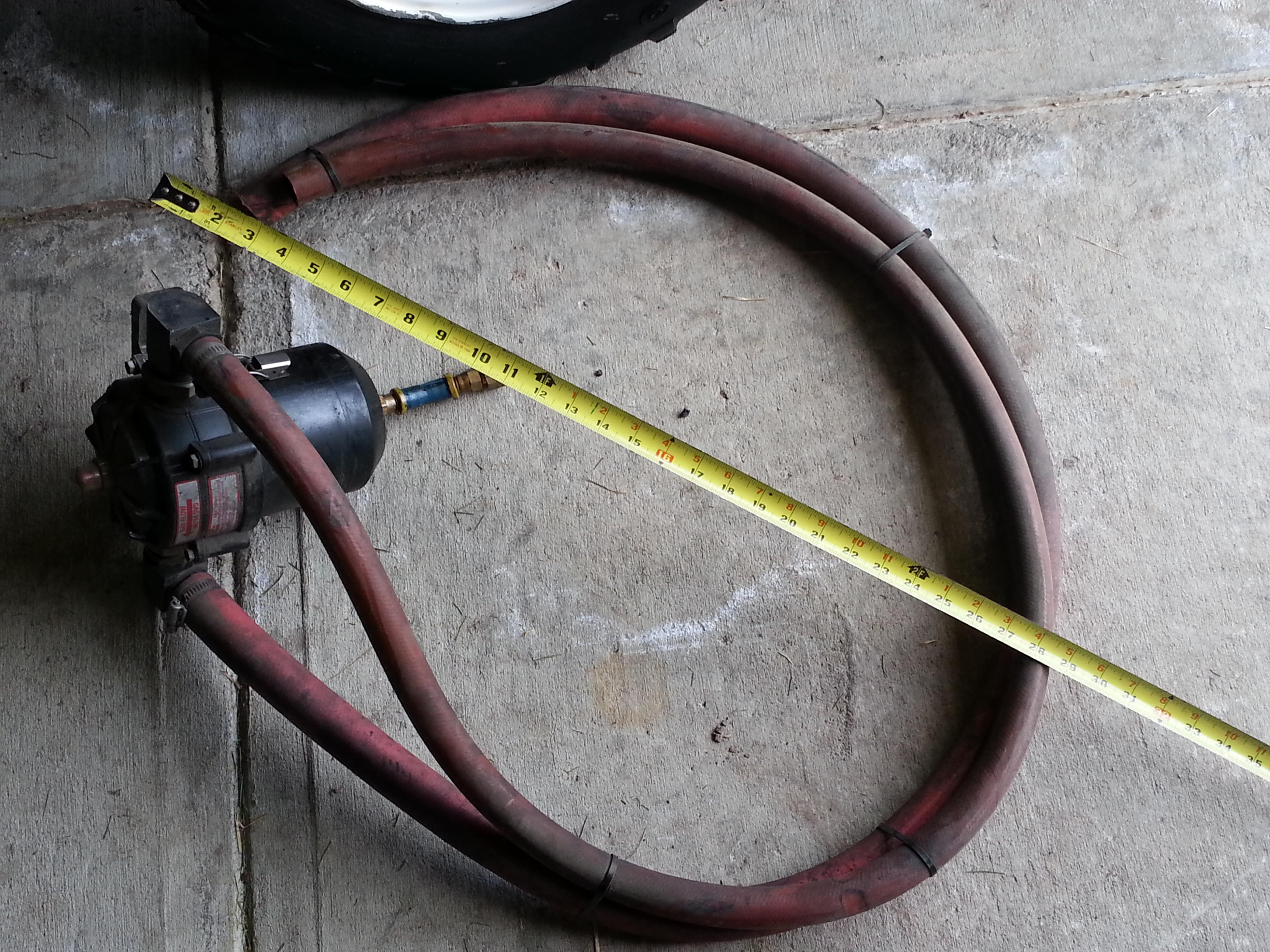

Have a couple of these off of 7.3 commercial vehicles
