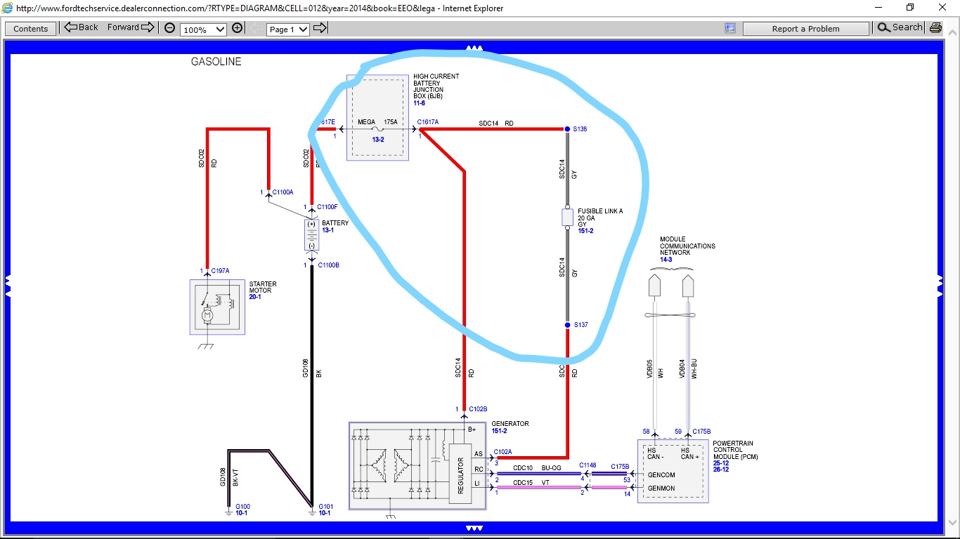

Yellow wire checks out. Red wire should be hot and it isn't. Pulling my hair out trying to ding the other end. Wiring diagram says it goes to a fusible link. But those are all large gauge wire. I have yet to find a small red wire. Can I feed that red wire 12v?
BigRed97
Aug 2, 2011
501
Saugus MA
It's tied in to the fusible link with another large gauge wire. It's there just need to dig a little
Probably 8 inches down from the stud where the large gauge wire connects
Do not feed any wire straight unprotected voltage
BigRed97
Aug 2, 2011
501
Saugus MA
these might help
in the second picture, the fuse link splices are identified in red(lower left corner)
