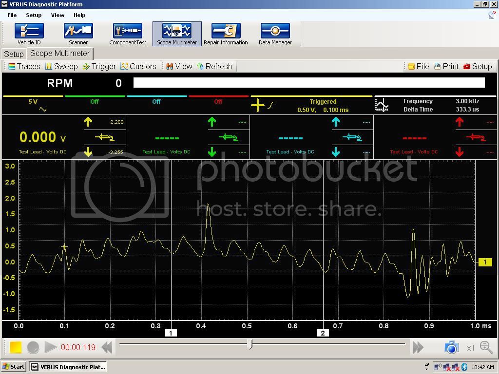

Recently I have been experiencing some shifting irregularity's and some idle stability issues when shifting between reverse neutral and drive, as well as a randomly flashing O/D light. I was able to retrieve a P0720 (output speed sensor) from the PCM and with the truck in park the speed sensor would fluctuate wildly (viewed from scanner).
First thing I did was measure the charging system for A/C voltage using my DMM and there was around .3vac.
Threw the scope on it to get a visual....
Anything above .2 volts A/C should be considered a problem. So I installed a new rectifier and everything is good to go. Keep this in mind next time your truck is acting up.

The rectifier is what converts the AC voltage that the alternator is producing into the DC voltage your truck runs on. When this goes bad you will begin to produce AC voltage.
ALL the speed sensors on your truck produce AC voltage which is then interpreted by the PCM and/or ABS module and then is converted into a signal that can be broadcasted throughout the network for various uses.
The problem is when the entire electrical system has AC voltage, which just so happens to be the range the sensors produce in this situation.
So basically the PCM and/or ABS module are receiving a speed signal from sensors even when you are not moving, or the signal it is receiving when your are moving is incorrect or unstable.
