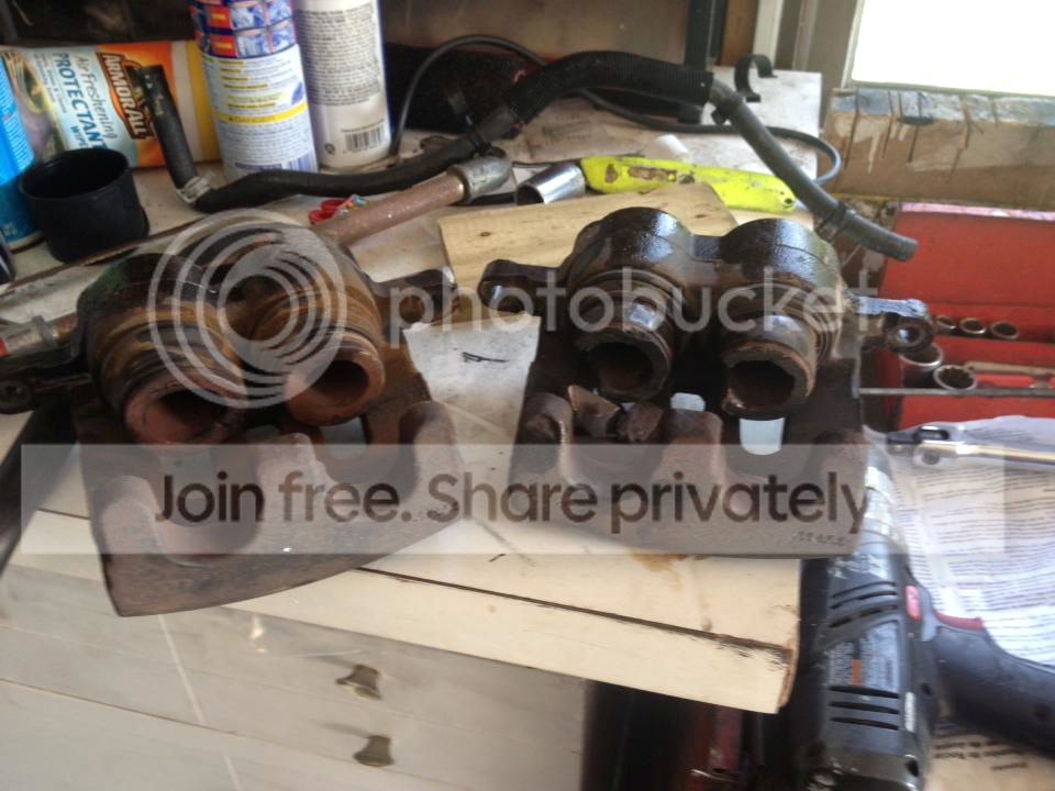

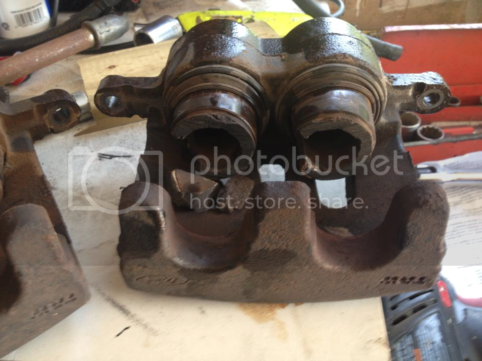

They arent the best of quality....... That is all.
Guess Plastic pistons and a 1 ton arent a good match......

Looks like the rotor was scraping on that calpier? Was the pad completely worn on that side?
Bosshawg600
May 17, 2012
144
Monticello,IN
Truck sat for 3 weeks while I was in California, guess it didnt like that too much....about 200 miles later they started squeeling and discovered this. I guess Im ucky they didnt lock up. But the pads were trash, rotors are even worse.....MI truck, so rust was a big factor!!!!
