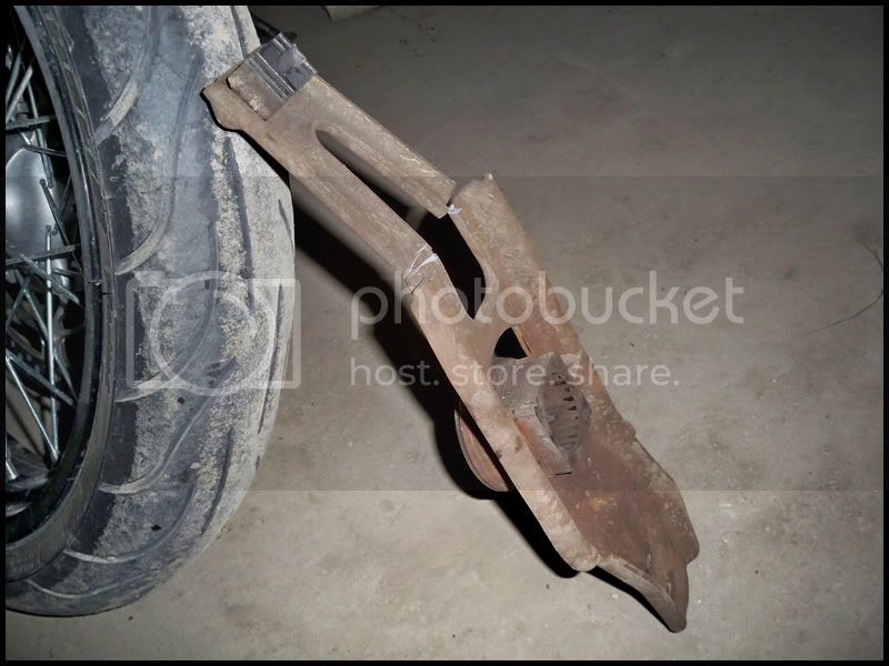

Or bent clutch fork. Mine cracked and broke after being bent and cracked for what looked like a while.

If this problem arose within just a few days then you have a bent clutch fork. Mine did that and a couple more pushes of the clutch and it would only come half way back up. Turned out my clutch fork was broke in half

Edit - also, just so you know, the picture below is where my clutch fork bent and where they all seem to. Just so you have a reference before you drop the trans, should you have to.
