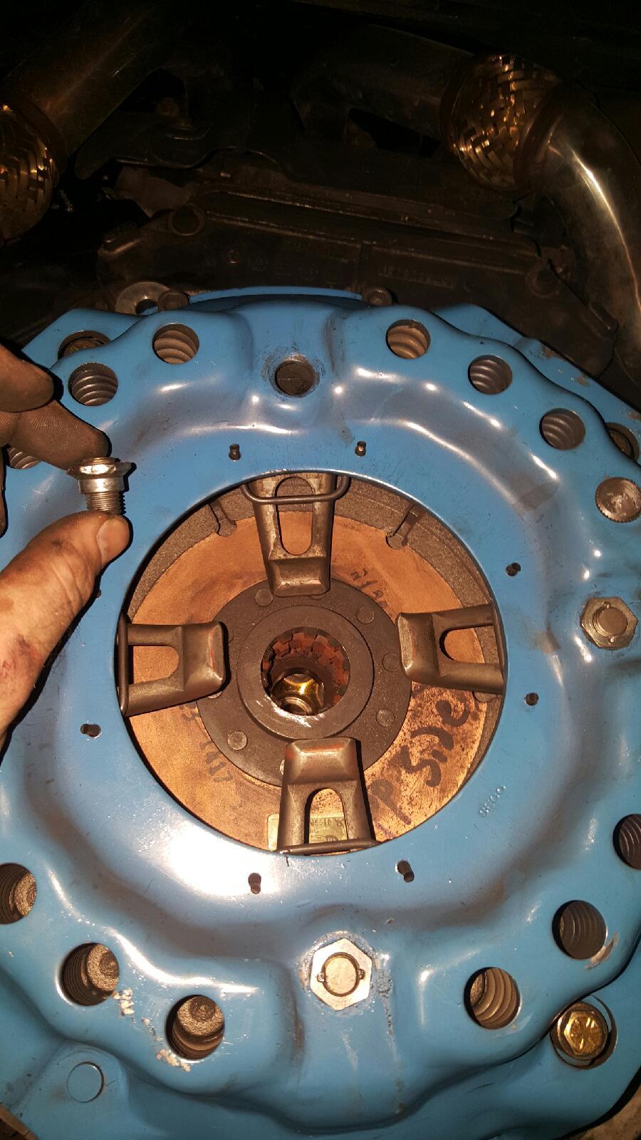

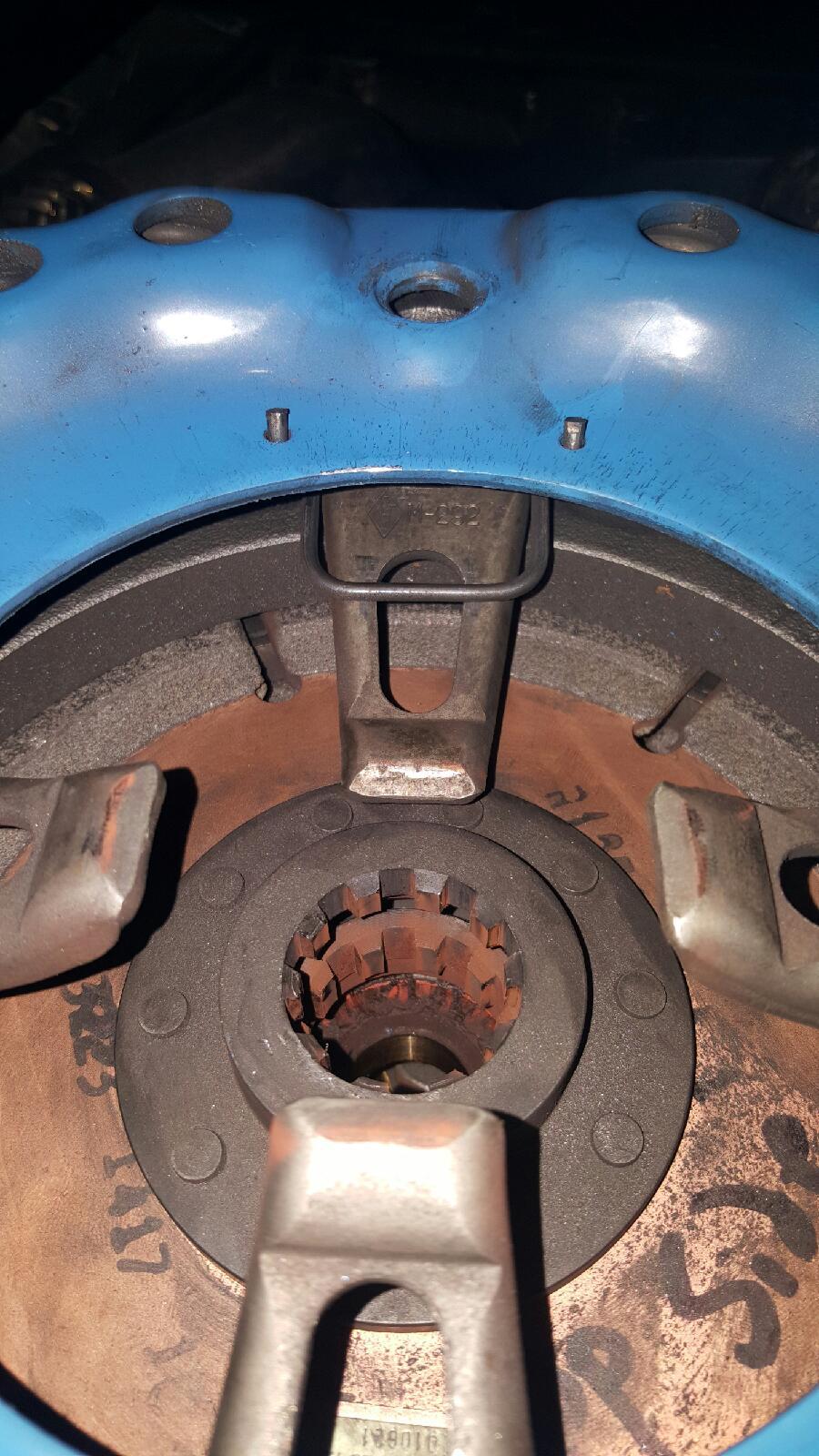

Here is the culprit to my issues. Only 3 of 4 fingers were releasing.

I had to get a new throw out bearing but got the new pressure plate put in shortly after my last post and been clutching smooth as butter since
