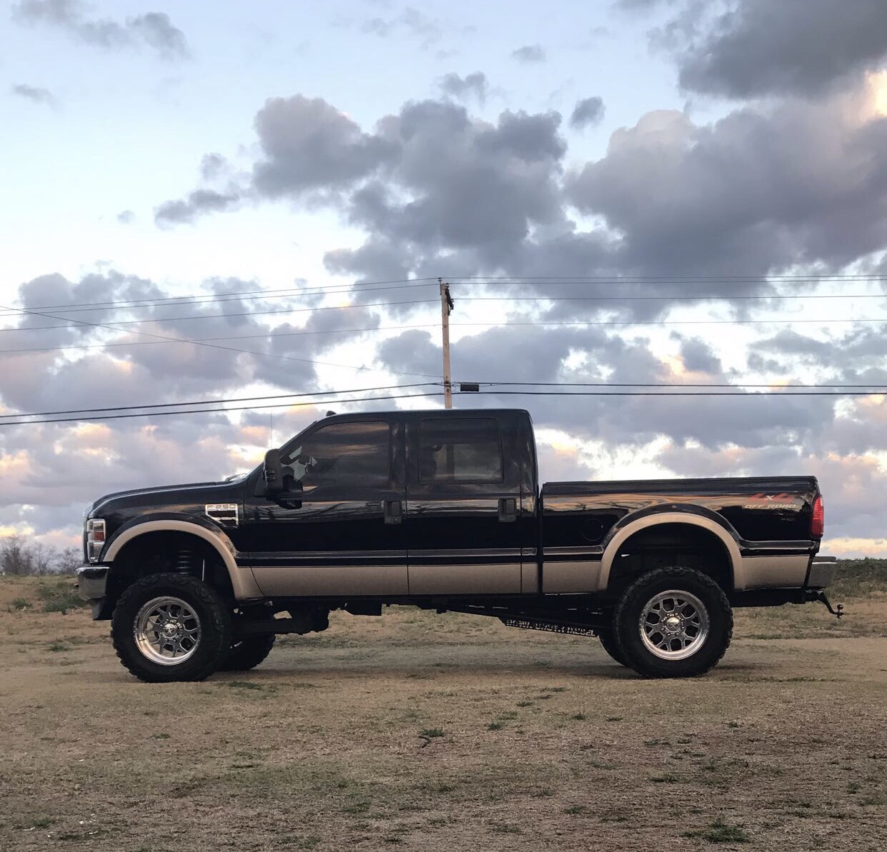

I have a 6 inch lift on my truck. The front sits just a little bit lower than the back. Can I add a 2 inch coil spacer to the front to level the truck out? IMG_1952.JPG

make sure your shocks are long enough as well. form the pic 2" will be too much regardless

Agreed. . Looks like just( 2) 1/4" spacers from pmf will level it out. No other adjustments needed. It may pull the Trac over to the drivers side a wee bit but nothing to be conerned out.
