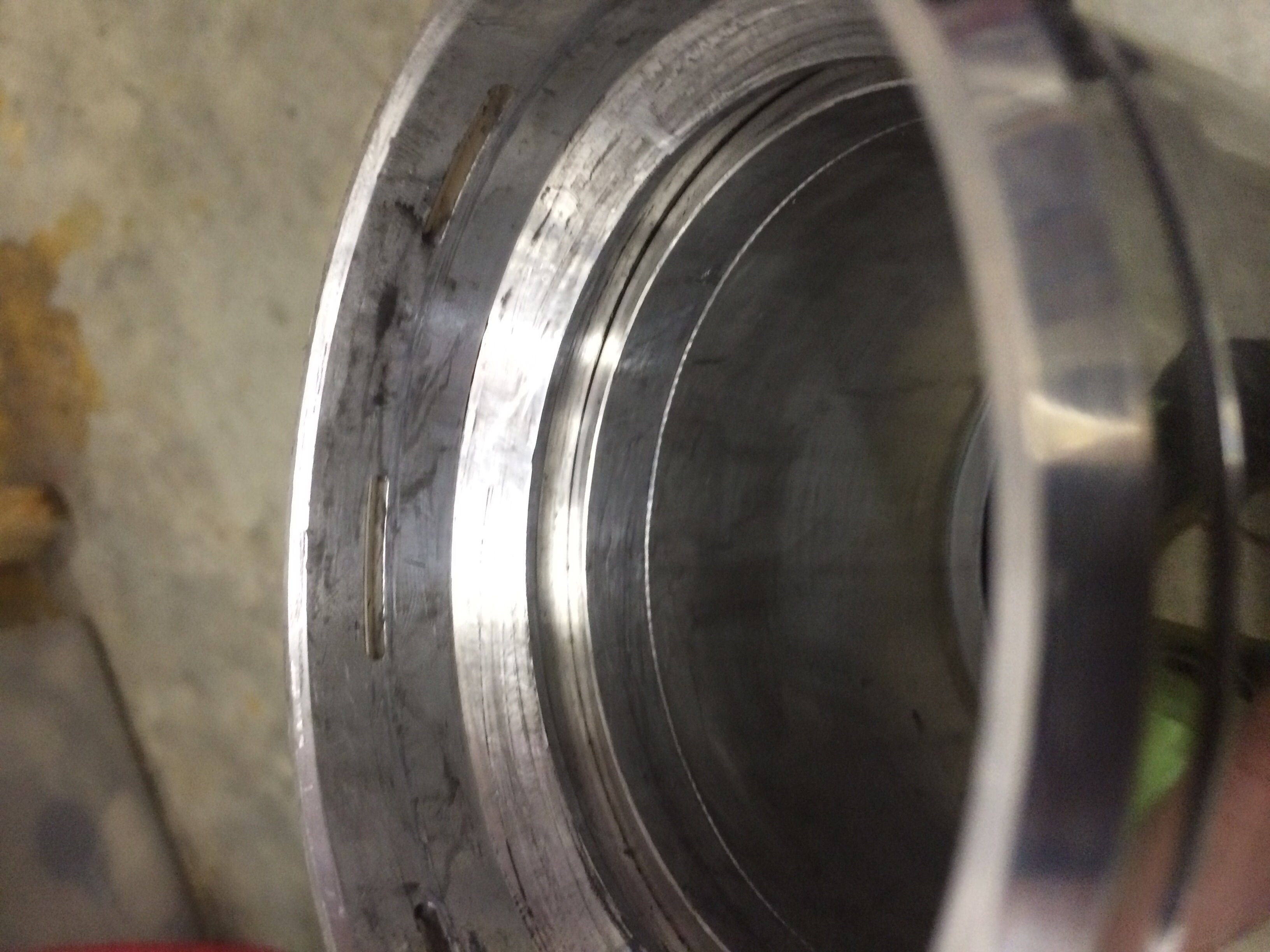

View of the inside. Look at your factory tubing and you'll see what I'm talking about. The overall shape and diameter is no where near close to what it should be. Its too large.
Also, speaking of the sensor bung correction they made, the o-ring wiggles around, along with the sensor, and doesn't seal properly.
Mishimoto needs to realize how much this can affect the truck.. I got 4psi max last night and tons of smoke. Sensor plugged in as should be.
Then late in evening after so many failed tests, Put the factory tubing back on. Right back to 32 psi max!

The EGR throttle body is the same on my truck as well as my friends 15. As well as the factory plastic pipe assembly. So is the O ring and the internal white plastic clip.
Also note that the sensor bung port of the pipe is slighty larger than it should be. Even a new factory O-ring wouldnt work to keep the sensor from wiggling around and air escaping through the port. I have already purchased an aftermarket O ring thicker to make this work. That sensor plays a huge role in the 6.7s and any slight change or air leakage affects performance.
As I said before in my PM, I am getting the coupler you sent and my EGR throttlebody custom fabbed together, (to ensure there are no air leaks) as we speak because I can no longer wait, And I use my vehicle for work and transportation. I'll have to pass on the replacement kit and I appreciate your time
