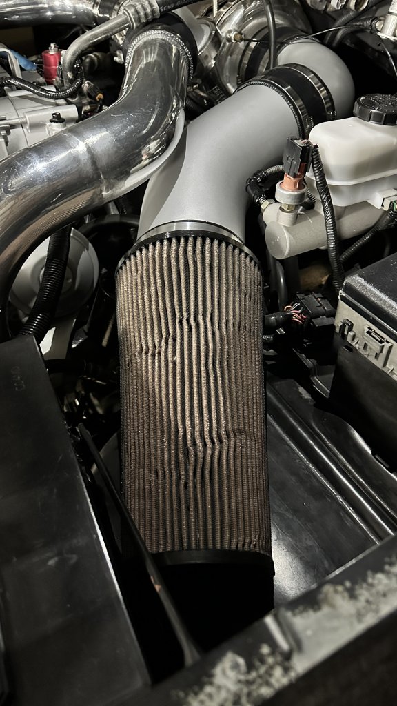

Need help finding a filter that won’t collapse.
I currently have a 5 inch inlet all the way to my turbo from the filter.
Running a S and B that’s brand new, picture below.
So far all I have done is suck the oil out of the media and collapse it.
This filter may have 500 miles on it.
I need some options for different filters.
Has to be a 5 inch inlet.
Don’t care if it’s a dry or wet style.
Some off-road, mainly weekend use.
Precision 76/85 and 350/200s are flowing well apparently 😂.
Thanks yall

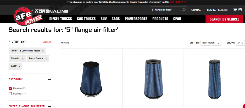

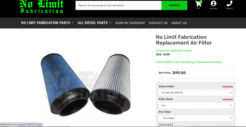

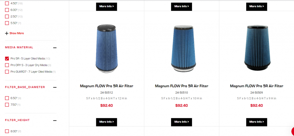

Try No limits fabrication, or go to AFE's site and check them out. I have had good luck with the AFE filter I run on my 6.4 with 71/59 turbos, no problems with boost up to 40 psi.
