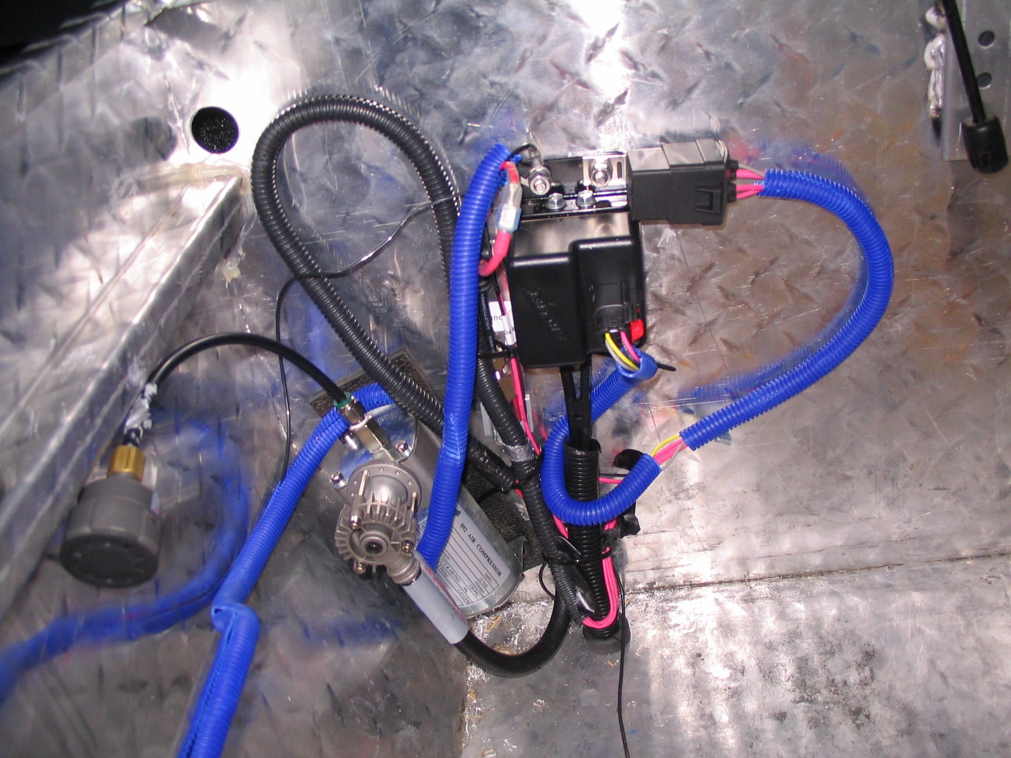

lets see where you are mounting your compressors.I am thinking of puting it in the tool box to keep it dry. but i would like to see other options. I have the air lift 72000 kit.

I ended up mountiing it in my tool box.and a pice of rubber under the compressor to deaden the sound.
