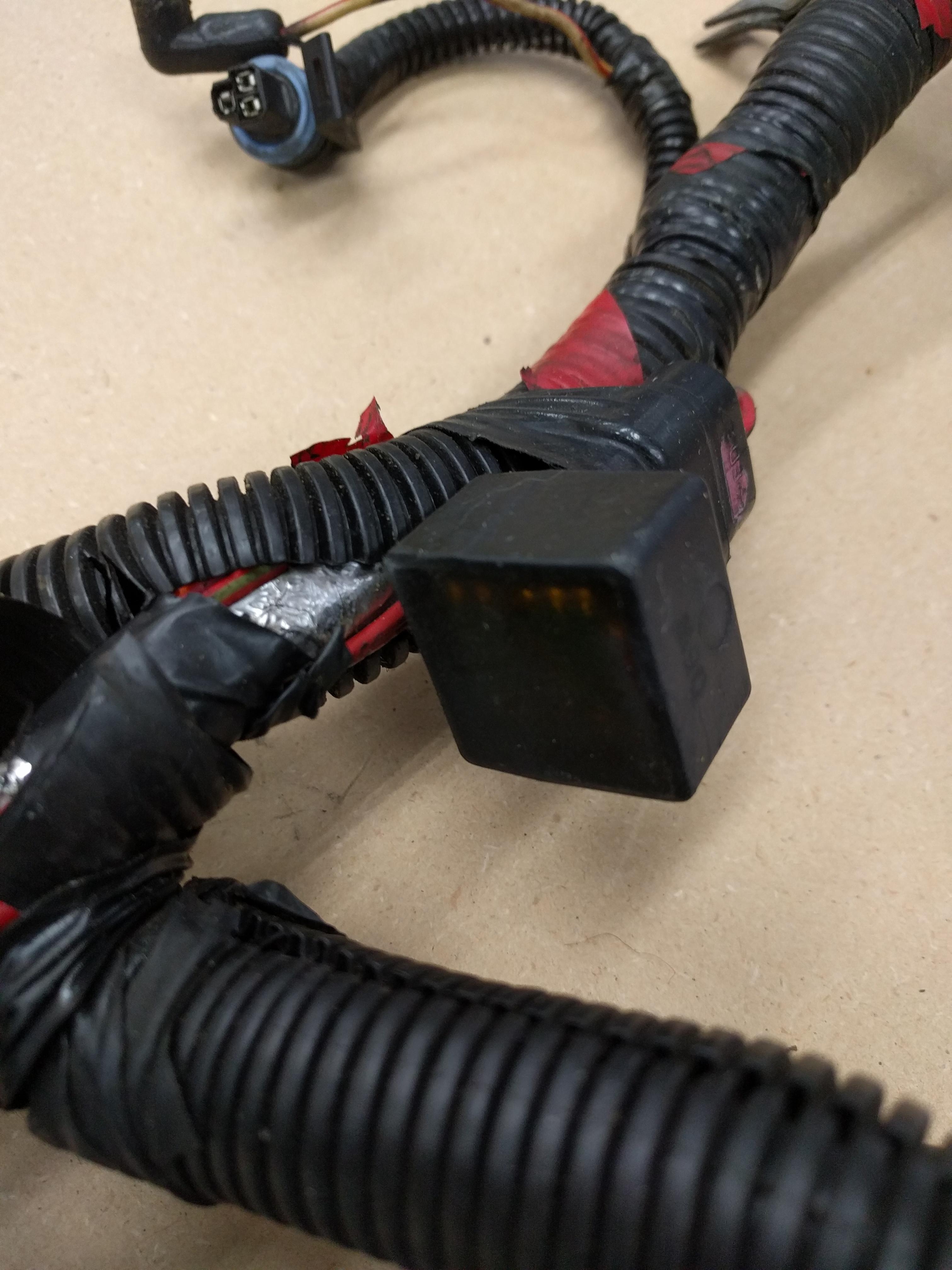

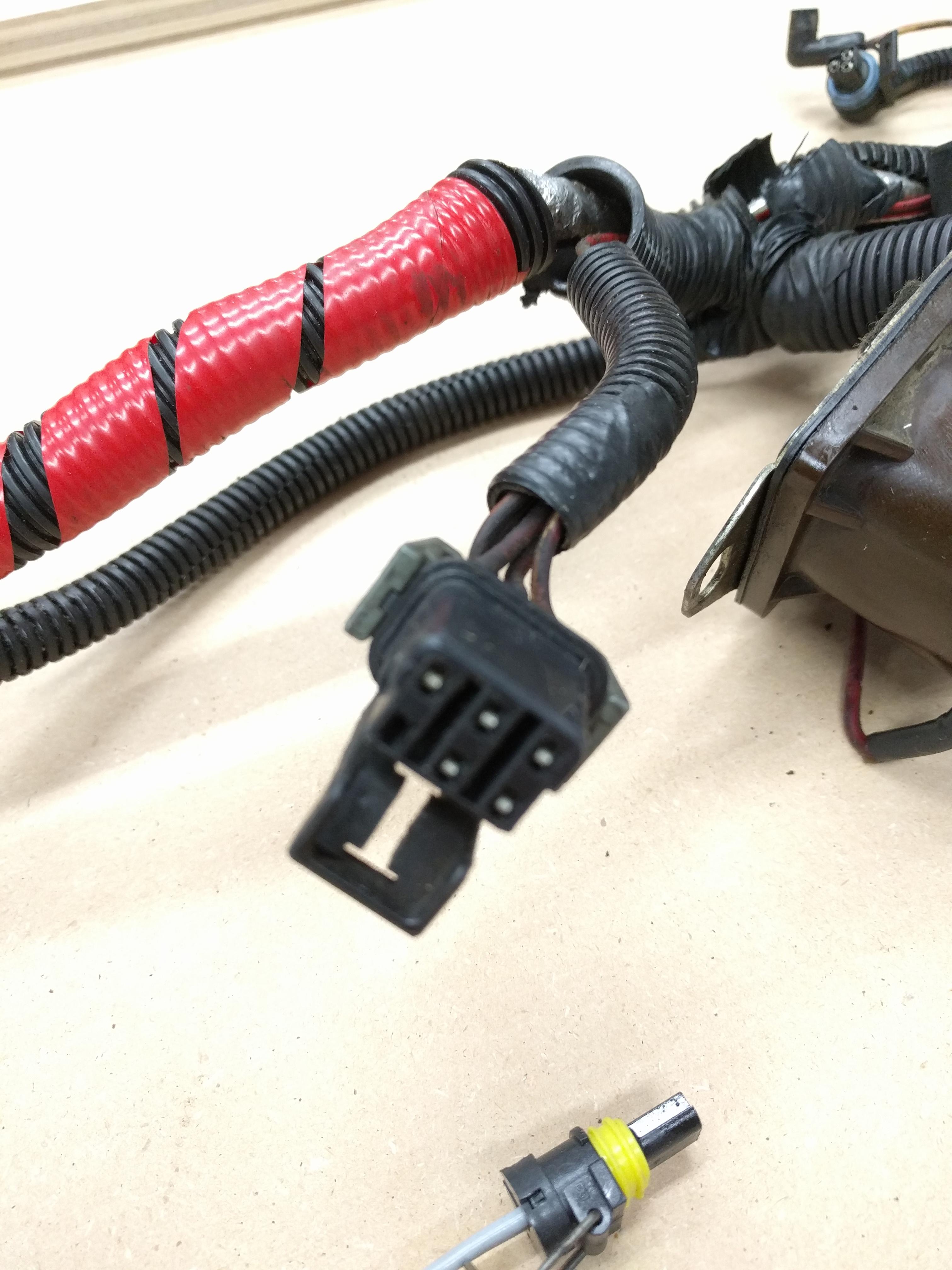

Hi all,
I am just finishing up some last few items after spending a year upgrading my engine. I had pulled the engine and harness and now I am stumped at what this connector goes to. I did replace the IPR but it has a 2 pin connector now. Could this connector have gone to the old one, which was 5/6 pins? It looks like at least one wire runs back to this black box. Is the Black Box the Baro Press Sensor?
Yep I should have labeled and taken more pics.

Yeah, that's the fuel bowl harness, which includes the ipr.
The BARO sensor is usually under the dash. That's a solid state relay for the water in fuel sensor.
