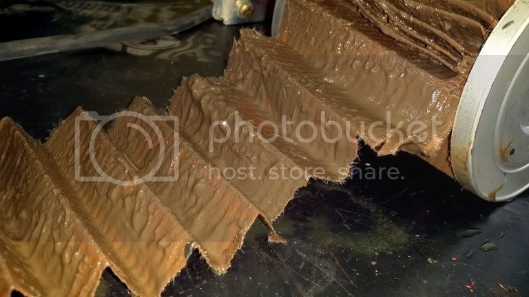

this is what I had in my filter before I did the ELC swap... 1500 miles on this filter...

YEP that is EXACTLY what I am talking about. People wonder why IH required bypass filters built into the pump and also why FORD did not. Ford wanted all the extra out of warranty work and to also save money upfront on a cheaper as in likely 1/2 the cost pump. Think of the millions they have made off just pump swaps and part markups.
