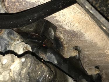

Hey guys I noticed a constant coolant leak on the passenger side of the motor while it’s running. Took a picture here see if you guys have any ideas I would really appreciate the help. The truck is studded and ******d.

It even leaks while the truck is turned off but not as much. It’s towards the rear of the motor

Nice 6.0 manis,
Check the water outlet tube from front cover to the passenger side head could be cracked/leaking at that fitting to the heater core
