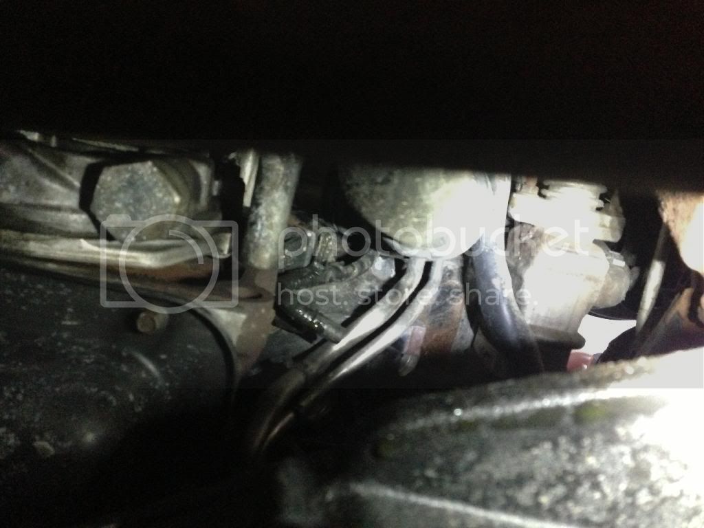

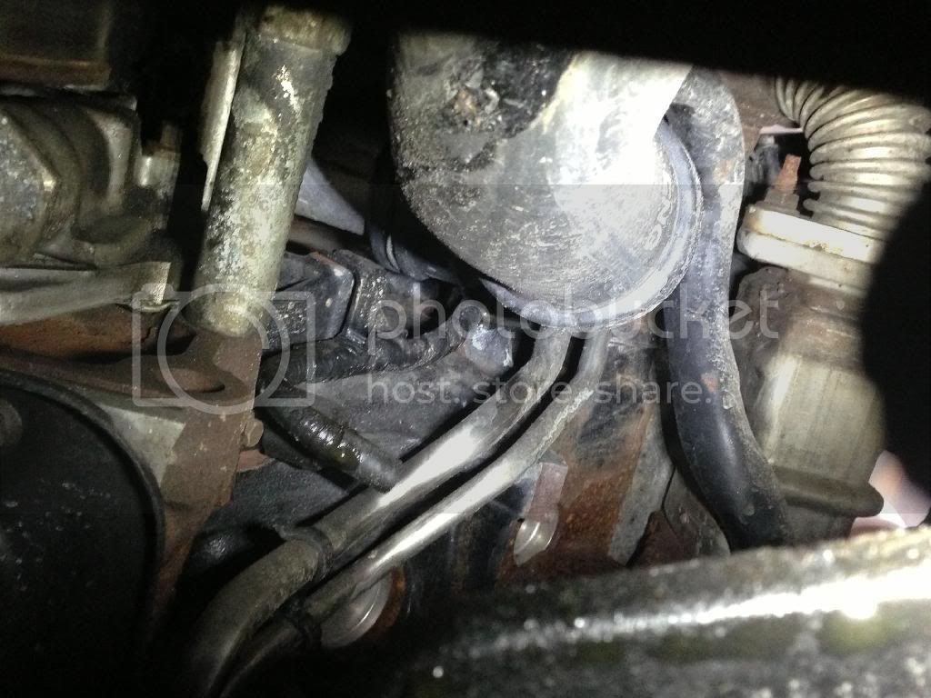

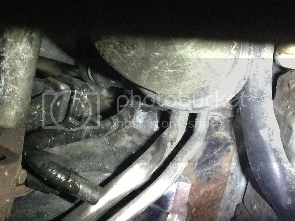

so my truck started leaking a little coolant, its not a lot but it shouldn't leak any.
that's where its leaking, I tried locating it from the top and can't see chit, any ideas what that is. whatever it is it goes to the block. i'd like to think its something egr related, but i can see the cooler on the driver side and its dry all around, so i don't think that is the case for me.
thanks in advance.

I am thinking that it is the radiator hose leaking. If you don't have the updated radiator hoses that have two O-rings in them, that should take care of your problem from what it looks like to me.

man i hope so, i've been told they should be white on the engine side, I quite positive they are black, was that a recall or anything, either way its under warranty from the place i bought it, and ford so i shouldn't have to pay to get it fixed this time. thanks!

:rockon:That would be the first place to start boss.
not me, but a tech at A:the dealer I bought it from 45 days ago or B:ford because it is under warranty from both currently. :ford:
That's your problem. Done 5 sets on 6.4s recently. The leak looks identical.

When they put in the updated hose, they can see the EGR cooler pipe that's behind it. Sometimes that O-ring will leak, bur usually after it's been messed with. Most likely the updated lower hose will take care of your problem.

I have done a few sets and the leak location and amount looks identical to some I have seen. Get the updated hose and since they are going to exchange the old coolant with new coolant under warranty you could pick up some of the CAT coolant and not have to worry about many cooling issues down the road. Depending on if your dealer will let you use your own coolant since they are the ones doing the coolant exchange.

well I dropped it off at the dealer this morning, they finally got it in and found the leak, its actually the upper radiator hose, but they ordered one, and it should be there monday, and they should get it all buttoned up in the mean time they gave me a sweet ford focus to drive....:biggun: :tree: the thing understeers like a bitch wagon....hate it....I feel like I had my balls chopped off, can't see over anything. and everyone is taller then me which is tough for me because I'm 6'2 not too mention its a small car...doesn't stop for **** compared to my truck....
