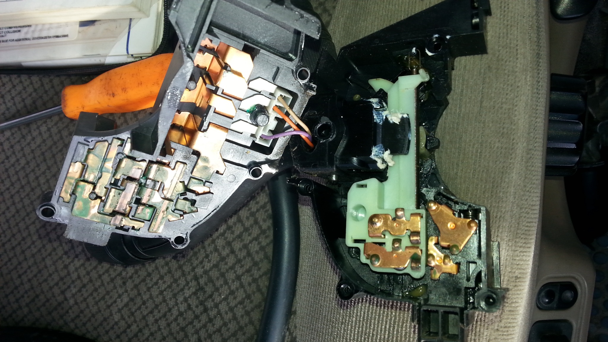

I pulled the multifunction switch. My truck being an e99(feb98), uses a '97 mfs and I couldn't find one so I disassembled mine. The corrosion blew me away. After some serious "remanufacturing" I reinstalled it.

Here is a picture of my MFS.
Yes it was still working but I was hell bound to find any reason for issues and thru testing, research and i guess some luck(like I said it was working),
I found this. You wouldn't think it could work with all that corrosion.

Very impressive write up. I know some of the words! Lol. I actually have extensive training in automotive electrical diagnostics as well, not nearly on your level but enough to follow what all you did and be suitably impressed!

Ummmm....grounding the mfs? Or shunts? Can you go into detail a bit more?
Did the shunt correct the issue or was it the cleaner mfs interior that fixed the issue?

The issue seems to have been associated to the wiper circuit.
Was it because of the corrosion in the MFS, I believe so but I'm not positive which is why I wanted to go into so much detail and post this.

I think I follow...how did you clean your mfs? Did you put grease in it upon reassembly?

Disassemble the MFS carefully. Pretty easy just 4 screws. There is a slide in there that has yo align with the lever.
I used 1000grit to clean it as you want it cleaned/polished without scratches.
Yes I used a light coat of dielectric grease.
