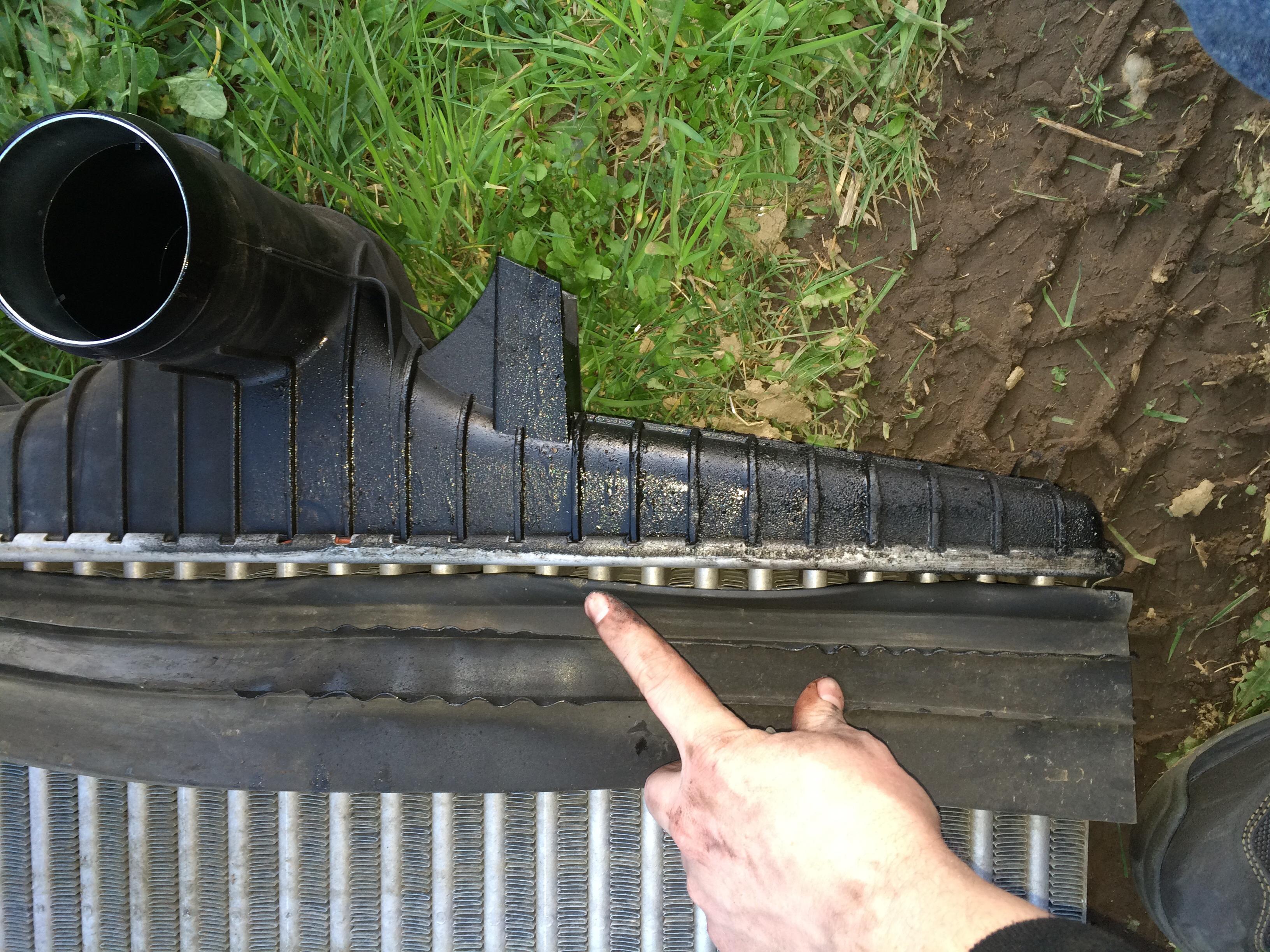

Well long story short my intercooler has a crack on the factory plastic bs and I need a new one. I used to be able to make 32psi with my tune, now im lucky to make 23... I really dont want to spend more than $800, Im looking at my options and dont want to go back to factory. Suggestions? I can see that it's hard to find these for cheap. thanks

I did talk with Alradco and he was going to give me a swinging deal but a friend of mine got me a fully welded aluminum one for $425. My original blew out a deal between the aluminum and the plastic which is where I saw the oil coming from.
Now all my lag is gone and it rips!

Can't beat that man, Congrats on the score
