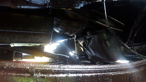

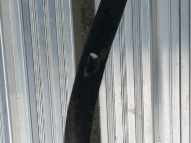

This honestly has me puzzled and I'm hoping some of you may have some input. I posted on the nation as well but not getting much feedback there. Bottom end of engine is intacked and all seems as it should be. Hi pressure turbo is shot and as you can see the oil pan blew completely off but nothing hit it. When pulling the turbos I did don't the tube for the ebp sensors had worn a small hole in it. I'm leaning towards a cracked or hole in at least one piston and the back pressure from the turbo blowing blew the oil pan off? I will know for sure this weekend when I get the engine out and pull the heads off. Truck is ******* tuned with the 275 file and the normal mods. Thanks in advance for any help and advice.

an oil pan doesnt just blow off. theres like 20 bolts holding it on. looks like a rod came out the bottom of block. have you stuck your hand in the oil pan to see what you can pull out?

Yes I have nothing hit that pan the crank and rods are all fine the truck would even turn over and run. I can assure you the pan did just blow off.

Excess crankcase pressure would push out a rear main seal or something else long before it just blew the oil pan off. Either someone loosened all the bolts holding the pan and they rattled out or something hit the pan with a lot of force.

I know the picture is not that good but you may be able to see the pan pulled so hard that the bolts pulled through the pan and the bed plate broke around the perimeter.

There is no way crank case pressure got that high to blow the pan off, the glow plug harnesses would have blown out releasing the pressure first. Something broke, you may not see it yet but something definitely broke.

Keep us posted when you find what it is, I am very curious. I have seen lots of failed 6.4s but never seen one drop the pan like that. Is the upper oil pan still in? Or did it come down also? Take a pic of the bed plate when you can also, good luck with it man.
