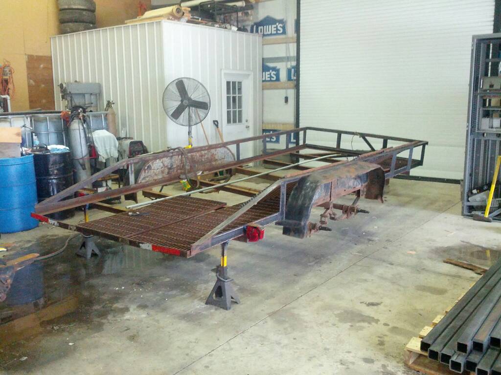

Bought this POS over the winter and figured I'd refurbish it a bit, try out the new welder, and stiffen it up too. Had bargrating for decking. Man was that wobbly going down the road. Bunch of broken pieces, worn out bushings on the running gear.
6hrs and I'm to this point.
Thinking about adding a dovetail too, but not sure yet.

Made it this far on the trailer tonight. Got to stinkin cold. Fenders made, dovetail installed, jack installed, rebushed the running gear, made new 3/8" thick spring to equalizer links, and a few other little things. Old links were only 3/16" thick.

The dovetail just makes it a lot easier to load small equipment and not to have such long ramps.

If you're gonna take it off the road onto any kind of rough terrain, forget the dovetail, it will drag on every hump you go over.......I removed the dovetail my trailer had on it and made some longer ramps that fold in half.

Looks great so far, it's amazing how well some older beat up trailers clean up with a little bit of time and the right tools.
The only thing I would change with what you have done so far, is using angle iron or C channel instead of tube. Tube turns into an ugly thing after it has seen some salt for a few years.
