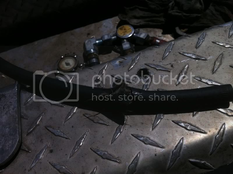

I wanted to just provide an update - I was an idiot...
Think that caused some restriction?

Enough of a mess that someone called West Metro Fire thinking I was gonna blow up the gas station... With diesel... The gas station is right outside the Fire Department... Quite funny...
With that one - no taste of diesel. Got a little in the eyes and ruined some work clothes... Otherwise wasn't too bad. I designed the box, wiring, and plumbing to be able to drop as a single unit with quick connects (electrical) and JIC plumbing. If I hadn't had to wait for fuel line, it would have been a 45-60 minute fix.
