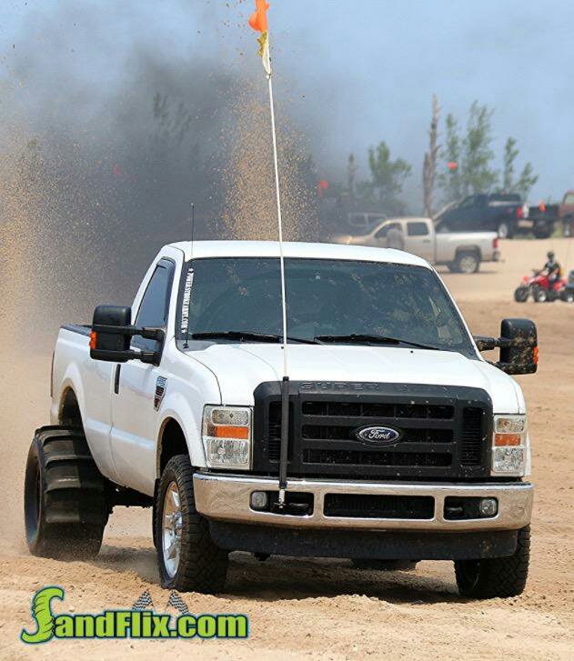

The truck in its work form.
In pulling form.
In dune truck form.
Sent from my SM-G920V using Tapatalk

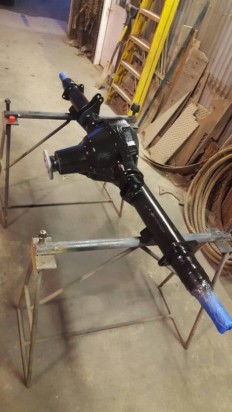

Dana 80 with welded tubes in primer.
Ultimate Dana 80 cover with tube brace option mocked up
Painted
PMF blocks for the Dana 80
RCD stainless coolant tubes
RCD aluminum oil pan
We're the last major parts I was waiting on Friday. And as promised Trevor and Darrin pulled through and got them here before last weekend.
