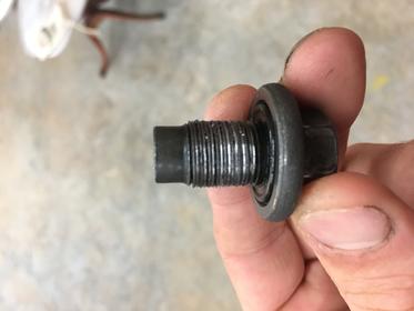

Guess I should have just skipped the free oil change...
From the looks of this drain plug (and how hard it was to get out) Ford is about to put a new pan on my truck...and pay for the tow over an hour away!

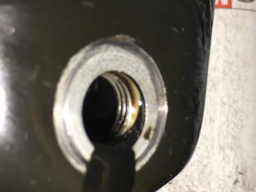

First two or three rows of threads gone...

I bet they will say they didnt do it, and you have no way to prove they did it other
than you saying you didnt do it some other time.
The free stuff is not done by some experienced mechanic....

Yep, been there done that. Hopefully they take care of you on it. When it happened to us, they pretty much told me it wasn't their fault, and they wouldn't do something like that. Basically, go pound sand. Stopped using that dealer, went on up 75 to a different dealer. Went good up there for about 5 years till one day they left my dipstick part way out. Over the course of the next 5,000 miles, oil blew up that tube, sprayed oil all over the top of the motor, hood...........etc. Now this dealer claimed no responsibility, offered to wash the motor at a discounted rate, but that's it. All oil changes are in house now.

Think there gonna try and retap the pan instead of replace it?

Not if the first threads are stripped and missing. I would make them replace the pan. Especially if the drain plug can not be torqued or sealed right.

I would try to get them to replace it, or use it as a good excuse to go aftermarket pan.
My drain plug on my 16 came from the factory with thread issues. It's always tightened up and stayed. It's like half the threads are a different thread pitch, if you know the feeling. I'm the only one that had ever changed the oil, so i know it's a factory issue. No, I never used anything but proper tools. Have seen dealers use impacts on drain plugs, oil filters over tightened, never worth the free oil change.

Sorry for the late response...no, they put a new drain plug in it and said that it wasn’t missing any threads on the pan and basically that the new plug would “re-tap” the pan...
Service manager said it “is normal” and “happens all the time”. Told him that the 50 or so ‘12-‘15 trucks we have where I work have never had an issue with drain plugs. He could tell I wasn’t happy and I didn’t leave until it was documented and a copy was in my hand. So if I have any issues they will be replacing the pan.

ok haven't see a new drain plug but by the sound of it it cuts new threads in the pan/bolt what happens to the metal chips ?
