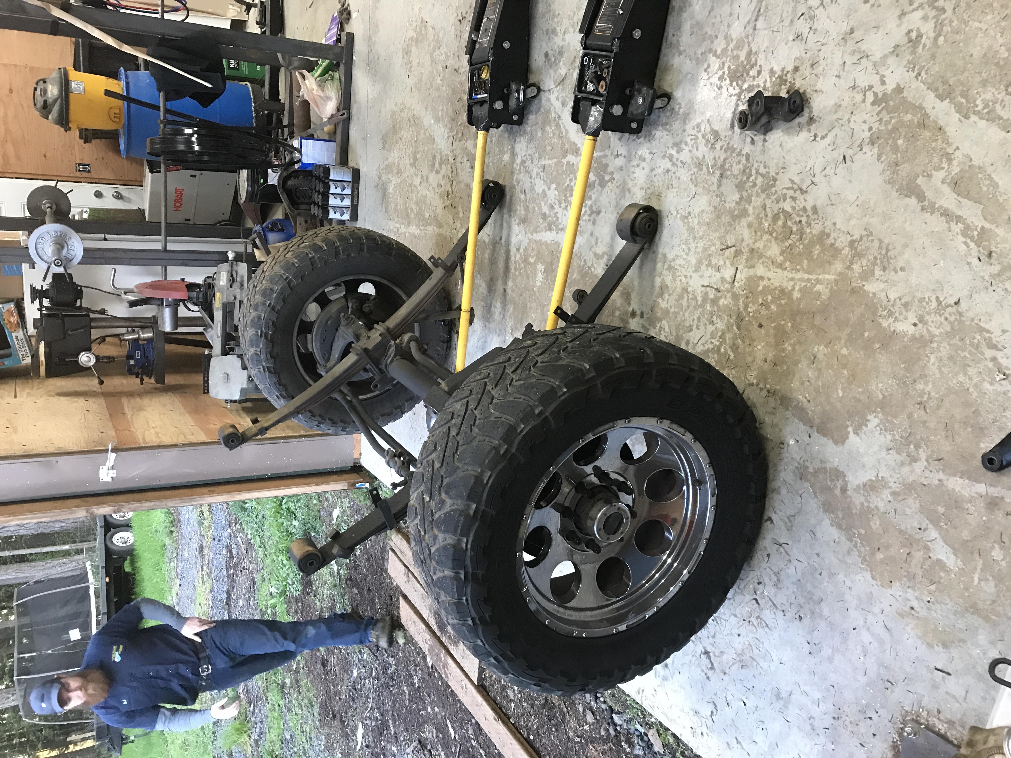

Military wrap goes in the front, big eye let in the back. I'll attach a photo of when I took out my d60

Picture of the axle unbolted and rolled out

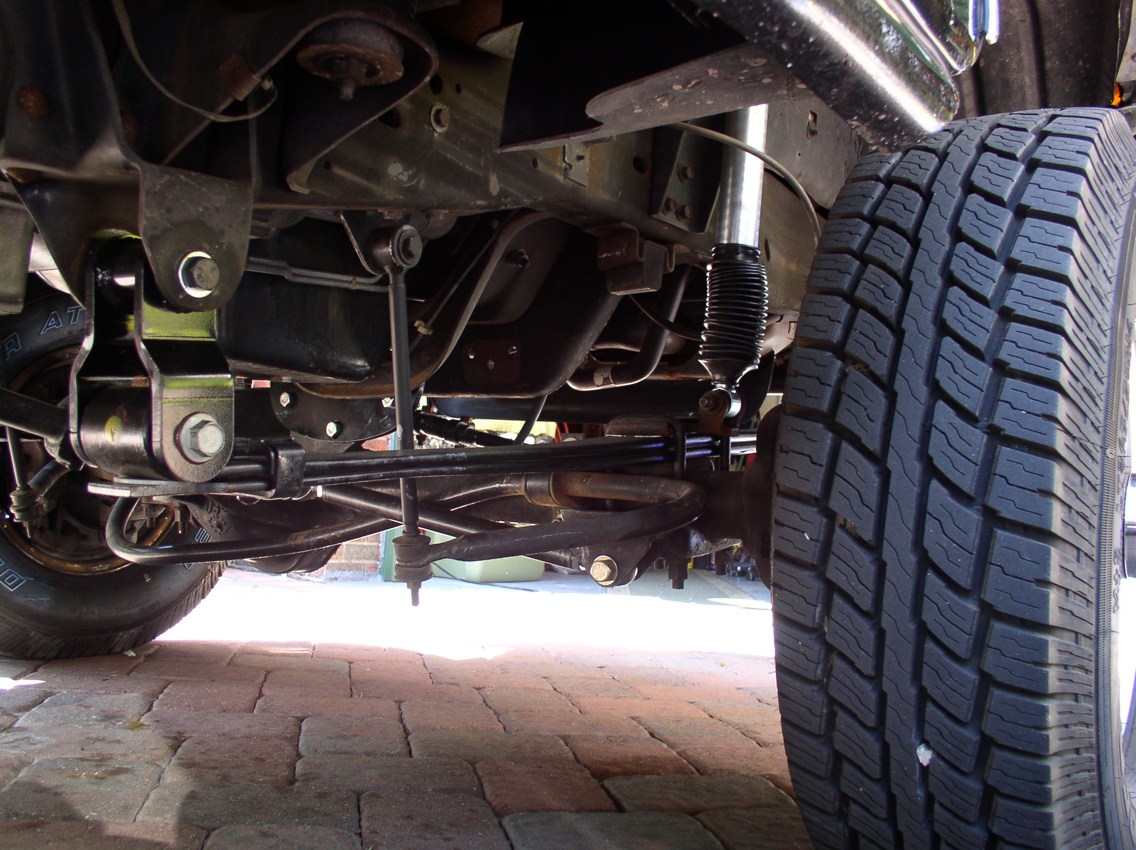

I've decided to keep the sway bar. I've got the Banks mounts for the 460 Powerpack kit. How do I best locate where to mount these on the frame rail?
Some trucks have the holes already in the frame while others don't. If they don't, like mine...I did the following. I installed the sway bar on the axle along with the sway link ends and frame brackets mounted to the sway bar. I held the sway bar up and marked my holes

gnxtc2, your picture is worth ten-thousand words, as far as spotting them sway bar brackets goes. I had read that there was no hole for them in the supercab trucks but either way I got what I need. Thanks man.
